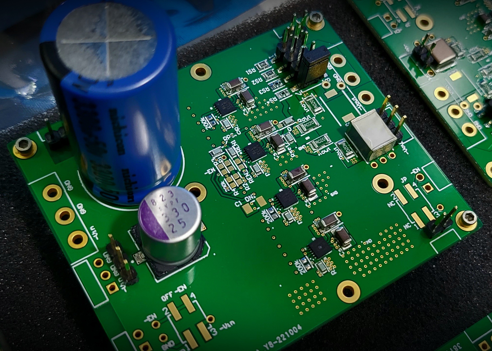

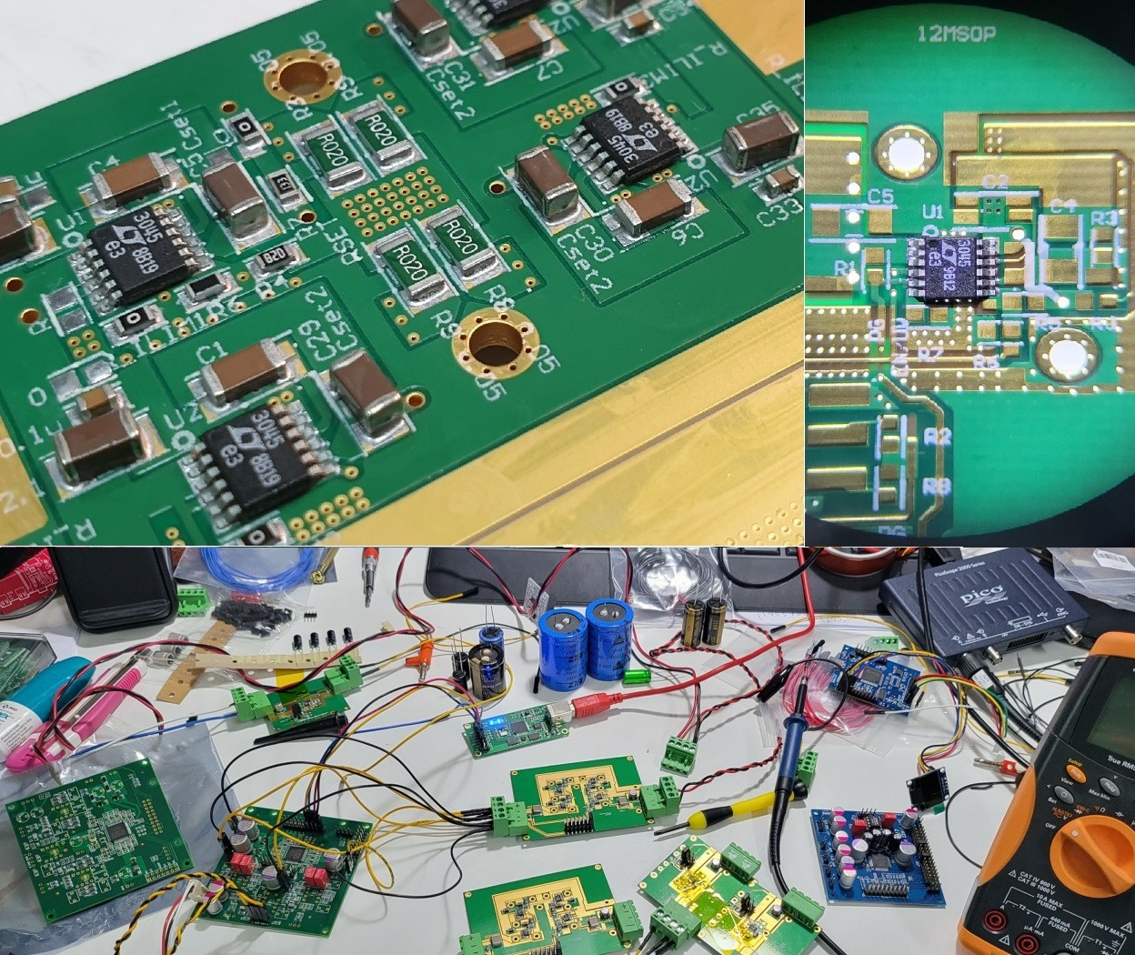

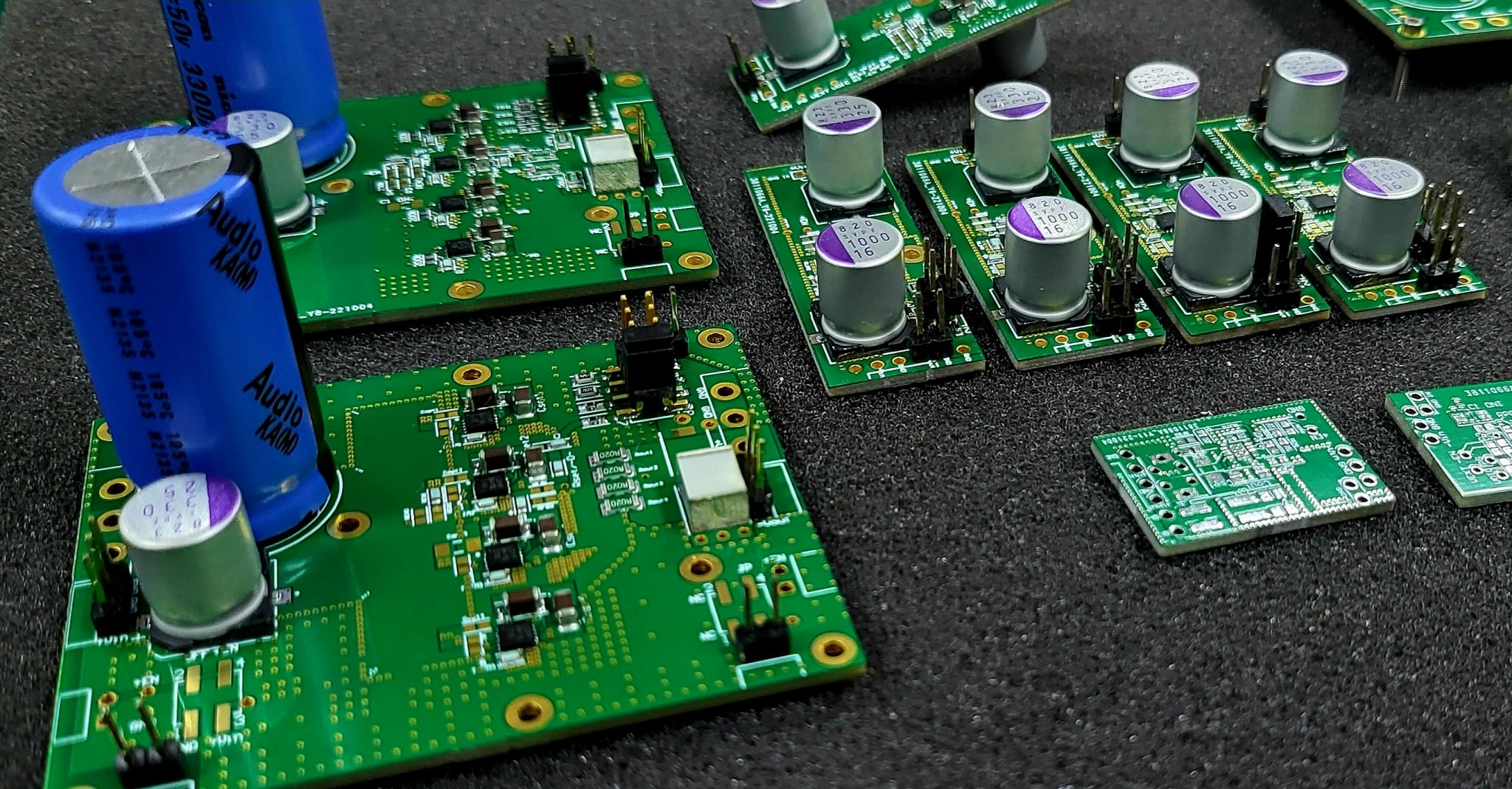

I can't read most of it, but I did see LT3045. The LT3045 is a very good regulator chip. Its reference is not particularly low noise, but its reference noise can be filtered off very effectively with one external capacitor. The buffer between the filtered reference and the output is quite good. See its datasheet for details.
Hi, any specific hint for input, baypass, output capacitor? For sense 100uf tantalum? I use tantalum polymer. Input output smd pps and pml or ceramic. Which value do you suggest What do you suggest for best analogue sound. I did not any impedance medurements, and you are welcome with your results. Thank you.

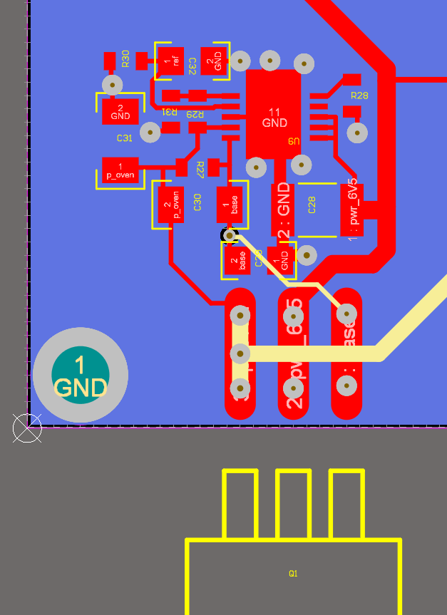

That is a LT3042 with a NPN for larger currents. The circuit is in the data sheet.
Noise is more or less the same as a 3042 without thermal help.
capacitors are X7R ceramic here. Sorry to burst that bubble. It does not take
elves who dance around it at midnight. There is no such thing as the
delicate sound of DC. (The Delicate Sound Of Thunder is OK.)
My regulators feed microwave oscillators where every fault is magnified
a million times.

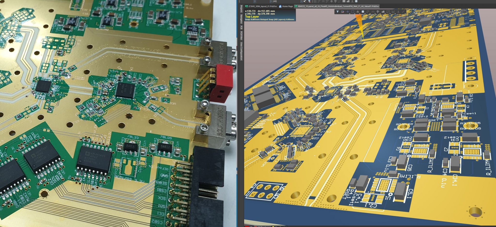

The pic below is an alterative layout on 4 layers.
Gerhard
