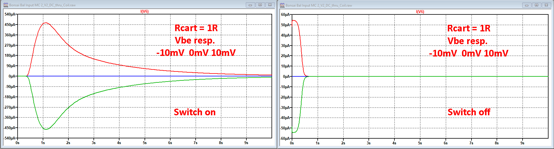

I get a 450mA pulse through the Cart at switch on when using a 1R Cart, resp. a 20mA pulse for a 10R Cart.
Pulse is very short, but wouldn't it be better when this could be eliminated?

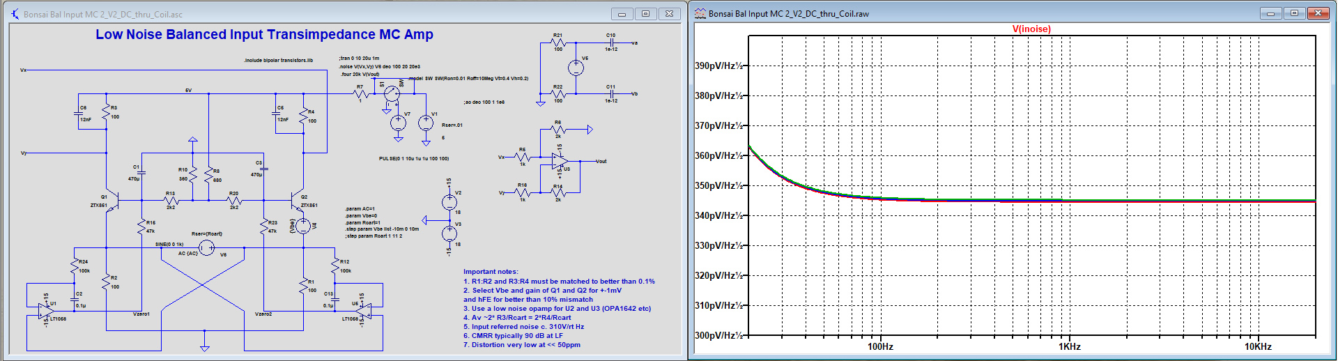

Here is what I made of it.
I always favour symmetrical designs, that's why I added a second servo.
A number of component were discarded, so in total component count hasn't increased.
I made a central base voltage reference, making the circuit independant of Hfe differences.
In this case Ic is 9.35mA, but can be easily adjusted.
Theoretical noise is sqrt ((2*Rbb + 2*1/2Gm + Rcart)/59.2)nV/rtHz
For Rbb=1.5R and Rcart=1R this calculates to 336nV/rtHz.
In the simulation I get 345nV/rtHz independent of Vbe differences, only 0.2dB off.

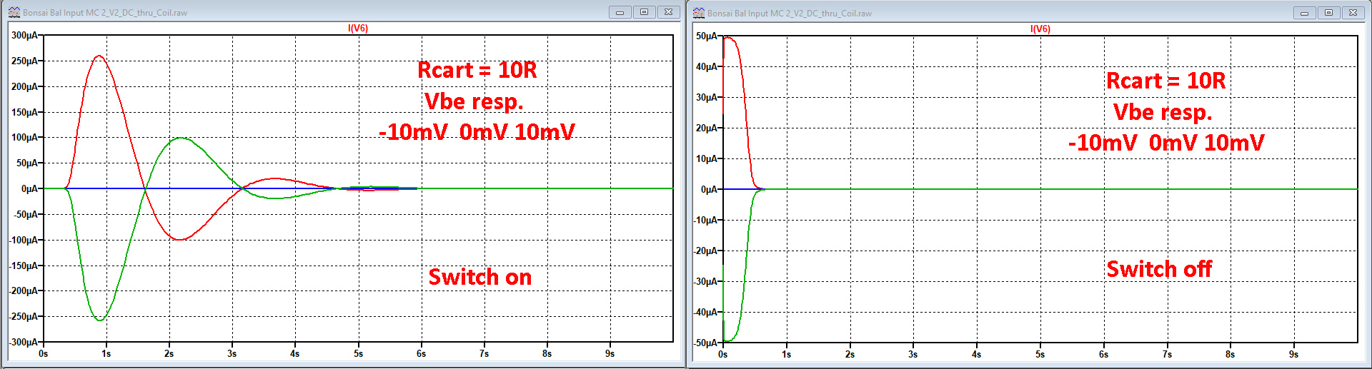

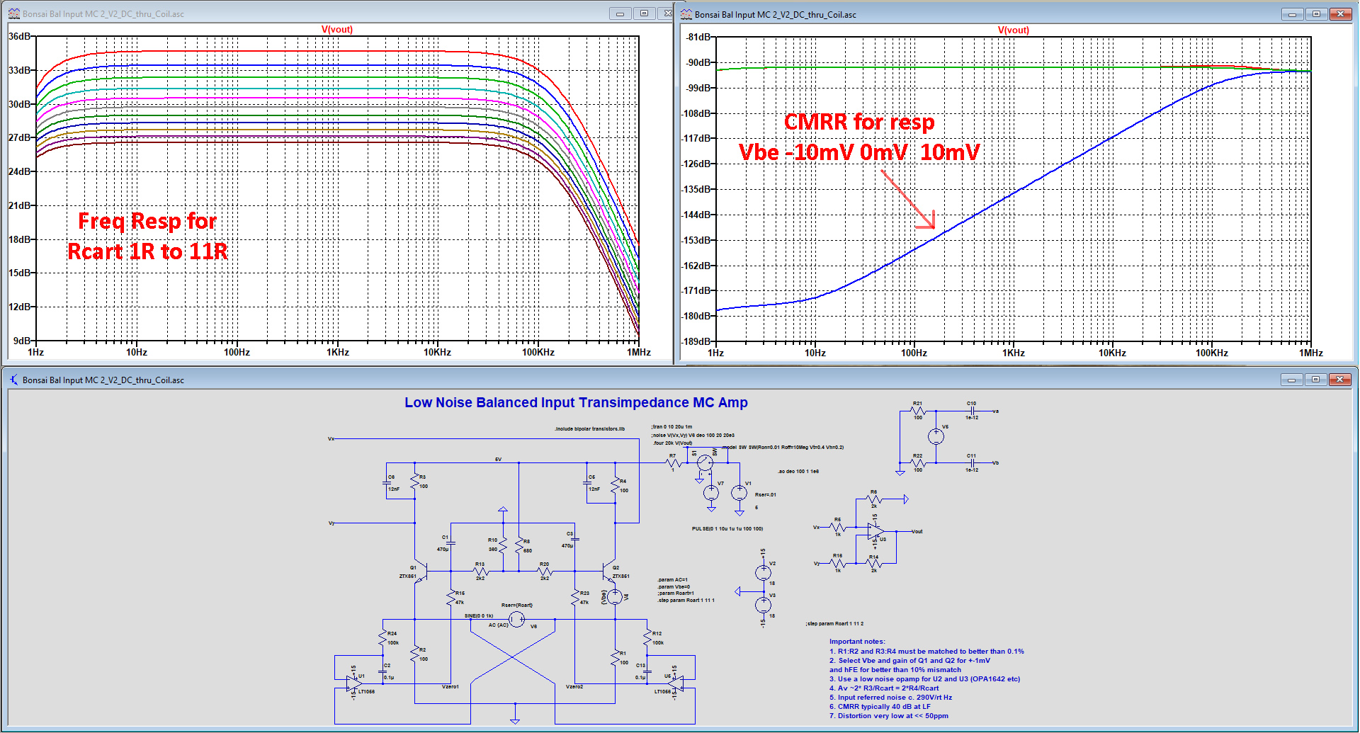

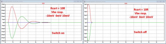

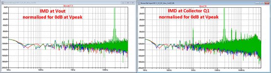

The images below are showing resp:
Freq Range and CMRR, Noise, and on-off response for resp. Rcart is 1R and 10R.
Not shown in what happens as a spike at switch on, that was previously in the hundreds of mA but now not exeeding 30uA for what it's worth.

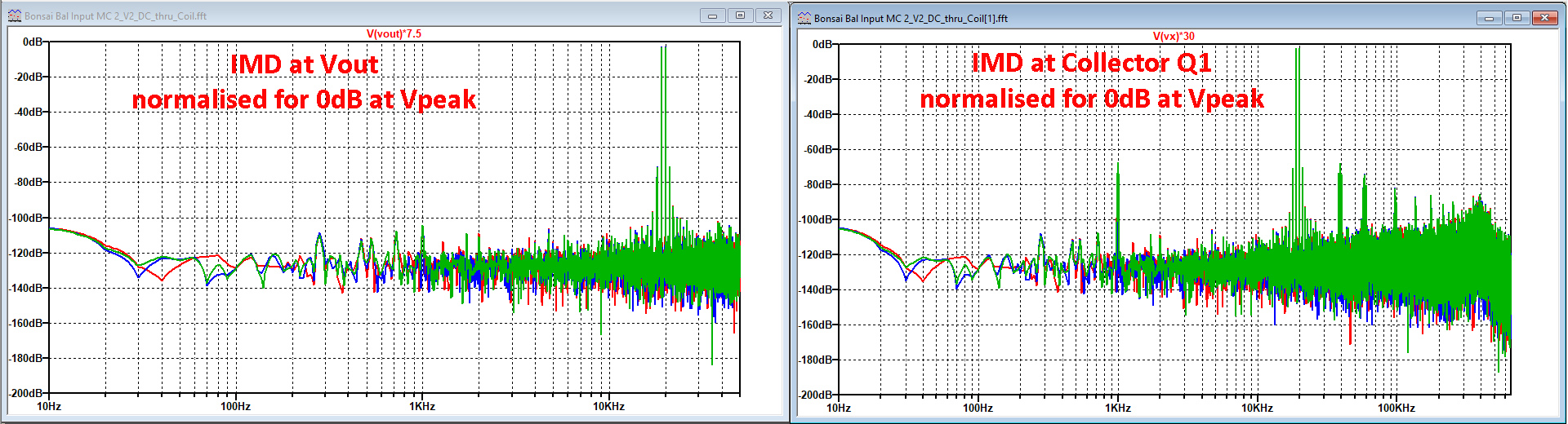

In the last image IMD is shown at the output for 19+20Khz at 2.5mV each, giving Vpeak = 5mV for Rcart = 1R.
Images are normalised to 5mV = 0dBr.
Quite obvious is that the 1Khz distortion product, visible in the collector of Q1 is no longer visible in Vout , because this 1Khz component has opposite polarity between Q1 and Q2 and cancel each other.
Visible is that the servos are perfectly doing their job, resulting in the same IMD for the used three Vbe differences of -10mV, 0mv and +10mV.

Do you think the CMRR is realistic? Any differences in gm will affect this surely, because re' will be different. The problem will be worse at low Rcart resistances. Is the balanced to single ended circuit presenting the same load on the collector loads?

Cmrr of -90dB measured in the image for Rcart=1R, will be in real life a bit worse, somewhere between 60 and 80dB depending on the accuracy of the used resistors, just play with the model and also create two ZTX transistors with slightly different Hfe parameters to get a feeling for sensitivity.
And yes the load on both collectors is the same.
Because the servo’s will keep the emitter voltages the same, Gm for both transistors will be the same.
If not, it would have been evident in the IMD test where the slightest Gm difference will let the 1Khz component pop up, which is not the case.

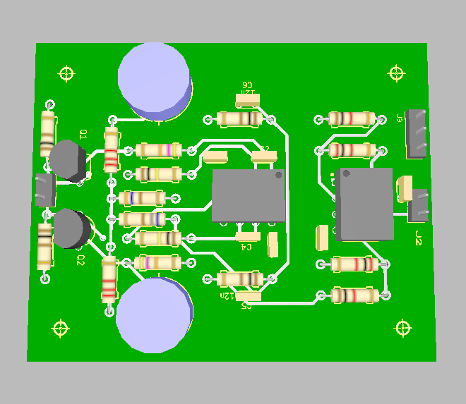

I’ll start laying a board out tomorrow and put the Gerbers up here.
For the +5 V supply you just divide the 18 V down and filter and buffer it with an LM4562 - same as X-Altra MC/MM

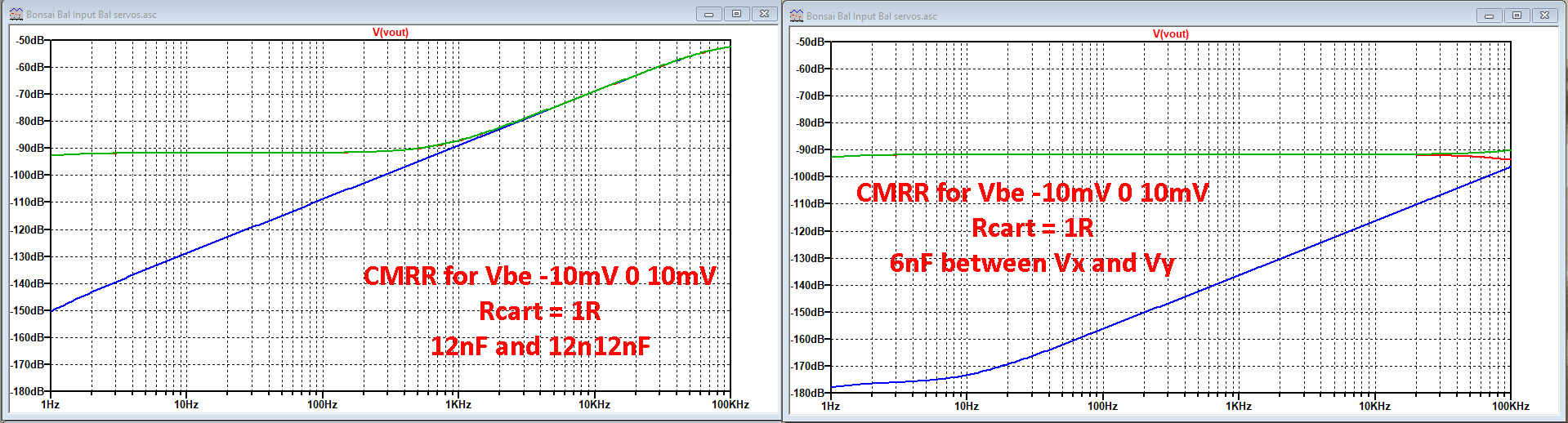

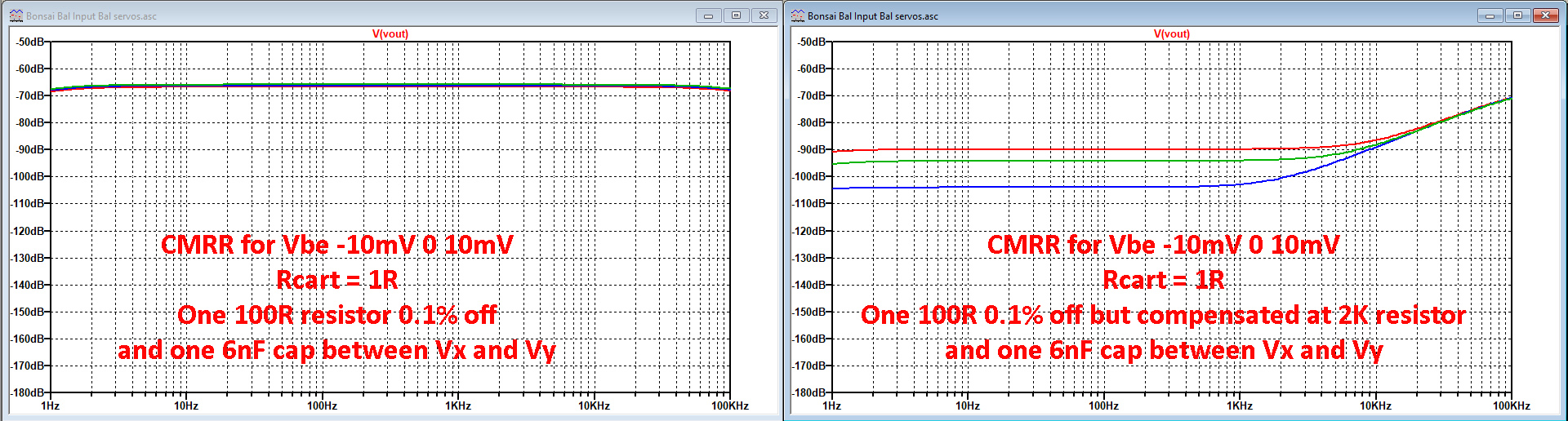

Further on the subject of CMRR and sensitivity on component matching.
Two 12nF caps are used to restrict the BW to 130Khz.
They would need a very high match to keep CMRR intact.
See first image below when using 1% caps.
When however replacing both caps by just one 6nF cap between Vx and Vy, FR stays the same without any matching at all and saving one cap.
When using 0.1% resistors, CMRR drops to -60dB, see second image.
This could be compensated to some degree with a small 20R pot in the 2K//390K resistor going to Gnd from the level shifting op-amp.

Agree - the differential filter across Vx and Vy is a far better solution.
I think 60 dB is a good practical limit, but you can also always select (see Mark Johnson’s thread on this for example - a 0.05% match seems quite feasible in most cases from a 1% tolerance batch.
I am proposing to use 1206 SMD on the board.
