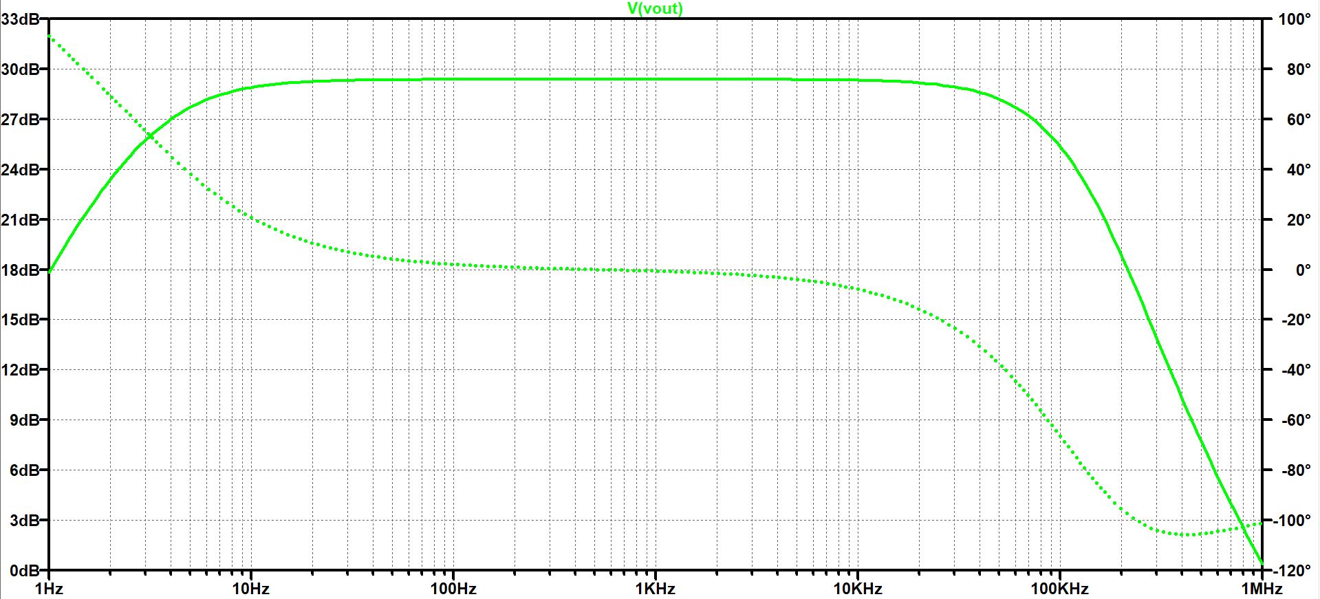

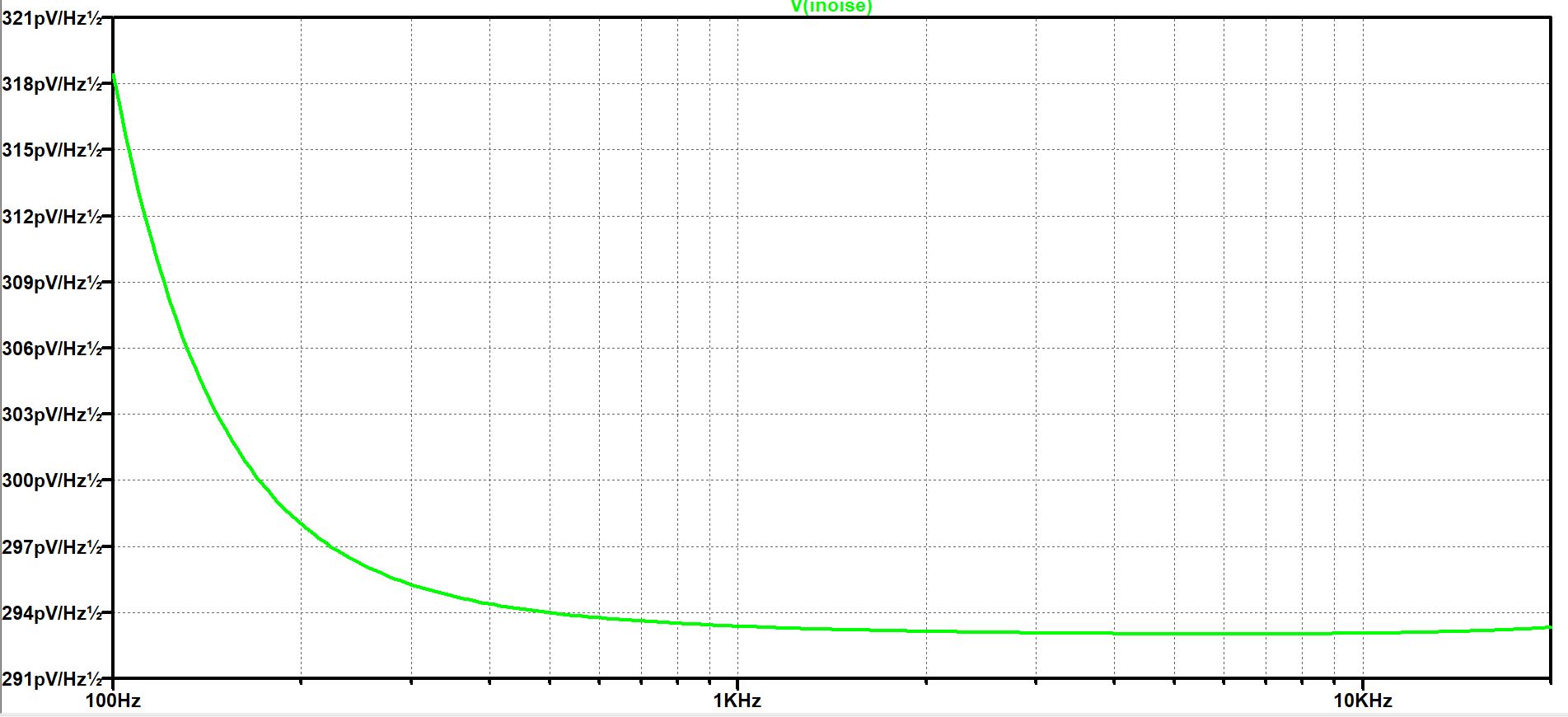

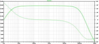

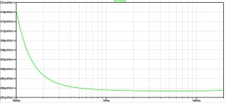

Attached are the latest set of whole signal chain measurements on the TranBal. The 220 Ohm resistor across the 300 Ohm collector load resistors has been removed, raising the TIS front end gain from 6 to 22 with a 22 Ohm source resistor.
Previously, the noise of just the TIS stage only was sim'd at 295 pV.
The sim results below for the whole signal chain now show the 0.1Ohm Rcart RTI noise at 300pV/rt Hz - so just 5 pV more than the TIS stage noise on its own mentioned above. The noise measured on the QA401 shows 455pV - so a difference between sim and measurement of c. 155pV
For the 22.1 Ohm Rcart, the sim noise of the amplifier only is 510pV/rt Hz. The measured noise for the whole signal chain was -120dBV and the total gain 1550 so the RTI measured noise is 645pV.
Given the uncertainties of the system gain at high levels and the actual input resistance with the inputs shorted, it is not easy to get much more accurate results IMV for example a 100 milliOhm higher source resistance at the front end of the amp will make a significant change in the total system gain with a nominal 0.1 Ohm source input resistance. The QA401 readings are not better than to within +-1 dB at -120 dBV.
As already discussed earlier in the thread, there are probably other secondary noise sources (cap leakage etc), but for a fully balanced input stage, the measured noise performance is very good for a 1st cut design like this.

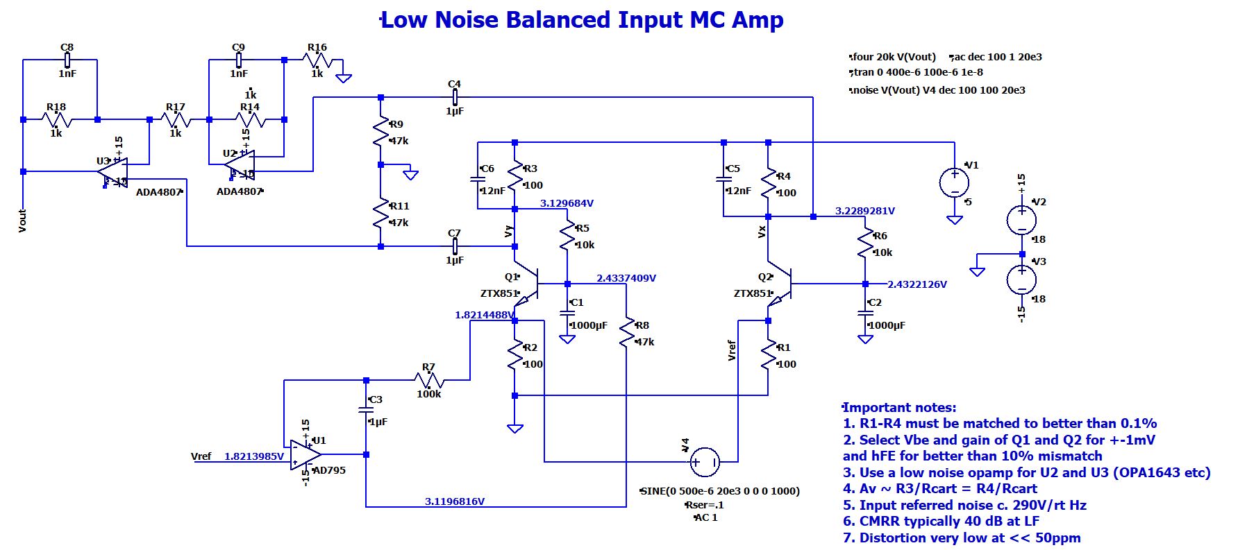

Here is the sim I am using to get the above noise figures.
I will email Matt at QuantAssylum later today to discuss the results vs sim - he may have some additional insights on the QA401 side that could explain the difference between sim and measured result (I get 3 dB difference at 0.1 Rcart and about 2.2 dB at Rcart = 22.1 Ohms between sim and measurement)
Your collector current is still wrong with 2.1Volt, this should be 2.5Volt to get the ca. 16.5mA Ic that you confirmed earlier !!
I ran your model unchanged, apart from the 2.5Volt correction, with 0.1R and 22R.
I simmed as well at the diff output and at Vout1
1) 0.1R
This gave 281pVrtHz@1hz RTI from the Diff output and 284pV/rtHz@1Khz as from Vout1, showing that a large gain in the first stage keeps the RTI noise intact,
At the same time Gain diff = 48,9nV/281pV = 174 and gain overall is 3.4u/284p = 11,971 both at 1Khz.
Your QA401 should show 20*log(3.4uV)=-109dBV@1Khz
2) 22R
Here the sim gave 726pV/rtHz RTO from the diff output and 780pV/rtHz from Vout1, an increase in RTI of only 0.6dB, quite good.
Gain diff is 16.8nV/726pV = 23,1 and gain overall is 1.24uV/780pV = 1590 again both at 1Khz.
Your QA401 should show 20*log(1.24uV) = -118dBV.@1Khz.
Taking out the 22R out of the 780pV/rtHz@1Khz RTI as seen from Vout1 gives sqrt(780^2-610^2) = 486pV/rtHz RTI.
Making the same calculation from the diff output gives sqrt(728^2-610^2) = 397pV/.rtHz@1Khz
The difference between the 486pV and 397pV is caused by the relatively low gain of 23.1 of the diff stage, but compared to the 610pV/rtHz from the 22R it is rather harmless.
3) So to conclude, could you tell what readings your QA401 is giving with 0.1R and 22R at 1Khz, and how close this is to -109dBV and -118dBV for rep 0.1R and 22R.
Hans
