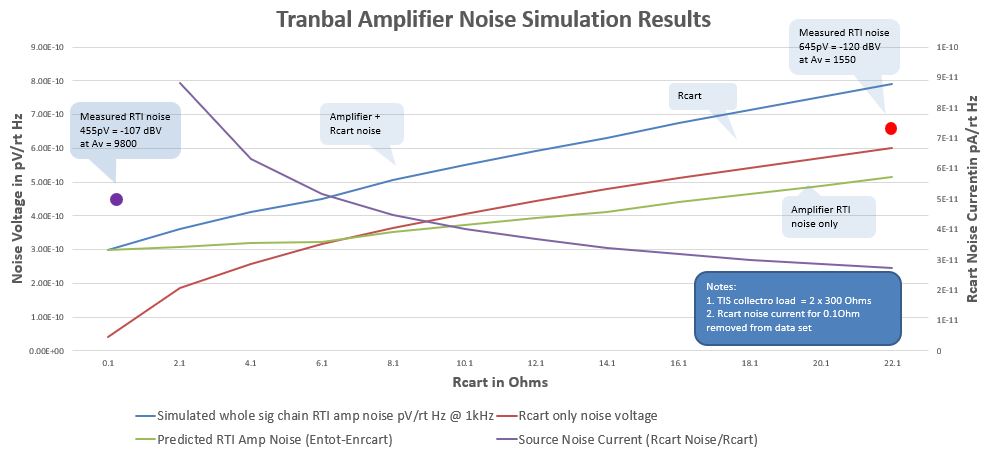

Attached are the latest set of whole signal chain measurements on the TranBal. The 220 Ohm resistor across the 300 Ohm collector load resistors has been removed, raising the TIS front end gain from 6 to 22 with a 22 Ohm source resistor.
Previously, the noise of just the TIS stage only was sim'd at 295 pV.
The sim results below for the whole signal chain now show the 0.1Ohm Rcart RTI noise at 300pV/rt Hz - so just 5 pV more than the TIS stage noise on its own mentioned above. The noise measured on the QA401 shows 455pV - so a difference between sim and measurement of c. 155pV
For the 22.1 Ohm Rcart, the sim noise of the amplifier only is 510pV/rt Hz. The measured noise for the whole signal chain was -120dBV and the total gain 1550 so the RTI measured noise is 645pV.
Given the uncertainties of the system gain at high levels and the actual input resistance with the inputs shorted, it is not easy to get much more accurate results IMV for example a 100 milliOhm higher source resistance at the front end of the amp will make a significant change in the total system gain with a nominal 0.1 Ohm source input resistance. The QA401 readings are not better than to within +-1 dB at -120 dBV.
As already discussed earlier in the thread, there are probably other secondary noise sources (cap leakage etc), but for a fully balanced input stage, the measured noise performance is very good for a 1st cut design like this.

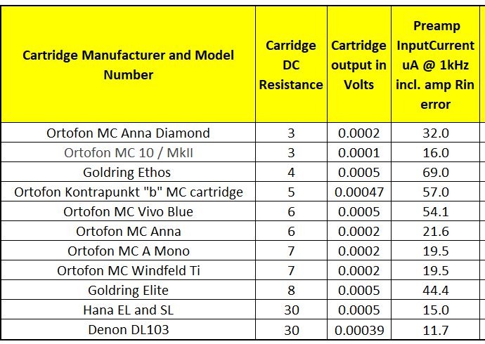

Hans, separate question. If I have two cartridges that give 200uV out, but one has an internal resistance of 3 Ohms and the other 5 Ohms, how do we treat this in a TIS stage?
For a voltage input amplifier, the gain will simply be Vout/Vin.
Well, just follow the math as given in my posting.
Gain is Rfb/Ri with RfB 2*300//220 = 161R and Ri is Rcart+2*1.Gm, resp 3+3.2 = 6.2 and 5+3.2 = 8.2 giving a gain of resp 161/6.2 = 26.0 and 161/8.2 = 19.6

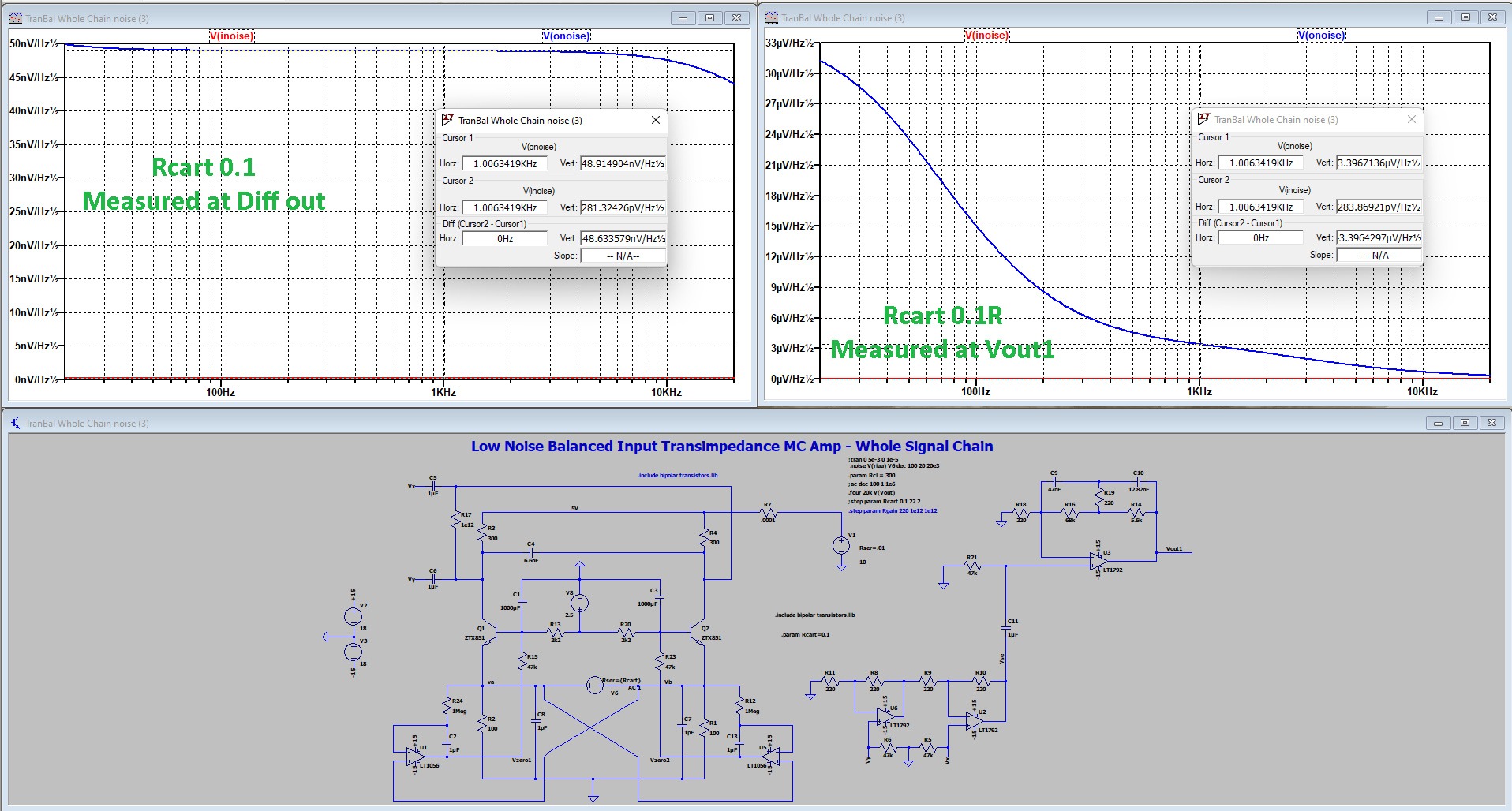

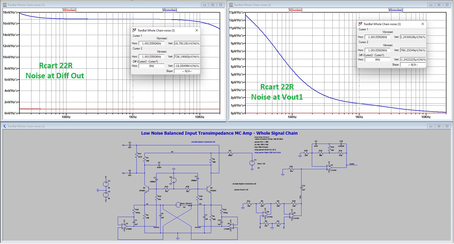

Your collector current is still wrong with 2.1Volt, this should be 2.5Volt to get the ca. 16.5mA Ic that you confirmed earlier !!
I ran your model unchanged, apart from the 2.5Volt correction, with 0.1R and 22R.
I simmed as well at the diff output and at Vout1
1) 0.1R
This gave 281pVrtHz@1hz RTI from the Diff output and 284pV/rtHz@1Khz as from Vout1, showing that a large gain in the first stage keeps the RTI noise intact,
At the same time Gain diff = 48,9nV/281pV = 174 and gain overall is 3.4u/284p = 11,971 both at 1Khz.
Your QA401 should show 20*log(3.4uV)=-109dBV@1Khz
2) 22R
Here the sim gave 726pV/rtHz RTO from the diff output and 780pV/rtHz from Vout1, an increase in RTI of only 0.6dB, quite good.
Gain diff is 16.8nV/726pV = 23,1 and gain overall is 1.24uV/780pV = 1590 again both at 1Khz.
Your QA401 should show 20*log(1.24uV) = -118dBV.@1Khz.
Taking out the 22R out of the 780pV/rtHz@1Khz RTI as seen from Vout1 gives sqrt(780^2-610^2) = 486pV/rtHz RTI.
Making the same calculation from the diff output gives sqrt(728^2-610^2) = 397pV/.rtHz@1Khz
The difference between the 486pV and 397pV is caused by the relatively low gain of 23.1 of the diff stage, but compared to the 610pV/rtHz from the 22R it is rather harmless.
3) So to conclude, could you tell what readings your QA401 is giving with 0.1R and 22R at 1Khz, and how close this is to -109dBV and -118dBV for rep 0.1R and 22R.

Agree the model emitter current was not correct - 13mA vs 16.5mA target. The preamp has the correct current - I just remeasured voltage across the 100 Ohm emitter resistors at 1.65V = 16.5mA
With the input shorted the reading is -108.5 dB and at 22 Ohms the reading is -117.4 dB. You can say both these readings are +-0.2dB because of the display grass.
Please note, there is a +-1 dB difference in the readings from day to day - I guess this is related to drift or thermal issues since they will have an effect at these very low signal levels.
So there we are, your QA401 readings are ca. 0.5 above the sim.
That’s what corresponds with my sim versus measurement experience.
You now have an LTSpice model that can be used to find the optimal gain settings for the three stages.
