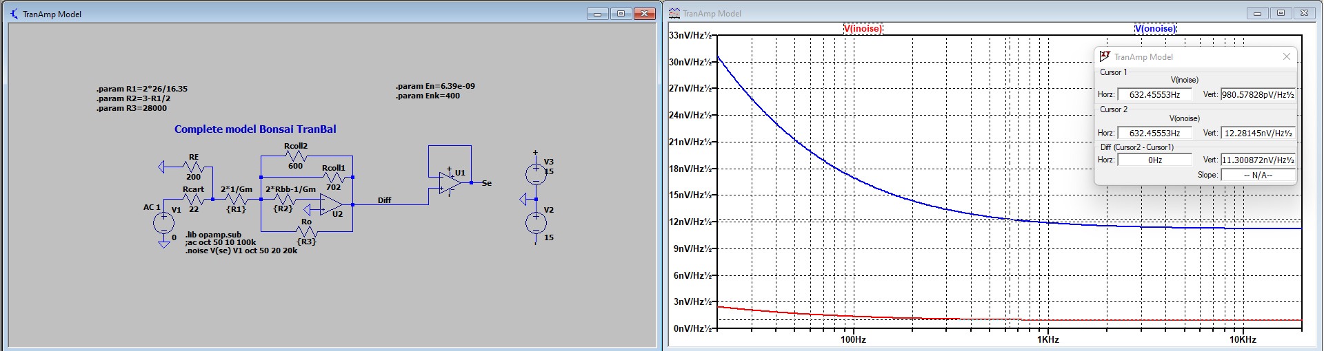

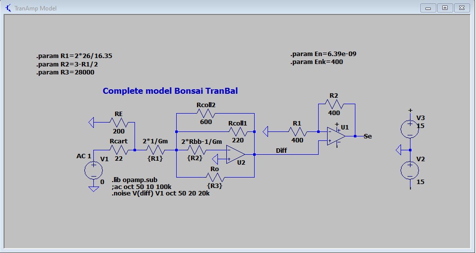

See diagram below that very accurately conforms to your model, in this case for Ic=16.35mA
Measured at the Diff output, noise RTI is 758pV/rtHz@1Khz with a 6.27 gain.
And behind the Diff to Se converter, noise is 1.53nV/rtHz@1Khz, 100% more.
So this combination of gain settings is not very rewarding from a noise point of view.
Much better would have been a bigger gain in the diff stage followed by attenuation instead of gain in the Diff to Se stage.
When replacing the 220R collector resistor by a 702R resistor and giving the Diff to SE converter a gain of 1 instead of 2 to, keeps the overall gain identical but let de noise RTI as measured behind the Se converter drop from 1.53nV/rtHz to 980pV/rtHz !
Hans

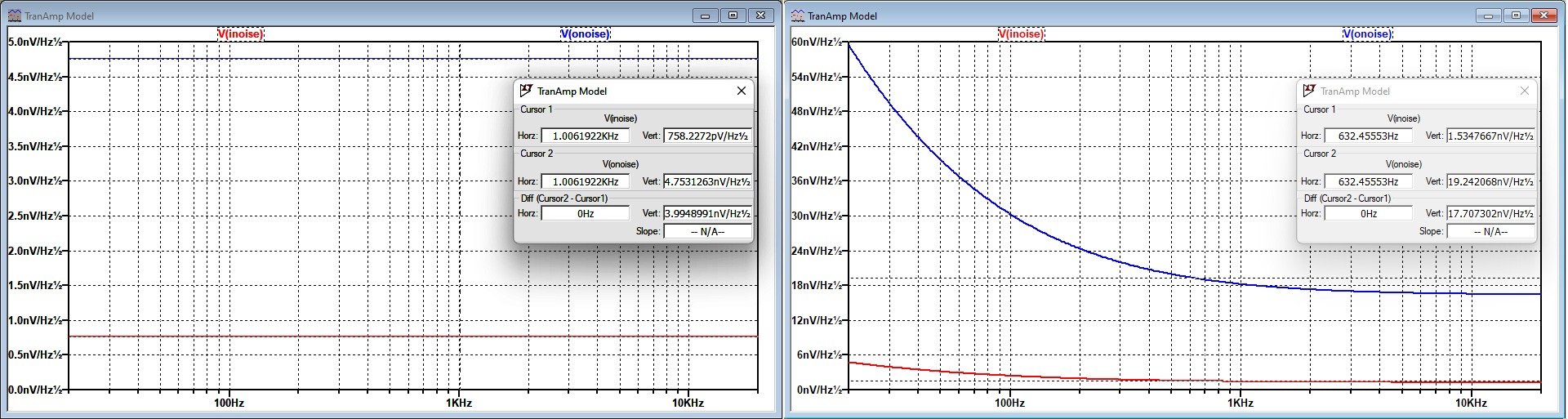

Here are the noise figures with Rcart is 1mR, resulting in 279pV/rtHz RTI as seen from the diff output, even below the 293pVrtHz that you calculated.This is just not correct Syn08. My calculation and methodology have been absolutely clear - just go through the posts above and the graphic I posted up showing how I did it. The circuit is published in this thread - quite open and anyone can look at it.

You cannot simply subtract the 22R noise from the RTI figure measured with this 22R, because the 2*100R emitter resistors parr to the Cart are contributing substantially with Rcart is 22R and not at all with Rcart is 1mR, see my model.
Everybody has its favorite way of calculating noise, but IMO my model is the most accurate once set, and gives the best view of control.
When calculating from voltage to current and backwards you can lose overview rapidly, without getting any feedback.
Just my two cents.
Hans

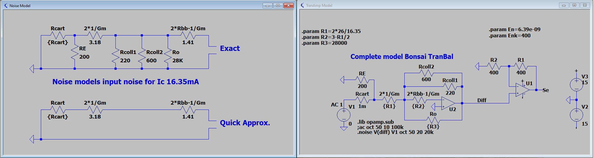

Syn08,
I agree that using LTSpice for noise calculations can be tricky and needs enough background know how.
But when the model is right, LTSpice does really a perfect job that conforms exactly to manual calculation.
See both models below, one is only composed of resistors and is 100% exact, with only Ro to be estimated, but not having a great impact.
That both models, active and passive give the same RTI may not be a surprise, but when calculating the Exact resistor model by hand, gives again the same noise figure.
So when you know what you are doing, LTSpice is quite helpful, other than calculating THD and IMD figures which mostly results in wishful thinking.
But when measuring the real thing you will never achieve these theoretical figures, so better as simmed is an utopia, but within +5% is what I mostly see.
Just recently I simmed the Wayne Kirkwood's preamp, sim versus measurement was again within +5%.
The other thing I agree is that calculating figures without having a reason doesn't make too much sense.
What does it bring when a bare Diff amp alone has an RTI below 300pV/rtHz when in later stages this noise is ruined.
Only when the goal is that at the point where the final output is produces, RTI should not be more then X% of the Diff amp's RTI alone, then it makes sense to look at the RTI.
When however RTI@1Khz as seen after the Riaa stage is way above the 1nV/rtHz, then in my opinion putting so much effort in a low noise diff amp is almost a waste of energy.
Hans

Are we all in agreement that with a 22 Ohm resistor across the TranBal inputs, the QA401 spot noise reading of -121 to -122 dBV is reality and the QA401 is not giving a bad answer?
Can we agree that with this info and the exact gains per stage, we can calculate accurately the total RTI noise (amp plus 22 Ohm resistor)?
Can we agree if we subtract the noise current of the 22 Ohm RMS style we get the total amp only input referred current noise and from this can state a notional noise voltage (yes, I am choosing my words carefully to avoid confusion)?
Finally, if that total noise after subtraction is then at or very close to the sim’d value of 292pV with the sim’d inputs shorted, it confirms the noise performance of the amplifier?
Optimising the signal chain gains for lower noise is a separate subject. We should not even attempt that without establishing the veracity of the measurement methodology.
Given that modelling a system and then measuring the resultant performance of a practical case is de riguer in many areas of science and engineering (aerospace, biology, electronics are a few examples), I fail to see what the fuss is about on my methodology. I’ve done exactly what is considered normal practice.
Rather than hurl insults or claim the TranBal does not meet spec, perhaps someone would calculate the noise on the input of the TIS given the model output of 11.5 nV. I have shown my calculations and reasoning - repeated 2 or 3 times above. Explain why it is wrong. I’ve made it clear why Syn08’s treatment is incorrect.
I really don’t want poison this thread with anymore bs. If we cannot have gentlemanly discussion, please leave the thread.
Hans, indeed Spice is excellent for determining the equivalent Johnson noise. It replaces the real part of any reactance with it's equivalent thermal noise source, then does the math. However, there are several noise mechanisms that are by default poorly or not at all included:
- Leakage current noises (such as in electrolytic capacitors)
- Excess noise. Excess noise models in passive components models are not included, while for active components they are crude and anyway expected in the device models.
- Noise corner frequencies, once again expected in the device models, which rarely include them.
- Large signal noise injection mechanisms are not included, all noise models are considered linear, and linear analysis is used to determine the noise budget.
