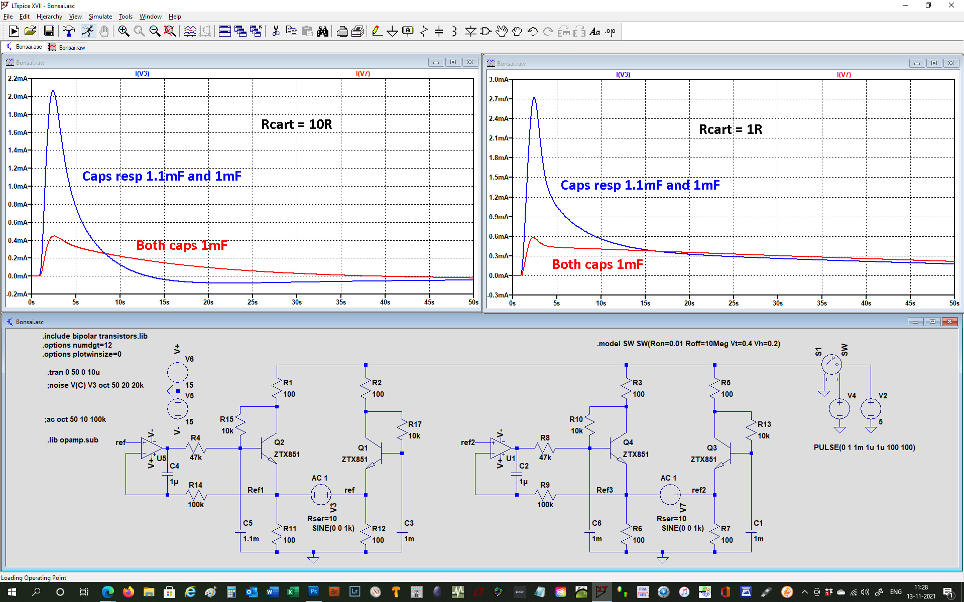

In the meantime some info's that might be helpful to show that switch on has to be taken care off.
Two sims below showing what current flows through the Cart at switch on for resp. a 10R and a 1R cart.,
Slight 10% tolerances between the two 1mF caps already shows a high sensitivity.
These sims were done with two exactly equal ZTX851's, which make the results even more optimistic.
So work in progress, but I have all the faith in a good solution.
Hans

That looks very encouraging. I’m wondering if a resistor from the base to 0V on each transistor also won’t help to better define the tranny operating conditions once the circuit has stabilized.
I think a good cart start up current objective is about the same as the peak signal current - so a common figure would be 30-40 uA. .
A transistor shorting both bases to gnd is an idea, but the circuit is highly dependent on hfe and hfe differences, to be solved first of all IMO.
Hans

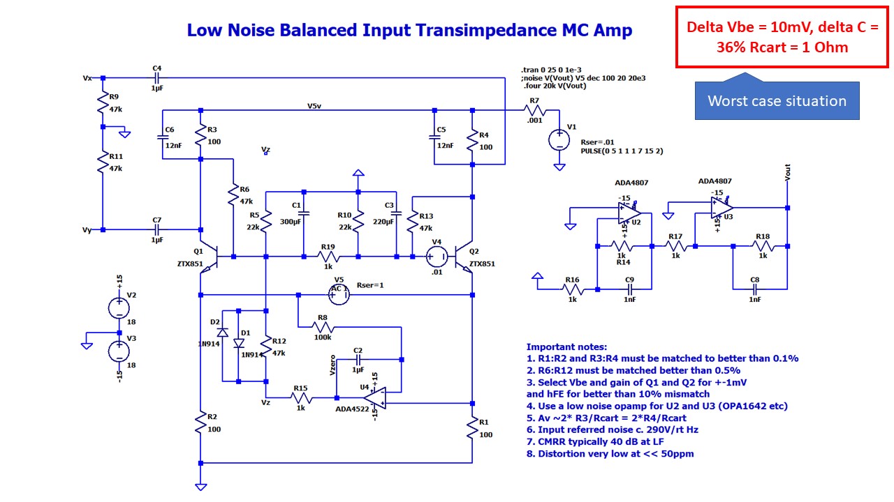

Some more work today on the balanced transimpedance head amp.
I found a way to minimize the effect of the separate base decoupling caps. Basically they don't need to be completely separate. The two bases are now coupled by a 1k resistor which helps to deal with gross differences in capacitance that was one of the problems on the original concept that lead to high currents through the cartridge.
This has allowed the servo amp to be easily configured so that it takes care of start up currents and servos out any differences in the transistor Vbe's. If this becomes a practical design, ideally you would need to select for delta Vbe = 1mV or less and hFE to within 10% (see mediatechnology's post in this regard in Jurgen's mpp thread - it seems quite easy to do). However the sim was done with a delta Vbe of 10 mV and high cartridge current is easily servo'd out. See the next post.

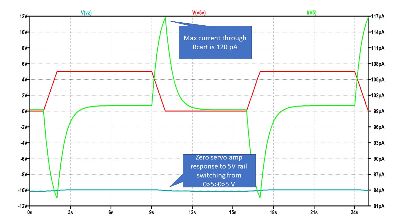

Here are the cartridge currents with the +5V supply (V5v) switched on and off - it is negligible at ~120 pA. I used rise/fall times of 1 second for the +5V supply since in a practical design the +5V would simply be derived from the main +18V supply through a divider and heavily filtered at the output. (I used 47 Ohms and 1000uF on the X-Altra MC/MM with an LM4562 and got 7nV integrated noise 20-20kHz)
