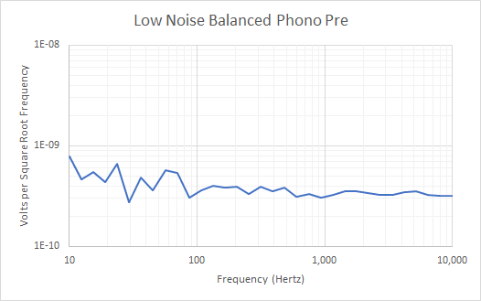

I used the setup described in the Texas Instruments application note, grounded the emitters (each separately) via 1,000 uF Nicchicon Muse caps. (I read some papers on balanced amplifier measurements, but they mostly deal with microwave). Used AD8512 for the servos:
Jack, If I am reading your graph correctly the 1kHz spot noise is 200pV/rt Hz or approx 30nV RMS wide band which seems about 90pV/rt Hz too low - ie too good.
If you just short the inputs to ground with caps but leave nothing connected across the +- inputs, the gain of the front end is effectively 1 differentially.
I think a more realistic way to look at this will be to connect a 3.3 Ohm MF R across the inputs using the gain as 2*(Rcollector/Rsource+re') where re' = .026/Ie for the front end gain gain and get an output reading. Then calculate the thermal noise of the 3.3 Ohm R and subtract it - what you are left with is the amplifier thermal noise only.
Are you using a bal>unbal amp at the output? if yes, you will also have to factor that gain in as well.

The graph reads 300pV/rtHz instead of 200 at 1Khz.
Hans
Connect a 3.3ohm, then a 33ohm, then a 100 ohm and see if the results are consistent (Gain decreases, source noise increases, etc...)
What makes me a little suspicious is the total absence of any mains frequency and harmonic components. Not even a mumetal double shielding can't completely avoid these, unless the lab is in the middle of Mato Grosso,
The so-called sanity test. I used it to check my math with Sam's excellent 1000x LNA (as the doctor ordered) -- QuanTech recommended the same. Quan-Tech has gone to a better home.
One can select the output impedance of the AP analyzer such that the parallel impedance of the source does not materially affect the analysis.
"unless in the middle of Mato Grasso" or in Blaricum in the Netherlands for that matter.

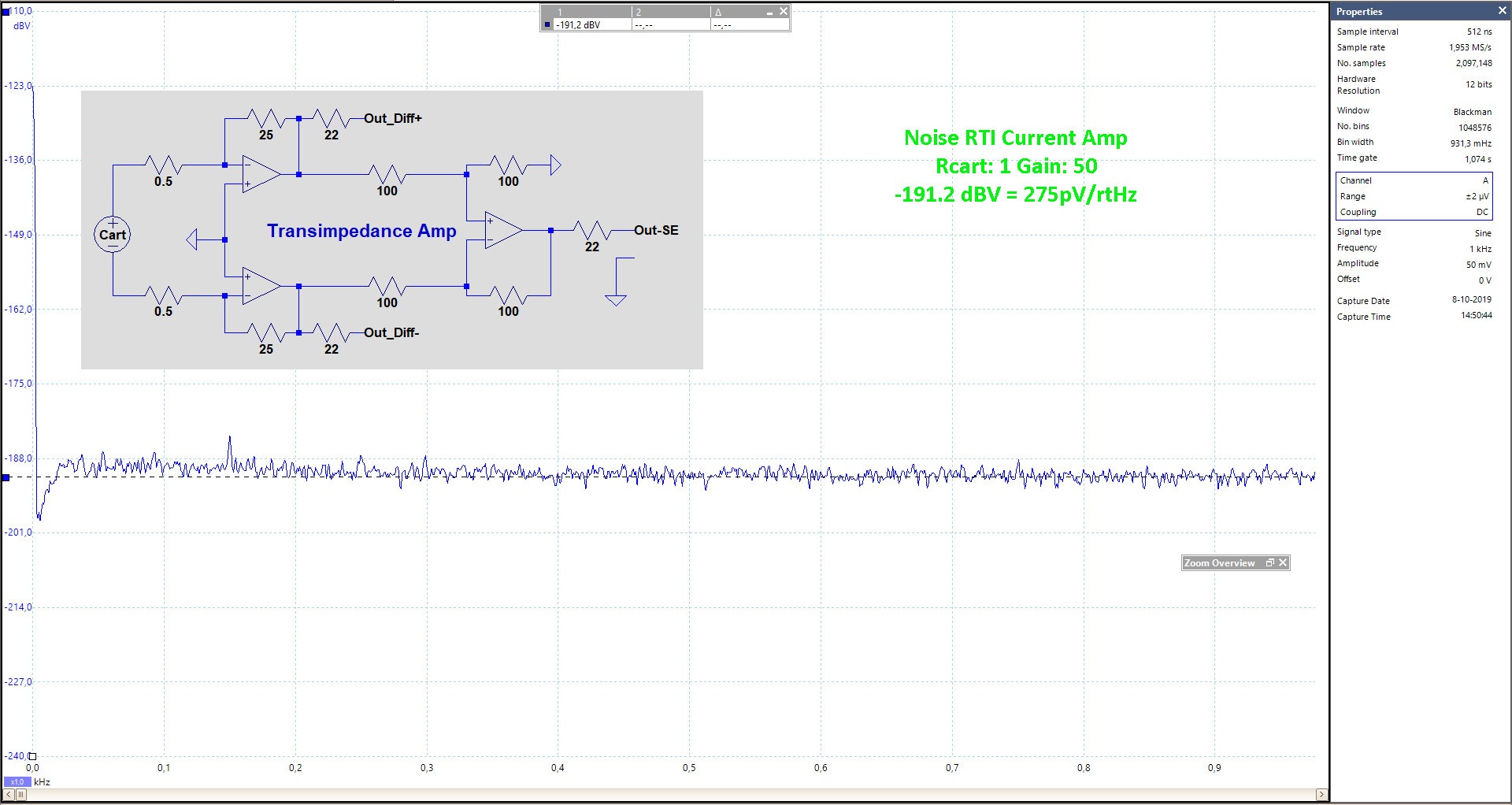

Repeatedly when measuring just on the top of my desk, I have no 50Hz anomalies, without any shielding with cans in cans, but always battery fed, see one example in the attachment for a current amp.
I had to think twice when I read that Jack had placed large caps par. to the emitter resistors, but this seems like a smart way of avoiding to measure with a simulated Cart resistance and then recalculate what the bare amp noise will be without Cart like you suggest with 3.3R and 33R , thereby assuming that current noise with these low resistances is insignificantly contributing to the noise production.
Looking at the noise replacement circuit in the attachment, it becomes clear that paralleling a large Cap to RE will give a direct and immediate result, without having to calculate anything, quite clever indeed IMO.
Hans
Just to explain, this is not an FFT, but an analog analyzer with a 5th order bandpass filter. Divide by the filter factor -- as described by Jung in his 1995 articles "Regulators for High Performance Audio". Connections are to the balanced inputs of the analyzer via very short length of either RG174 or shielded twisted pair. I use the Costco Christmas Cookie tins!
