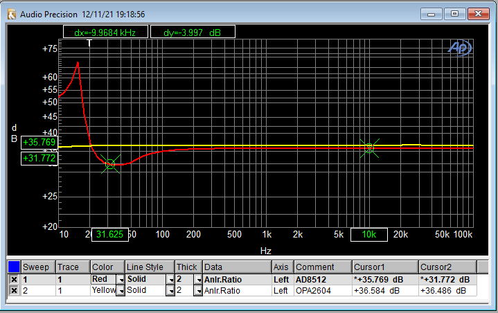

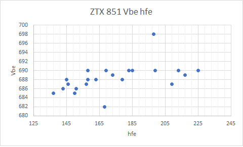

Yes - just looked at the Vos on that one - +-1mV typical, +- 5mV max - about 100x-200x higher than the 2188. If you're showing +-3.4mV you can bet the servo is working. What you could try is to put two very mismatched ZTX851's in and see if you get the same offset just to confirm its all ok.
OPA2188 is a chopper op amp; I would not use a chopper op amp in a low noise head amp, even as a servo. But then I don't know, it may work without any noise impact.Hmmm. What are you using for the servo amps? The OPA2188 spec a few uV offset at worst.
With the AD8512 there is more than a tenfold improvement.OPA2188 is a chopper op amp; I would not use a chopper op amp in a low noise head amp, even as a servo. But then I don't know, it may work without any noise impact.

Syn08 I used the OPA2188 in the X-Altra MC input offset servo- that measures at 232pV/rt Hz and is in very close agreement with the sim. The opamp is driving the control point with a massive very low <<<1Hz cut off filter so I think it’s ok. The noise specs on these new chopper amps are superb compared to the old devices that used external caps from the late 80’s

I didn't measure the delta between emitters with a bench meter, only my Fluke. Nonetheless, it was in the low hundreds of micro-Volts.

Ignore my post here. I reread your original post Jack and see what you were doing. Quick question though, are you running the opamps off single low voltage supply or at +-15V?Jack so yellow is one channel with one kind of opamp in the servo position and yellow the other channel or is the yellow the ref and the red trace one chan of the MC amp?
