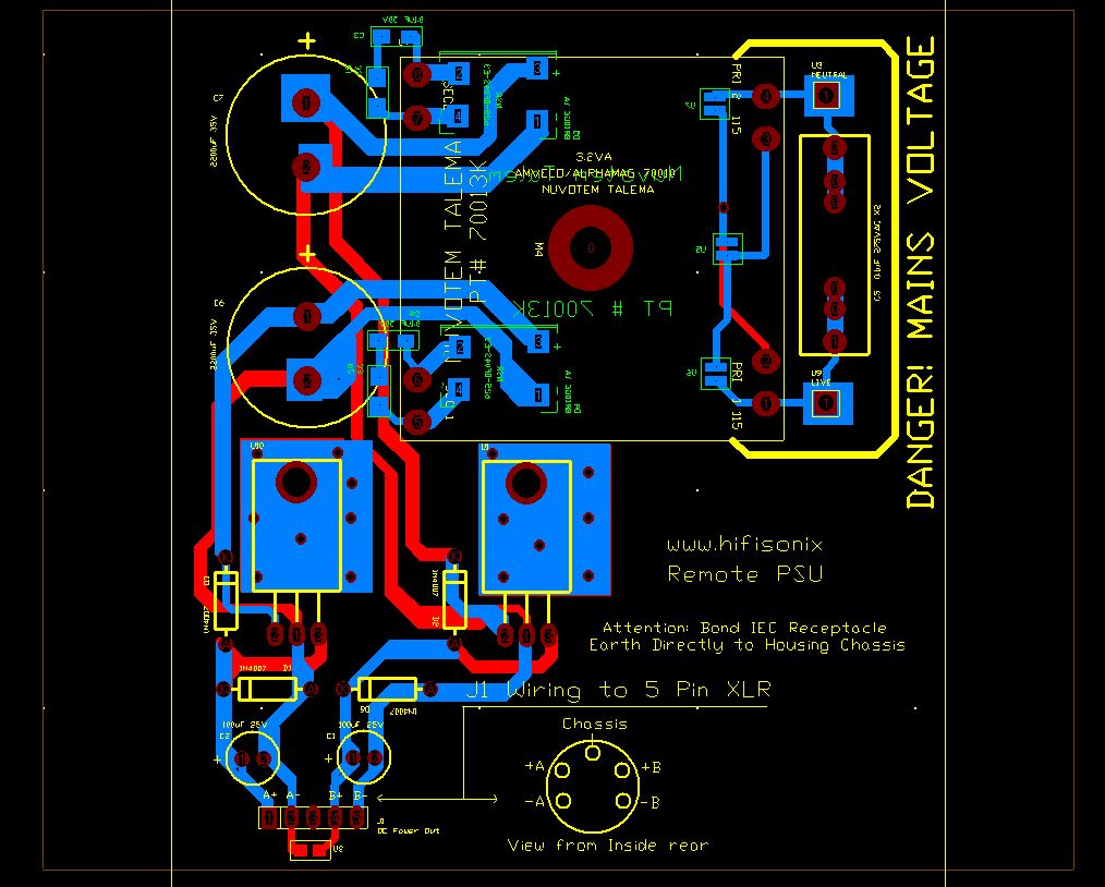

Here is the PCB so far - still some more refining to do but nearly there. board is 160mm x 110mm.
Remote +-15V PSU is also finished. After that the rear panel will be done for those that want to use a Modushop housing (through the rear panel away and use the PCB rear panel - same as X-Altra).

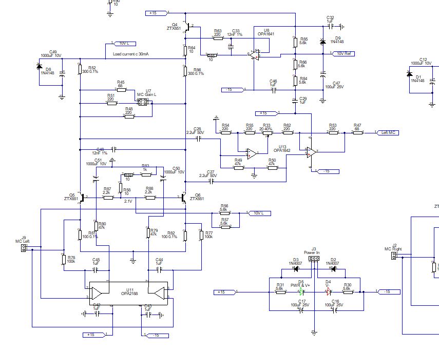

Bonsai,
I think something slipped through your mind.
Not a serious problem because it just concerns the values of a few resistors.
In your original design you had separate collector resistances going from 200R to 50R
Now you have a much better solution with fixed 300R collector resistances and three partly selectable resistance values between both collectors.
These values are a bit hard to read, but they look like 220R as a fixed value and another 220R to be optionally placed in parallel and a third one of unknown value.
However since these resistors are connected to the collectors, the circuit sees a 220R as a 110R and so on.
So if you want to start with what can be compared as the former 200R collector values, the fixed 220R should be 1200R, because (1200/2)//300=200.
To get as the next step a gain as with the former 100R, you shoud place 400R in par. to the fixed 1200R while (400/2)//1200/2)//300=100, and so on.

Hans, I sim'd these to get c. 5mV out at 1kHz (The output range is 3.8mV to 5mV for the carts) nominal using the lowest output and highest output carts in the table I posted a few pages back - so indeed it is not the same as the original. However, I am open to correction and/or to update the values.
(Note I have tried to minimize the spread in resistor values used - so there is quite some paralleling/series of values in general)

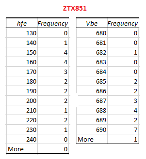

I have to apologize for my comment wrt the ZTX851's -- I got several quite close matches from a Mouser batch, but as I started looking for more matches and the results (Vbe) were a little more dispersed than I had hoped.

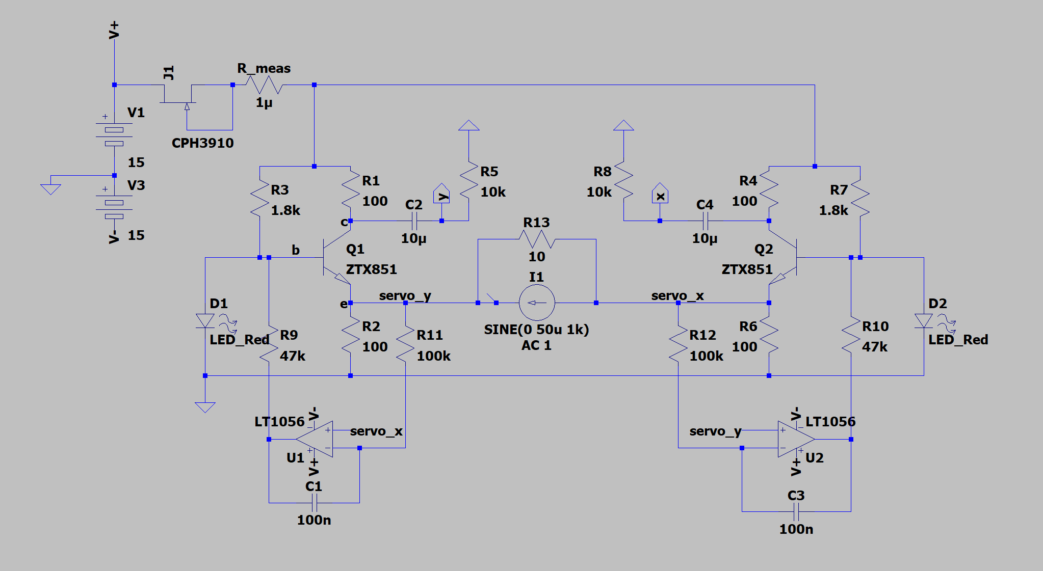

With a simple 5V supply and closely matched ZTX851's, emitter and collectors resistors, I am getting emitter voltage on both devices within a milliVolt or so. I still haven't gotten the servo to work correctly, however.
