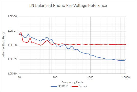

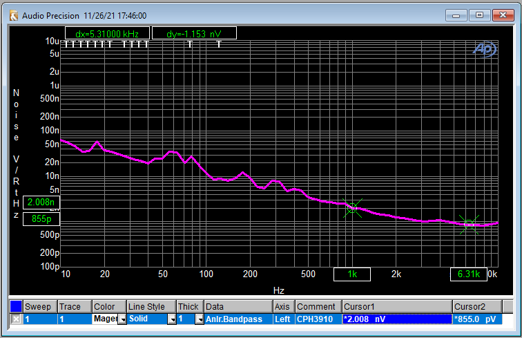

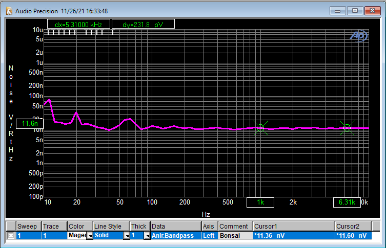

It took me a bit longer to do the comparison. The amplifier used is Groner's with a noise floor of less than 500pV/RtHz

Sam's amplifier is for measuring noise, and the couple I have built check in at 500pV/RtHz or better which is more than adequate for the job. So I measured the noise injected which would be present at the ZTX851 collectors. His amplifier is not quite as fussy as others and is very resilient.
As the load impedance is static, how much does it matter?
When a final design is settled upon will see if the two make an audible or even measurable difference. I am struggling to determine why the suggestion of a simple remedy would be annoying.

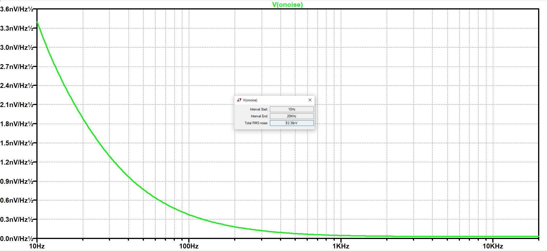

The noise floor is currently simming at a shade under 300 pV/rt Hz as measured at Vout. The transistor bases are decoupled to ground with 1000uF caps fed through 2.2k resistors and the 10V rail via 10 ohms and 1000 uF so both these networks must be included in the noise analysis. On the X-Altra, the PSU noise was about 7nV 20-20 and 300 pV/rt Hz spot noise at 1 k. Obviously, it increases at LF due to 1/f - so similar to the current approach.

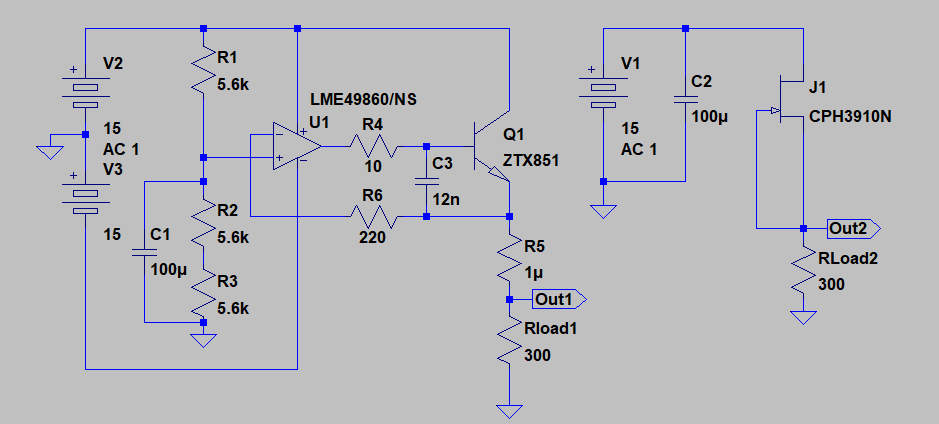

The LM4562 + ZTX851 form a 35 mA 10 V regulator that feed the collectors. This voltage is also divided down to form the base reference at 2.1 V.

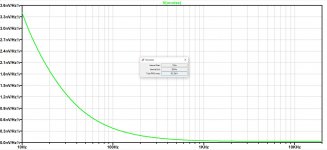

The TranBal PSU is about 45pV/rt Hz, 12.38 nV over 20-20kHz and the PSRR ~80 dB/decade from 10 Hz to 1kHz. The PSRR is > 120 dB from 4kHz to 80 kHz after which it rises and at 1MHz its still > 80 dB.
You have to include the 1000uF output cap - that's the reason for the compensation components (which may have to be tweaked once on the board). The X-Altra PSU does not use the series pass transistor and the base stopper, and the 10 ohm output resistor was 47 ohms (current draw was 3.5mA per rail, so about 10% of this design). The total integrated noise on that PSU is 7nV 20-20kHz.

Output 2 is quieter (simpler too) and yields the same Vref:
Output impedance of the bipolar voltage source is virtually zero, output impedance of your JFET alternative is 300ohm. You think this is irrelevant here? What about the load regulation?
It would also be interesting to find out the potential at the junction point of two fighting current sources (your JFET current source and the bipolar collectors).

BTW the PSSR is not 80 dB/decade but ~40 dB/decade from 1Hz to 1kHz - my error.
I just redid the integrated noise over a more conventional 20-20kHz and not 10-20kHz as above and its 9.5nV
Ok, do you understand what is Jack suggesting? Replacing the TranBal PSU with a JFET current source? Am I high, or what?
Replacing a reference voltage with a low noise current source feeding a resistor is possible, and in fact used even in ICs, the LT3045 is built on this principle. But an entire power supply, don't think so.

What you are posting is a different thing, I would actually put the LED string (fed with a CCS) and connec it to the Base of a BJT and take the Vref from the Emitter of that BJT.
That will give you a low noise Vref with a low output Z.

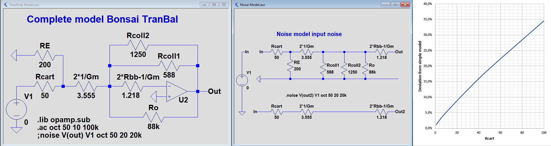

In the spreadsheet I posted in #219, to calculate the noise I used a (simple version)*(correction factor) to get the correct noise RTI.
The simple version is 2*Rbb+2*1/2Gm+RCart.
However, the two 100R base resistances, the 294R//625R collector resistances and even the Ro's from the ZTX81 transistors are all contributing to the final noise.
That's why a model was made with an op-amp that conformed in gain and in noise to the complete TranBal model with ZTX81 transistors.
To make the gain equal, a 3.555R input resistance and a 88K Ro were needed to get the gain right for all different Cart resistances.
The 3.555R represents the input resistance being ca. 2*1/Gm at Ic=15mA.
Next step was to make the noise equal between the two models.
For this a 1.218R resistor had to be inserted.
The resistance of both together 3.555+1.218 = 4.773 is supposed to be 2*Rbb+2*1/2Gm.
Since 2*1/Gm was already found to be 3.555R, this leaves 2.9955R for 2*Rbb or 1.5R for one ZTX81, well conforming to AoE.
Now comparing the correct model versus the simple model, both shown in the middle of the image below, a plot can be made what deviation the "real" model has versus the simple model.
While this is almost a straight line I could use the correction factor (1+Rcart*17/5000) without further having to make complex calculations.
