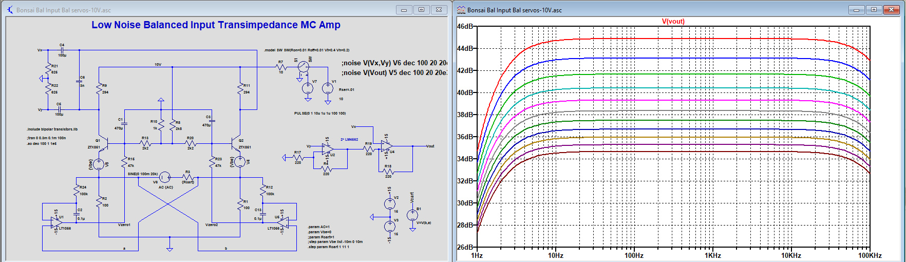

Low noise Balanced MC Pre

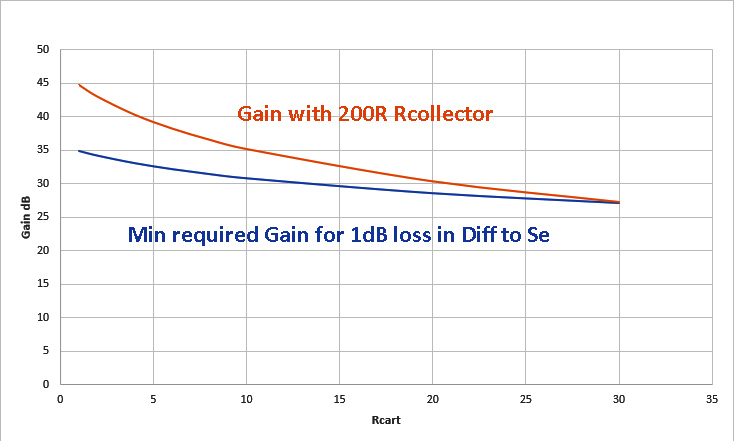

That 1:6 means also 1:6 in voltage output.
You now have 1:4 in the Riaa stage, make it 1:6.
Fix the collector resistances at 200 and the diff to se stage to 1x, in line with what Syn08 also advised earlier and you are done.
I’ll send you again the previous graph with the minimal gain required but now also added with the gain you will get with fixed 200R resistors.
My expectation is that they will be almost identicical, meaning that there is no need for different collector resistances.
Hans
I found that with 20R Carts and above, noise penalty of the Diff to SE becomes too big because the min required gain for 1dB noise penalty cannot be achieved.
That's why your original two amp solution with 100uF in front are the better solution.
This has taken some time to compare all options, so within an hour I will come back with the results.
Hans
The dual amp version with two 100uF caps, add 4.33nV/rtHz to Vx,Vy instead of the 8.88nV/rtHz of the single amp version.
This made it possible to reduce Gain of the first stage by 6dB to meet the max 1dB noise addition to the first stage, and Carts above 20R now fall within the 1dB.
See outcome in image below.
In the previous version, Rcol could go to 250R, but with the 1k from the Diff to Se converter attached to it, it became effectively 200R.
The other current leaking effect was that the collector voltages came exactly in the middle of the max voltage swing with 5.2Volt.
However the dual opamp Diff to Se converter is not DC coupled, causing a shift from the collector voltages.
To bring them back to 5.2Volt, 294R resistors are needed and to get the previous effective 200R load two resistors of 625R are connected to gnd after the caps.
Now gain is as before with 250R//1K resistors and the min required Gain for a 30R Cart meets exactly the real Gain.
Gain for low R Carts could optionally be reduced with a single resistor between the two collectors.
Hans

  • Bonsai Bal Input Bal servos-10V.asc
In the above graph with min Gain, it is easy to see how much gain can be dropped to still meet the 1dB criterium.
For an 1R cart this could be 9.9dB, for a 6R cart 6.1dB and for a 10R cart 4.4dB.
So up to 6R a factor 2 seems reasonable, translating in one 400R resistor between the collectors.

Again, its your baby, you decide, but looking at the the minimum needed gain for max 1dB loss in the Diff to Se converter, you can't afford a 4:1 gain selection, 2:1 seems the optimum.
The point with a 220R collector resistor is that clipping is not symmetrical, but with 294R and an external 625R (together 200R) it is.
And was it clear that one 400R resistor between the collectors is enough to halve the gain, instead of the two you used for each side.
