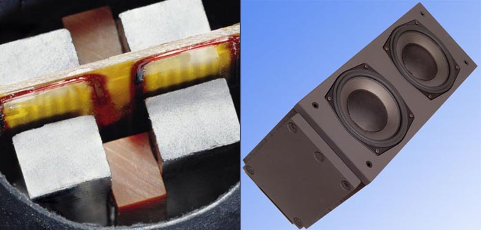

A coil may be used advantageously though if it is wound separately and features its own magnetic circuit. That's btw how B&M does it since long, one of the few protagonists of MFB for decades.
Very Cool! thanks for mentioning the B&M MFB, I was not familiar with it.
It has been discussed at least once on the forum here:
http://www.diyaudio.com/forums/mult...feedback-mfb-inductive-sensor.html#post762711
Some pics of their sensor attached.
I noticed their website mentions a capacitive sensor as well....hmmmmm...
