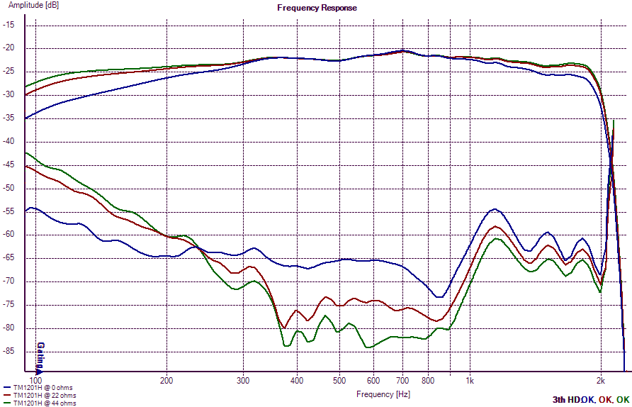

In my current drive experiment (voltage drive amplifier with inline resistor) I found that midband distortion was reduced (especially with an old motor without rings and all the modern stuff), but there was still a steady rise in distortion in the low range, directly proportional to excursion (in the attached curves you can see a rise in distortion in the lows with current drive, but it is only due to the rise in level in this range, following the rise in impedance when approaching resonance...)
Would not MF be able to also reduce this form of distortion, enabling the driver to be used lower (ideally 100 or 150Hz, instead of 300Hz...) ?
current drive is good at reducing motor distortion at high frequencies whilst also making it worse at low frequencies. However no feedback will fix up distributed resonances in the diaphragm since it only tries to correct at one point on the cone which is usually at the voice coil. The high frequency reproduction is still dependent on the construction of the cone and the material used which is why metal cones are favoured for this sort of application.

David - could you please walk us through your first pair of charts (20 Hz) in simple language. I don't think I understand much about them. What are we looking at? Mic measurements? Why are there bumps above and below 20 Hz and every 20 Hz?
Thanks.
Ben
What are you are seeing is the spectrum sweep of the output of the accelerometer (not from a microphone which should be very similar) whilst the speaker is being driven from a built in sinewave generator without and with feedback applied. In an ideal world with no distortion you should only see a peak at 20Hz and nowhere else. The peaks at the multiples of the fundamental of 20Hz is indicative of distortion. So the 2nd harmonic distortion is at 40 Hz, 3rd is at 60Hz, 4th is at 80Hz etc. When feedback is applied you expect to see the level of the fundamental stay the same whilst the other peaks should reduce in proportion to the amount of feedback at that particular frequency which is what you are seeing in the second plot.

I hope Gerald Fry (and other wise persons) are out there to correct my poor grasp of this but...
In the first chart, we are looking at a spectrum analysis of the signal coming from the accelerometer. It shows both the 20 Hz sine input as well as all the crap generated by EVERYTHING upstream and some downstream of the accelerometer (which includes the driver (driven hard to some unknown degree of duress), your trick circuitry decoding the accelerometer, DSP, faults of the accelerometer, shaking mounting, loose objects buzzing around the driver, etc.). As negative as I am about speaker distortion, it seems like David has posted a chart showing a mountain of distortion (which some readers may falsely attribute to the driver alone, perhaps thinking it is being dramatically over-driven).
In the second chart, we are looking at the accelerometer output with some degree of negative feedback applied. THAT negative feedback corrects EVERYTHING in the circuit whether (as in the first chart) it arose from the so-so drivers you are using, faults of the accelerometer, circuitry, loose buzzing objects shaking the set-up, DSP, etc. We don't know exactly what pieces of the loop are present in the first chart and second chart.
So David's impressive reduction of distortion by negative feedback includes the correction of many elements besides the driver and some of these distortions are introduced by David's own gizmo... and then reduced by negative feedback in the second chart.
It is a trivial chore to simply put a mic in front of the driver, before and after, and run it through the same spectrum analyzer. Even a cheap mic (or a Radio Shack SPL) should pick up those horrible spectral ghosts and illuminate (if not fully clarify) what happens with the MF applied.
Or I could be quite confused.
Ben
Yes I could put a mic in front of the speaker but because it is mounted in free air would give an erroneous result due to acoustic cancellation. What you are seeing from the accelerometer is attributable to the speaker alone since none of the other elements such as the accelerometer, DSP, ADC, DAC, amplifier etc exhibit anywhere near the same non linearities as the speaker. In fact the speaker is not good at reproducing anything below its resonant frequency and would not normally be used in hifi apps because of its high distortion.
The next test will be to put the speaker in a sealed enclosure and then run the same test with a mic. I will do this as a matter of course. I also have a good quality 18 inch driver designed for subwoofer apps which I shall test as well once I find a suitable enclosure to house it in.

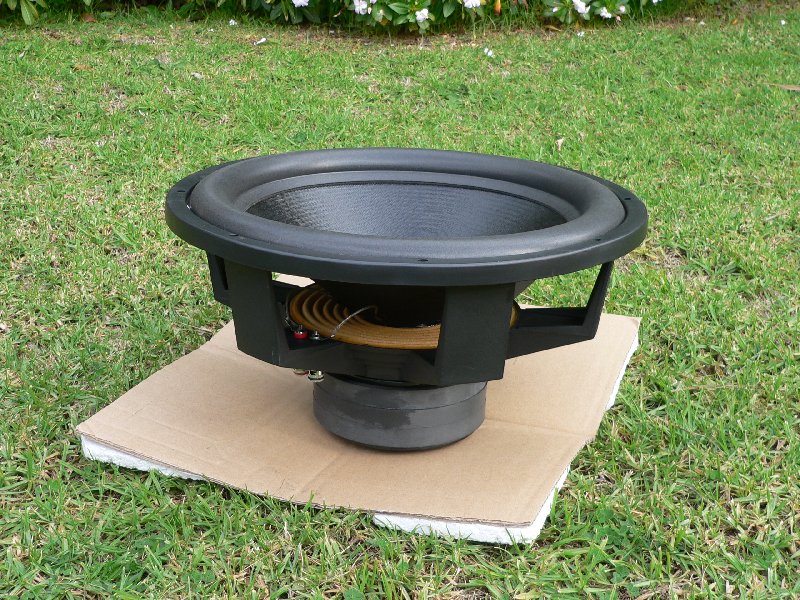

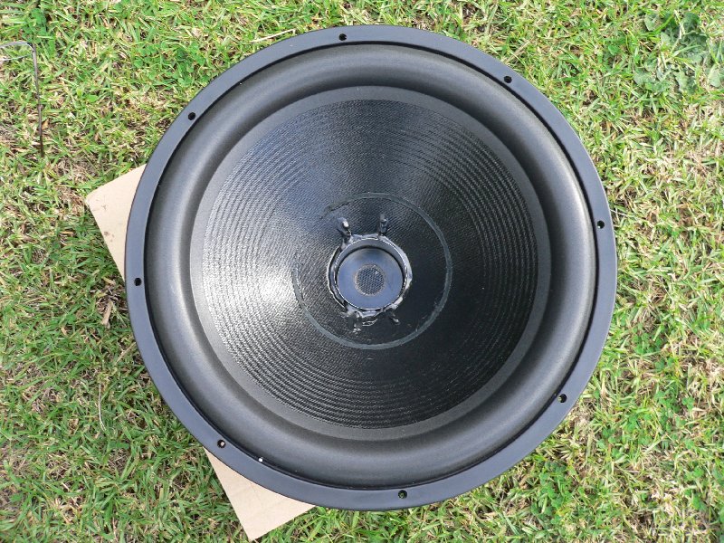

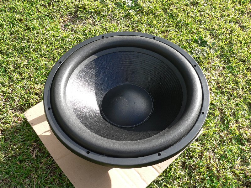

18 inch sub ready for a transformation !
IST Mach 5 IXL-18 ready for surgery !!
Images shown before and after the dust cover removed ready for the accelerometer transplant !! Next week I will build the accelerometer bridge and mount the accelerometer. Now all I need is a speaker box !!
