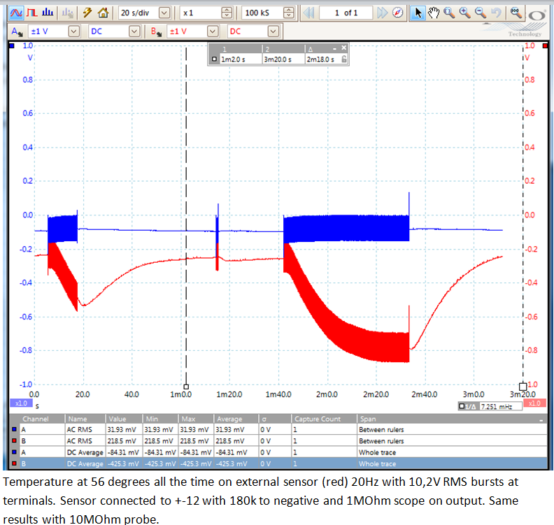

Measurement of temperature influence ACH-01-03

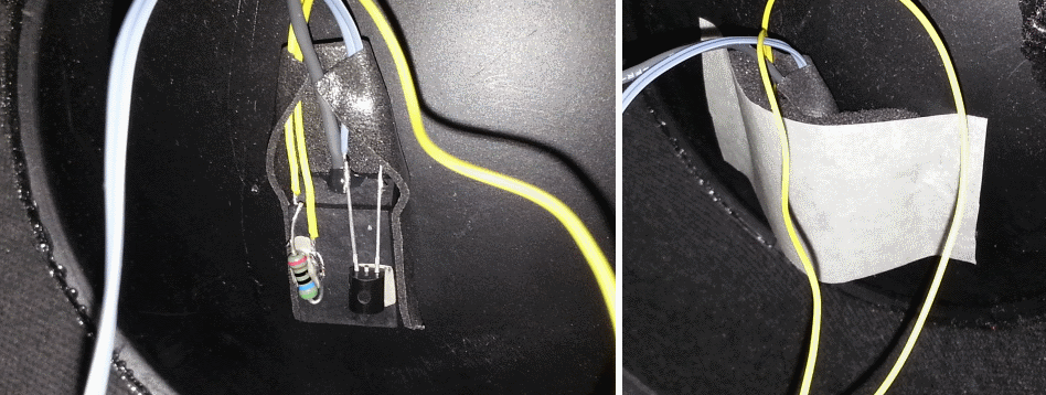

I know you have taken precautions regarding the temperature issue David, but I was still interested in how the sensor reacted to different temperatures.
I connected a second sensor on the dustcap of my sub. On this sensor I fitted a temperature sensor and a 530Ohm resistor using thermal glue. I also insulated the thing with foam and tape.
With this, I was able to adjust temperature from 23 degrees celcius to 80 degrees (73-176F) by applying 0-30V to the resistor. The heat generated was a maximum 1,7W and since it is thermally isolated from the voice coil it will not influence my first sensor or the output of the woofer when voltage driven.
I ran a total of 40 tests at 23, 56 and 80 degrees celsius with different output levels. The results spread a little between equal tests so I had to re-run some of them to get a good average.
DC

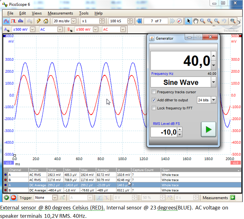

At 23 degrees the DC is -200mV
At 56 degrees, somewhere in the -400mV to -300mV range. This can vary.
At 80 degrees the DC is -1,2V
Senor output vs temperature
At 56 degrees the sensor output AC voltage is reduced by a factor of 0,86.
At 80 degrees the sensor output AC voltage is reduced by a factor of 0,64.
In other words, when the sensor is at 80 degrees the g-force will be only at about 64% of its correct value. In my old fashioned analogue MF system this will give a reduction in loop gain of 3,9dB. At 56 degrees the reduction is only
1,3dB.
The heat problem is definitely there, but it seems that it is not the biggest of problems after all. 🙂
Here is a scope picture from my measurements.
