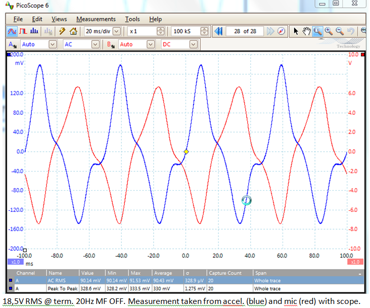

accel vs mic
You are right, but the fact is that the signal from the accelerometer is exactly the same as the input signal. No need to integrate. When the input signal goes through zero, the speed of the cone is at maximum and the acceleration is zero. I should know, I have been looking at the signals on my scope for over 20 hours this week 🙂
I have no intentions of stealing this thread, but there have been questions about the correlation between "real" microphone output vs accelerometer measurements in this thread.
I have finished the initial testing of my "old fashioned" analogue MF system and have measurements from both accelerometer and microphone. The woofer is a Peerless XXLS 12" (830845) in a 135 liter box that weigh about 60kg.
The microphone was located about 1,5 inch from the woofer during the test. If located further away, the distortion goes up due to room reflections.
The numbers.
20Hz, 18,5V RMS on terminals, NO MF gives THD of 31,4% measured with accel
20Hz, 18,5V RMS on terminals, NO MF gives THD of 24,2% measured with mic
20Hz, 18,5V RMS on terminals, with MF gives THD of 1,34% measured with accel
20Hz, 18,5V RMS on terminals, with MF gives THD of 1,63% measured with mic
Here is a picture whre you can see the difference. (NOTE. The blue curve is inverted because the direction of the accel is positive inwards)
As you can see there is a sharper knee on the blue curve from the acceleremeter while the microphone curve is more smoothed out. I am not sure why this happens, but probably becuase the accelerometer is mounted just on top of the voice coil and can pick up higher frequencies than the whole cone transfer to the air.
