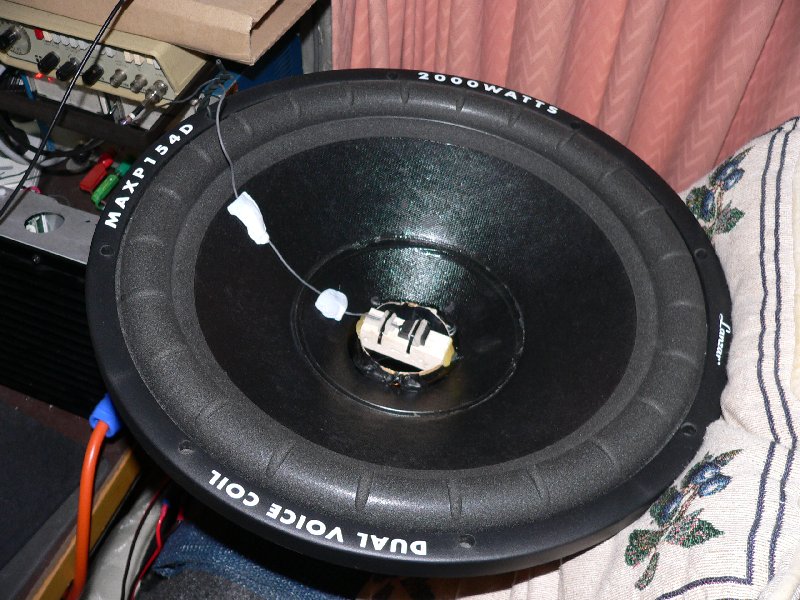

The board is designed to interface directly to a highly linear and low noise industrial grade accelerometer, namely a Measurement Specialties ACH-01-03 accelerometer. A novel mounting method directly couples the accelerometer to the voice coil which minimizes base strain and thermal coupling to the accelerometer. This accelerometer features an integral shielded flexible lead and a +/- 150g capability with a 30KHz mechanical resonance. This is the same accelerometer used in a $50,000 reference speaker system for the same type of application. It can be purchased from a number of sources including Digikey and Mouser for as little as $20.

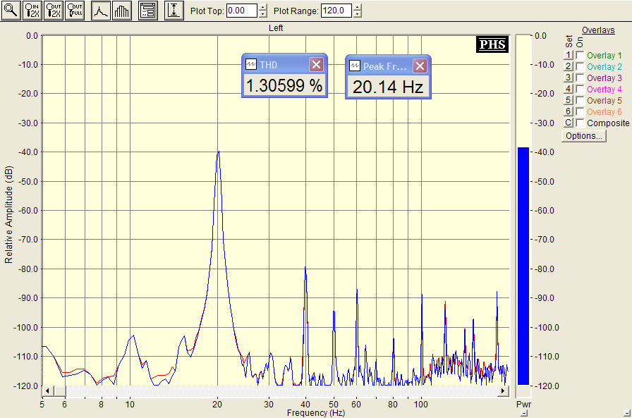

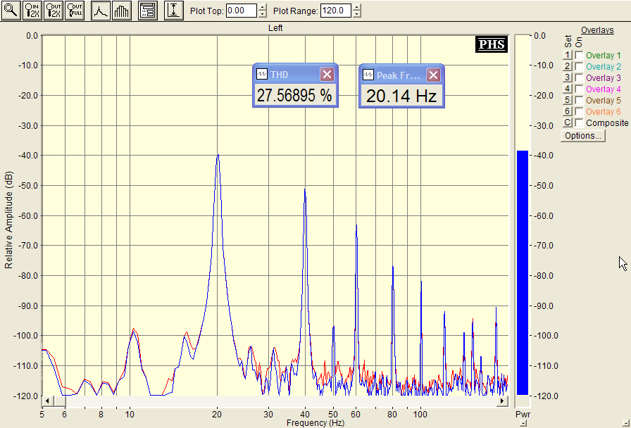

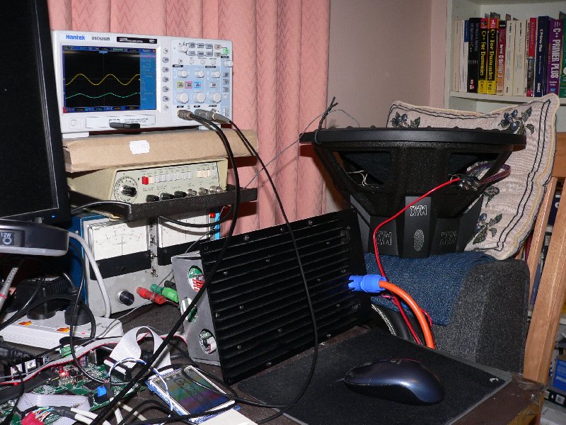

1st image - DSP servo controller,
2nd image - Test loudspeaker with accelerometer mounted to the voice coil,
3rd image - The whole setup,

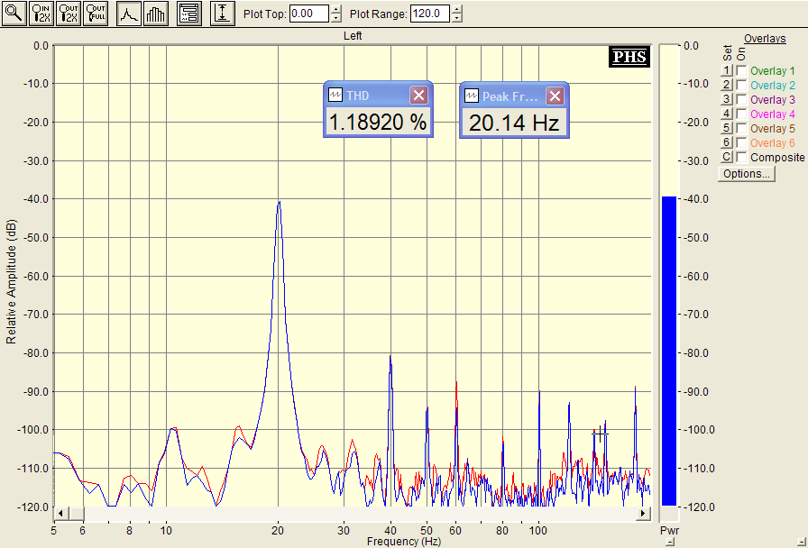

4th image - Distortion results at 20Hz before feedback,
5th image - Distortion results at 20Hz after 30 dB feedback applied,
Hi David,
The level of fundamental (20Hz) in 5th image is about 2dB lower than in 4th image (before feedback).
Are you able to provide feedback results for fundamental of exactly the same level as in the 4th image?.
Best Regards,
Bohdan

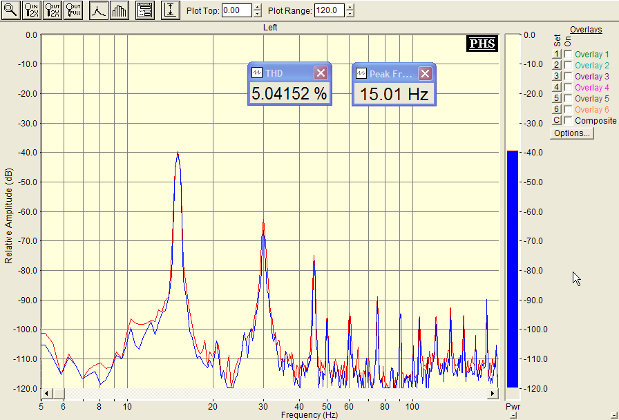

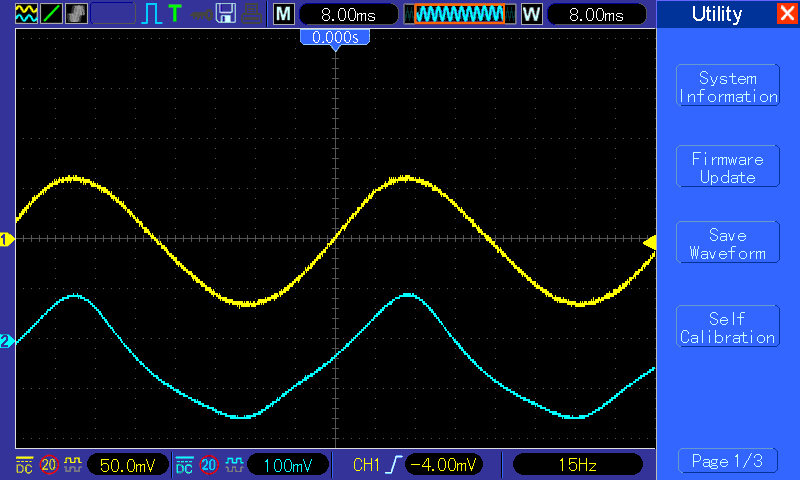

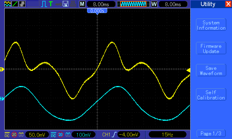

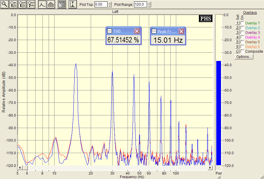

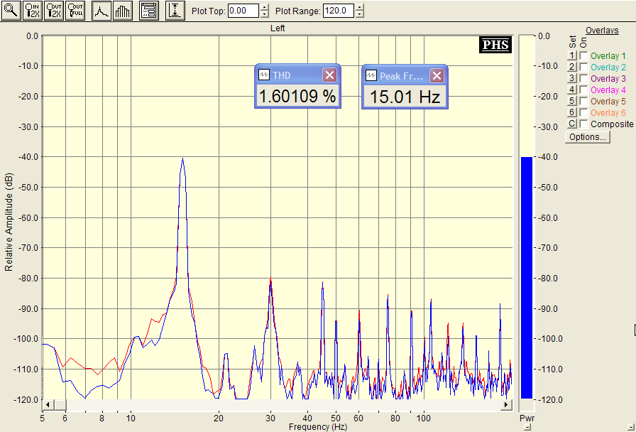

Speaker/Accelerometer 15 Hz Single Tone Test
This test shows a worst case scenario which emphasizes suspension and motor distortion and the effectiveness of feedback to clean it up ;) This speaker produces loads of distortion below it's resonant frequency. The lower the frequency the more dominant the distortion mechanisms. I would not recommend it for HiFi use ;)
1st Image - Distortion Spectrum with Voltage Drive and no feedback
2nd Image - Distortion Spectrum with Servo and 30 dB loop gain
3rd Image - Distortion Spectrum with Servo and 30 dB loop gain + boost
4th Image - Oscilloscope shot with Voltage Drive and no feedback*
5th Image - Oscilloscope shot with Servo and 30 dB loop gain*
* Oscilloscope top yellow waveform is the accelerometer output
* Oscilloscope bottom blue waveform is the voice coil current

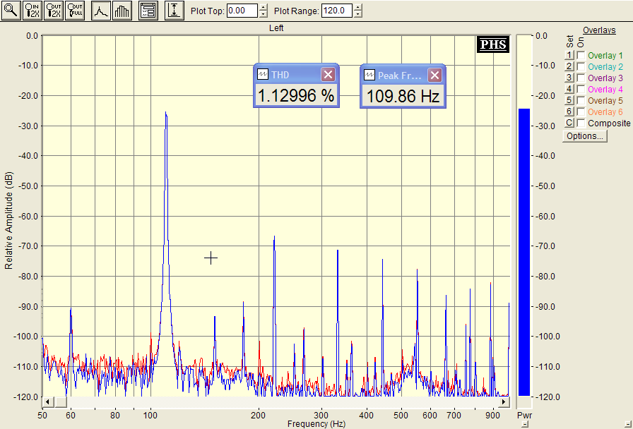

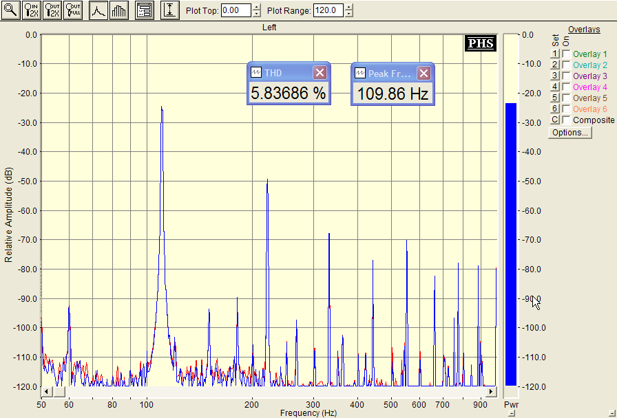

Speaker/Accelerometer 110 Hz Single Tone Test
The following measurements compare the effectiveness of current drive alone in reducing high frequency distortion. About a 14 dB reduction in distortion can be achieved with current drive depending on the drive level. Unfortunately current drive is worse than voltage drive at frequencies below the resonant frequency which is where the global feedback is effective ;)
1st image - Distortion Spectrum with Voltage Drive and NO global feedback
2nd image - Distortion Spectrum with Current Drive and NO global feedback

Mounting of the accelerometer is crticial. As soon as you mount it on a dust cap you create a mechanical resonance depending on the weight of the accelerometer and the mechanical compliance of the dust cap. This resonance can vary from a few hundred Hz to the KHz region and makes this type of mounting totally futile in most cases. The end result is to make the system unstable and turn it into an oscillator.
I have an 8 inch aluminum coned woofer and I mounted the accelerometer onto the aluminum dustcap using bluetack of all things. It works quite well but exhibits a sharp peak resonance of 15 dB at 1.3KHz. Without filtering the system will oscillate at about 1.3KHz. But I have built in a user defined fully customizable anti-modal filter which can essentially null out this resonance and eliminate any instability ;) At the end of the day the accelerometer should be tightly coupled to the voice coil but even then you have to deal with modal resonances in the speaker cone. Again the anti-modal filter built into the dsp software comes to the rescue ;)
