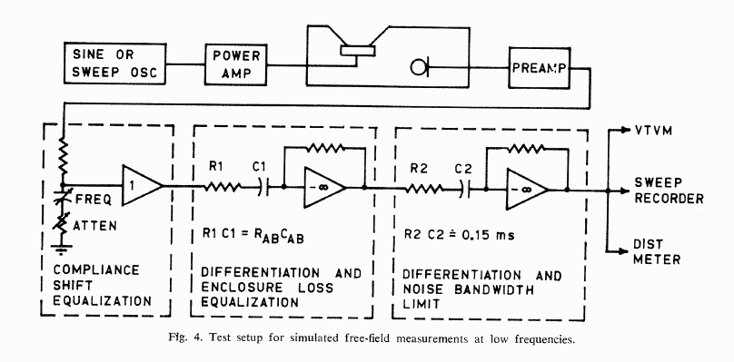

Actually, this just reminded of an AES article "Simplified Loudspeaker Measurements at Low Frequencies" in which far field pressure response is determined based on differentiating twice the pressure measured inside the enclosure.
AES E-Library Simplified Loudspeaker Measurements at Low Frequencies
Differentiating the internal pressure once gives response proportional to volume velocity of the cone.
Differentiating the volume velocity gives cone acceleration which is proportional far field pressure response.
See attached pic for Small's measurement setup.
The paper provides theory & measurement comparisons to show that this method works for both sealed AND vented enclosures.

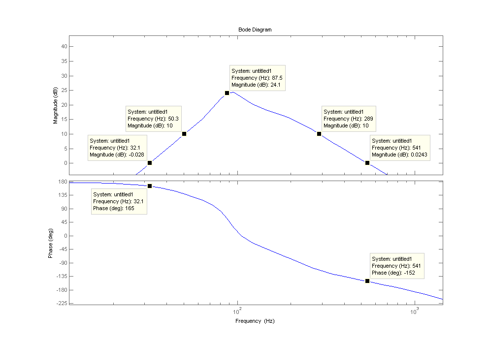

I am working on a low gain, large bandwidth feedback controller for a woofer. Passing Open Loop 0dB's at 30Hz and 450 Hz in order to have acceptable disturbance rejection of the harmonics in de 50-300 Hz area.
The gain is low, only 25dB max, but since it is wide, the rejection is not only in the sub 120Hz range, but in a wider range.

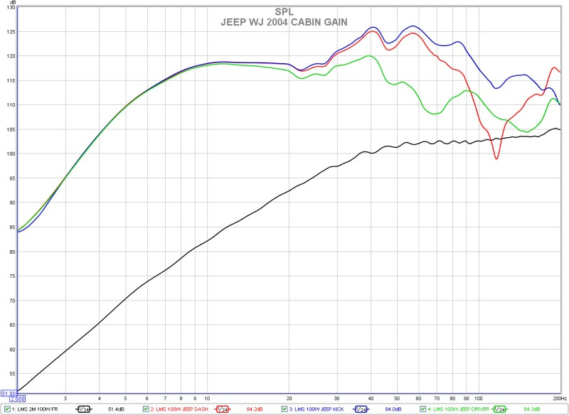

In my previous response, I forgot to cover the topic of pressurization gain(aka room gain), which is one area in which constant pressure from constant displacement does come into play
The magnitude of acoustic pressure waves radiated from a woofer cone into free space or a large room is proportional to cone acceleration. But, what happens when the room starts to look small compared to the wavelength of the radiated sound? Well, the room will start to confine/contain the pressure rather than having the radiated waves bounce around it. Basically the room transitions from being a reflector of sound waves to a pressure vessel.
If your room was a perfectly solid, airtight, small concrete bunker, the measured SPL in the room would be proportional to woofer cone displacement for frequencies well below the lowest room mode. If you placed an ideal subwoofer (flat SPL response 1hz to 100Hz in free space) into this perfectly solid room, the measured response would be boosted by 12dB/oct below the lowest room mode. Most of our listening rooms are large enough and leaky/flexible enough that not much if any pressurization gain is seen.
But, if you happen to own a modern tightly sealed automobile, you can experience this gain for yourself. The 12dB/oct boost usually begins around 50hz for average sized cars. So, if you place a sealed subwoofer with f3 = 50Hz in the car(with windows rolled up of course), you will measure nearly flat SPL response down to 20Hz and below depending how airtight the vehicle is. This is because below 50Hz the -12dB/oct roll-off slope of the sealed subwoofer is equalized by the +12dB/oct pressurization gain.

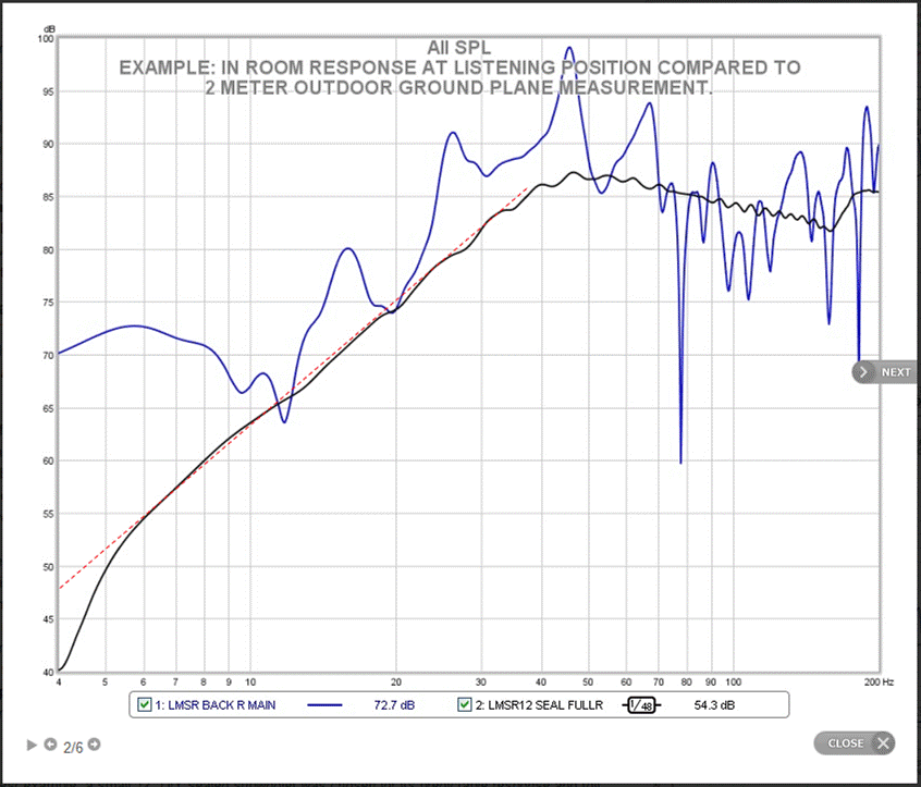

Measurement of myth?
From: Investigating Room Gain, "How much boost is my subwoofer going to get?"
+30dB at 4Hz is a lot to gain from faith alone. 😛
Oh, it's nowhere near as much as some hope to be the case, as the page points out, but even in a quite large, lightly built room with small subs the measurements show it to be far from "insignificant" nor with "zero presence". It's just not so active higher up, but that may not be the case in a smaller room.

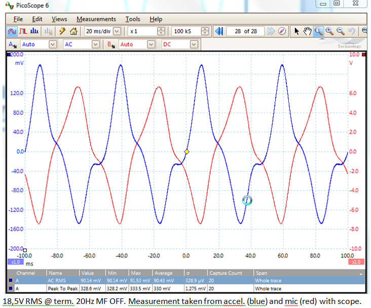

I have finished the initial testing of my "old fashioned" analogue MF system and have measurements from both accelerometer and microphone. The woofer is a Peerless XXLS 12" (830845) in a 135 liter box that weigh about 60kg.
The microphone was located about 1,5 inch from the woofer during the test. If located further away, the distortion goes up due to room reflections.
The numbers.
20Hz, 18,5V RMS on terminals, NO MF gives THD of 31,4% measured with accel
20Hz, 18,5V RMS on terminals, NO MF gives THD of 24,2% measured with mic
20Hz, 18,5V RMS on terminals, with MF gives THD of 1,34% measured with accel
20Hz, 18,5V RMS on terminals, with MF gives THD of 1,63% measured with mic
Here is a picture whre you can see the difference. (NOTE. The blue curve is inverted because the direction of the accel is positive inwards)
As you can see there is a sharper knee on the blue curve from the acceleremeter while the microphone curve is more smoothed out. I am not sure why this happens, but probably becuase the accelerometer is mounted just on top of the voice coil and can pick up higher frequencies than the whole cone transfer to the air.
PS. I was fooled by a poor measurement microphone for a long time. I was using a 300$ calibrated "Brand X" thinking it was good enough. But the distortion levels only came down to a certain level and stopped even when the accelerometer distortion went further down. I therefore built my own following Linkwitz guide with a Panasonic WM-61 capsule and a MAX427 opamp. With that the distortion levels matched.
Nice measurement set showing clearly the pressurization gain.
Although the results in general look reasonable, I do wonder about their ground plane measurements for frequencies < 6Hz where the data deviates from the -12dB/oct response slope for a sealed woofer(Attachment #1). When calculating the delta to get the pressurization gain curve, this deviation is giving 7db-8dB more gain at 4Hz than it probably should. The resulting data would then fall more in line with other measurements I have seen and taken where the pressurization gain tapers off as you approach DC unless the room(or car) is perfectly sealed and very stiff. I wonder what type of door they had in their room? Most doors in US homes have a large gap under the door to help with air circulation for central air heating/cooling systems.
One other possibility for the deviation for frequencies <6Hz would be that their microphone response was not calibrated for frequencies that low. In that case, it would have affected the in-room measurements as well, and then the calculated deltas would be correct. But, I noticed that the website has data for a similar test performed in a large SUV.
Data-Bass
The ground plane measurements here do not show an abrupt change in slope below 6Hz so this seems to rule out the microphone calibration theory(Attachment #2). In any case you can clearly see the “in car” response is predominately flat down to 10 Hz even though the ground plane response of the woofer starts rolling off nearly 2 octaves above that. It would have been nice if they had included a pressurization gain curve calculated from the delta between the two measurement sets similar to what they did for the room. If I am reading the curves correctly, it would have shown the gain curve start to flatten from the 12dB/oct slope below 10Hz as air leaks and flexibility in the SUV started to affect its pressure containing capability.

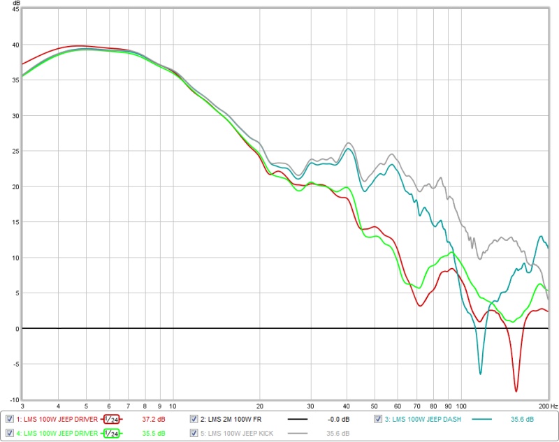

Bolserst,
The particular measurement rig used for those measurements consisted of calibrated Earthworks M30 microphone & Quest SPL calibrator, Presonus Fire Studio interface, Powersoft K10 amplifier, etc...Anyway that signal chain is basically flat to the 8Hz region with the EW's M30 basically flat till about 5Hz, but the electronics do start to roll out sharply below 5Hz. The deviation from 12dB/octave below roughly 8Hz shown in the first graph is likely due to environmental noise contamination. Even with averaging it is quite difficult to obtain satisfactory SNR at such low frequencies in an outdoor groundplane environment for the baseline measurement with the inherent output limitations of typical devices. Being that the output is so low in level at such deep frequencies there is a high likelihood that background "drone" from heavy equipment, planes, cars, etc...is having effect. Such being the case the results below 10Hz should be considered "ballpark" with increasing deviation seen as the frequency drops and SNR worsens.
The room used was not sealed at all. The house was built in 1894 and this was a wood frame room over crawlspace with old duct work and a couple of large openings to other very large spaces. About as far from sealed as it gets. The Jeep was a standard model Grand Cherokee of 2004 vintage as driven every day that had a sealed enclosure placed in the cargo hold facing the back glass about 4" from the hatch. The measurements indicate what a single 90dB sensitive 4ohm woofer in a sealed enclosure driven by just 20 volts input can do in a medium sized SUV. Force multiplication at its finest.
Here is the data graph requested. Note that the second measurement labeled driver position is with the subwoofer cabinet rotated and firing towards the front instead of towards the rear so that the effect of orientation could also be compared.
