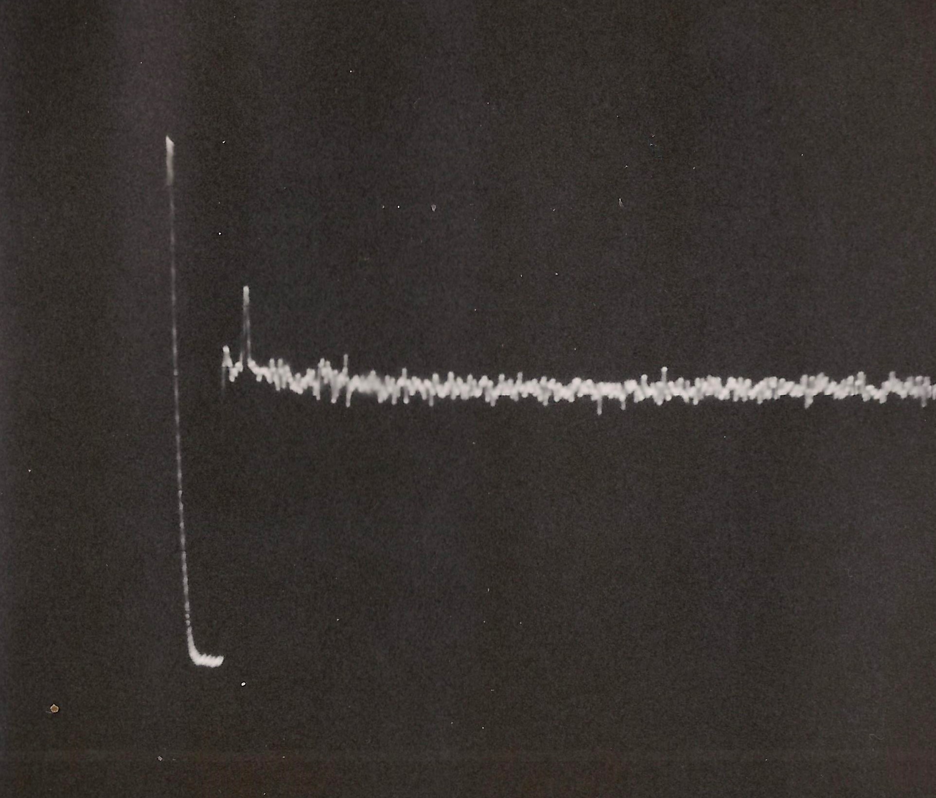

Anecdotally -- and why not? -- I was working on my version of the HP 339A osc. and was slowly adjusting the feedback pot, while watching distortion using my T-T filter, the EMU 0204 and ARTA. I also was eyeing output level, and the gate voltage on the JFET -- it helps to have four eyes.
The oscillator was running at 6.3VRMS into a 10k load at 1kHz, and the gate voltage was about -0.4VDC. As I made a tiny tweak, I noticed that the distortion products were dropping slowly into the noise, while the output didn't change level. The FET basically squashed, and somehow the oscillator was in metastable equilibrium, with ZERO distortion above the -145dBV noise floor -- that lasted about 5 seconds, while I picked my jaw up off the floor. Then the distortion products came roaring back.
Both David and Demian have made the point that AGC is the source of oscillator distortion after everything else has been fixed, and I know first-hand that this is so. I am so hugely waiting for David to finish his SVO....
This is exactly right. It usually comes down to AGC in one way or another if really good op amps are used. For the AGC, it is either ripple in the AGC control signal or distortion in the AGC element itself, like the JFET.

When I switched to an osc. AGC system which didnt use a jFET for control element, the distortion dropped by 50%.
However, the THD residual is still from the osc itself.... which when changing its opamp and control opamp, the distortion is now 20dB lower! Add another zero.
Now it seems again to be limited to oscillator circuit and noise floor. The jFET controlled oscillators cannot get lower than KroneHite later models which do not use jFEt as control element.
I have observed that with other AGC's, like balancing a pencil on its end.

Catch-up summary -
It might be good to recap for late comers who werent following the HP339A saga of mods and upgrades -->
I had an headphone amp I wanted to measure the THD and the SYS 1 A-P FFT showed the thd was higher than I thought it really was. Turned out I was right and the A-P didnt go low enough [A SYS2 does but I dont want to spend that much money just for my curiousity].
I bought an 339A to modify to see if I could measure the THD+n from it. It uses an jFET AGC also. Davada and I got much lower levels from that exercise -both from the analyzer and the oscillator. Then we began looking at the residual with FFT from others -- like Davada had been doing with QA400 unit. That lead to more spin-offs.
I then bought a KH4400 and couldnt get its thd lower than the 339A. And, it also used a jFEt for control in AGC. Then I picked up a ShibaSoku AD725D on eBay and was able to see the individual harmonics again to very low levels. I could directly read Viktors oscillator THD (+N). So back to tuning on oscillators because I wanted more flexibility from my generator source than I could get from Viktor.
I picked up a newer KH 4402B which uses a different type of AGC (without jFET). You can see it from KH schematics from their web site.
I have modified it from what I had found did the greatest good on the other oscillator models... started with the oscillator IC itself. Now I am 20 dB better than stock.
Thats where I am now... I have the instruments to test and the sources to test extreamly high quality circuits and parts/components, now.... quickly and with accuracy.
Several spin-off have occured along the way -- new oscillator designs with new controls and add-on interfaces for ADC/FFT -- davada and demian and others have taken that role on themselves.
My thinking now is there needs to be a fundamentally new way to generate test tones..... my vision is to have a circuit that does harmonic cancellation rather than making them ever more ultra pure in the first place. Something low in harmonics to begin with but relies on a harmonic cancellation technique to derive zero harmonics at the output. Perhaps an inverted derivitive and then summing the results for cancellation. All regulated and normalized for consistant performance.
