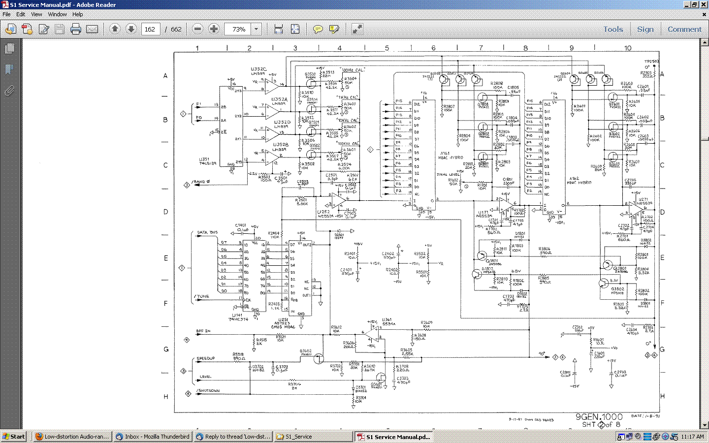

Can you show me the Sys1 oscillator schematic - anyone?

You can download it here: AP High Performance Audio Analyzer & Audio Test Instruments : Home Starts Page 152. (I should have read it before assuming how the box works.) You need to register first. Its an OK scan of the service manual with all the details. You might have been better off servicing it yourself but you never would have gone down this learning path.

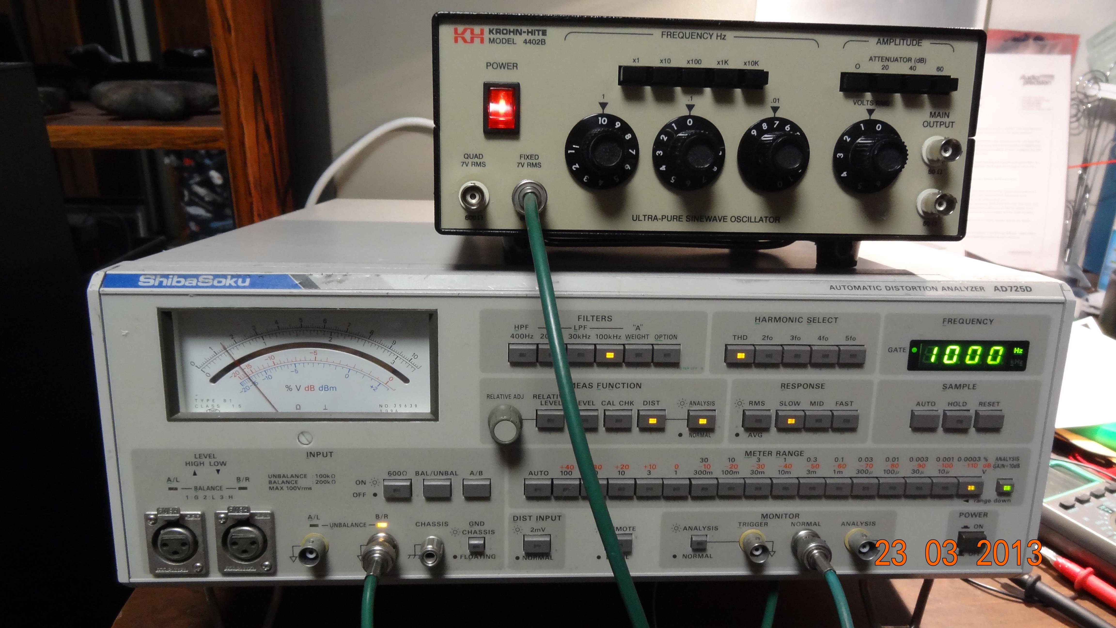

Ok Thanks both for the schematic info. looks like a lot of 5532/34 opamps which can get upgraded.
Meanwhile, back at the bench -->The KH-4402B has now found an opamp combo that does better than either AD797 or LT1037 or LT1468 alone can do.
Replacing U125 with the AD797 and replacing U141 with the LT1037 now gives the same THD+N level at 1KHz and at 10KHz.
Namely,just under .0001% at .00008-9% at either 1KHz or at 10KHz.
This was done on the X1K scale.... just switching from 1 to 10 on the freq dial. But when using the X100 scale and dialed to 10 (1KHz) the THD+N is even lower -- .00005% 🙂
Before, this combo the THD+N rose at 10KHz. Now it is steady at a low level at 10KHz.

The ad797 has much higher noise current and much lower noise voltage than a opa827.
Therefore if the ad797 shows noise improvement then the circuit is likely low impedance rather than high impedance.
So, the opa827 is likely to make things worse.

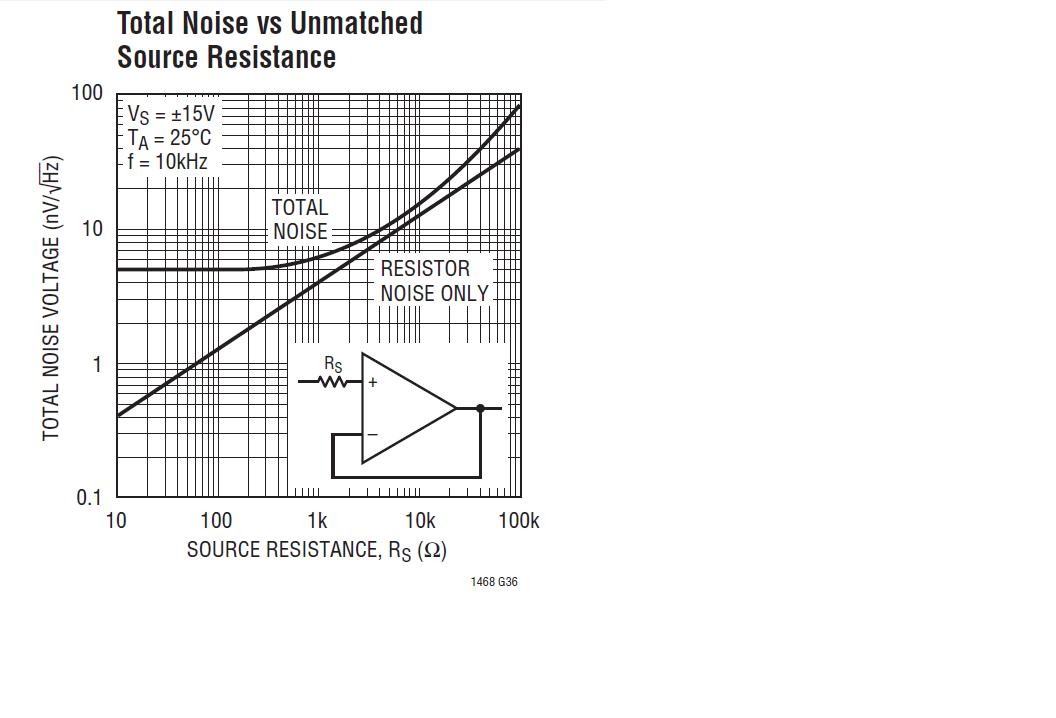

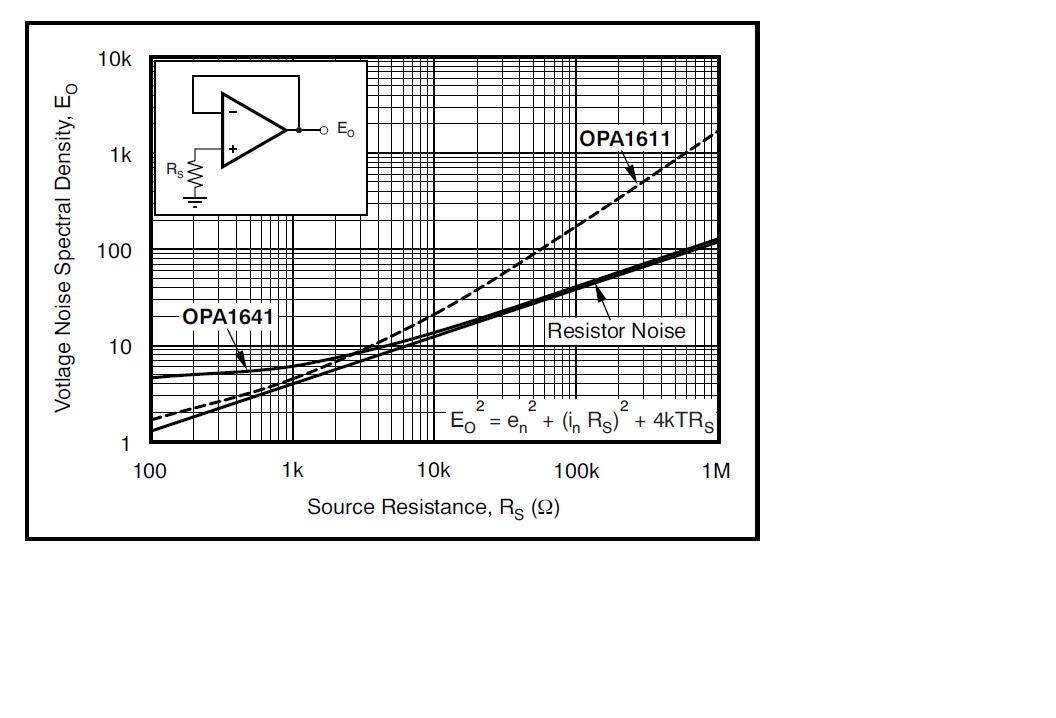

Hi Rick,
Look for charts like this on the data sheets.
The one for the OPA1641 compares to the ultra low noise OPA1611.
The 1611 doesn't do nearly as well at higher impedance.
The 1468 covers a wide range of input R without the noise curve taking off which makes it ideal for wide range OSC tuning.
It would be pointless to use an OPA1611 or the like above a source R of 1K

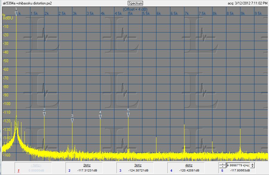

Another issue is that of resultion. I think that quantization noise would introduce significant sidebands/amplitude modulation. A rough calculation lead me to believe that > 16 bit would be required to keep quantization noise below the inherent amplitude noise of a (very) well designed SV oscillator. That's of course again a function of the multiplier decoupling/required settling time. The above number is based on < 10 s to 0.1% for a 100 Hz to 10 Hz range change and a multiplier authority similar to what's found in the AP System One. But that's all plain theory at the moment, I haven't implemented anything.
Samuel
This is exactly what is shown... a lot of spurious freqs other than random noise and harmonics of the test signal. It makes it pretty hard to find the DUT harmonic signals/levels from the system's spurious frqs. at low distortion levels.
A serious pcb layout R&D effort will be needed.

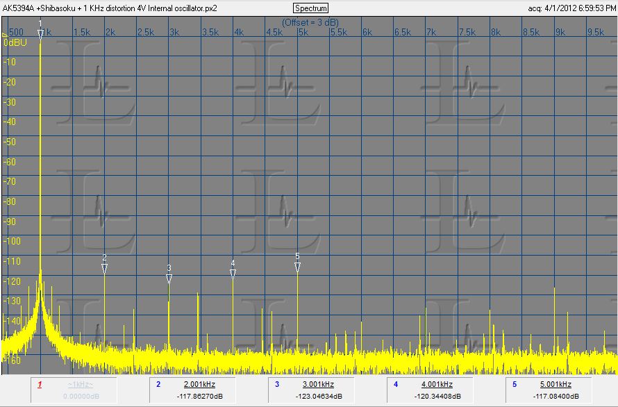

Your thinking details and I am thinking in broader strokes. I'm thinking the implimentation of ADC (and DAC for that matter) varies from brand to brand using same ADC IC. Meaning the spurious freqs are to a large extent due to layout etc.
The goal would be to see nothing but the artifacts of the DUT and random noise. To push those test equipment artifacts below the system noise floor.
Is there a suitable way to turn system test artifacts into noise... randomize them.

Dither.

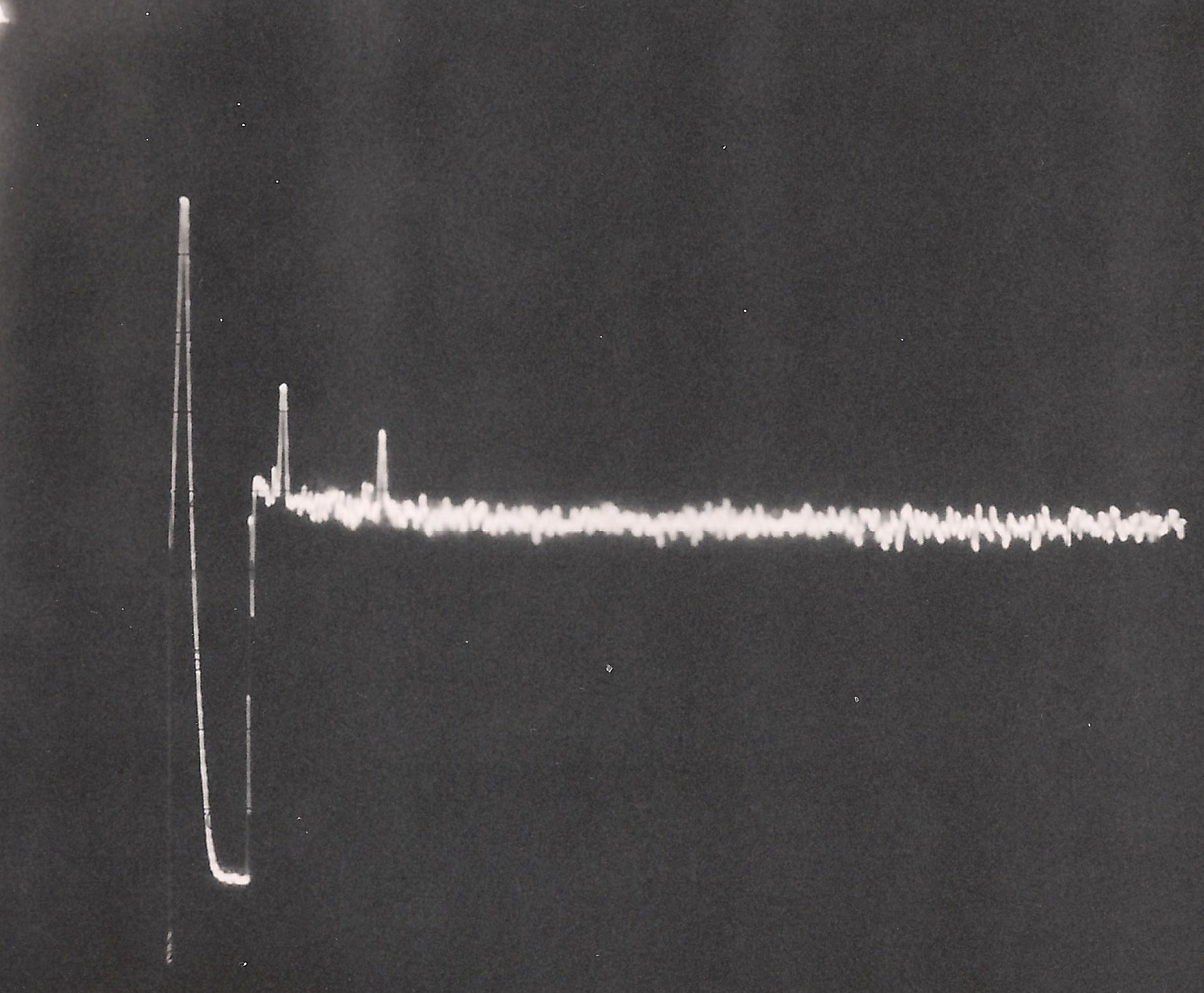

Dither works really well for measurements systems, except when there is deterministic stuff that the dither is not affecting. Here are two measurements that illustrate the issue. Both were made with crystal master clocks. One with the internal oscillator (a gate type oscillator) and the other with an external OXCO connected with clip leads. On the external oscillator (powered from a wall wart) the extraneous stuff is just missing. With the internal oscillator you can see the effects of the counter/divider stages modulating the oscillator. No amount of dither would eliminate the artifacts. Delta Sigma ADC's are supposed to be less sensitive to jitter and may well be but this still highlights that everything is important.
I have a time mark generator I use for testing jitter in ADC's. It has an OXCO as its reference and a synchronous divider. It should be really free of jitter at 1 KHz. However I traced down some 60Hz and 120 Hz sidebands to supply modulation from a less than ideal layout around the oscillator. Cutting the ground plane and returning the primary supply ground a different way reduced the sidebands by 20 dB. These are really subtle details that make a difference when you get below 100 dB.
