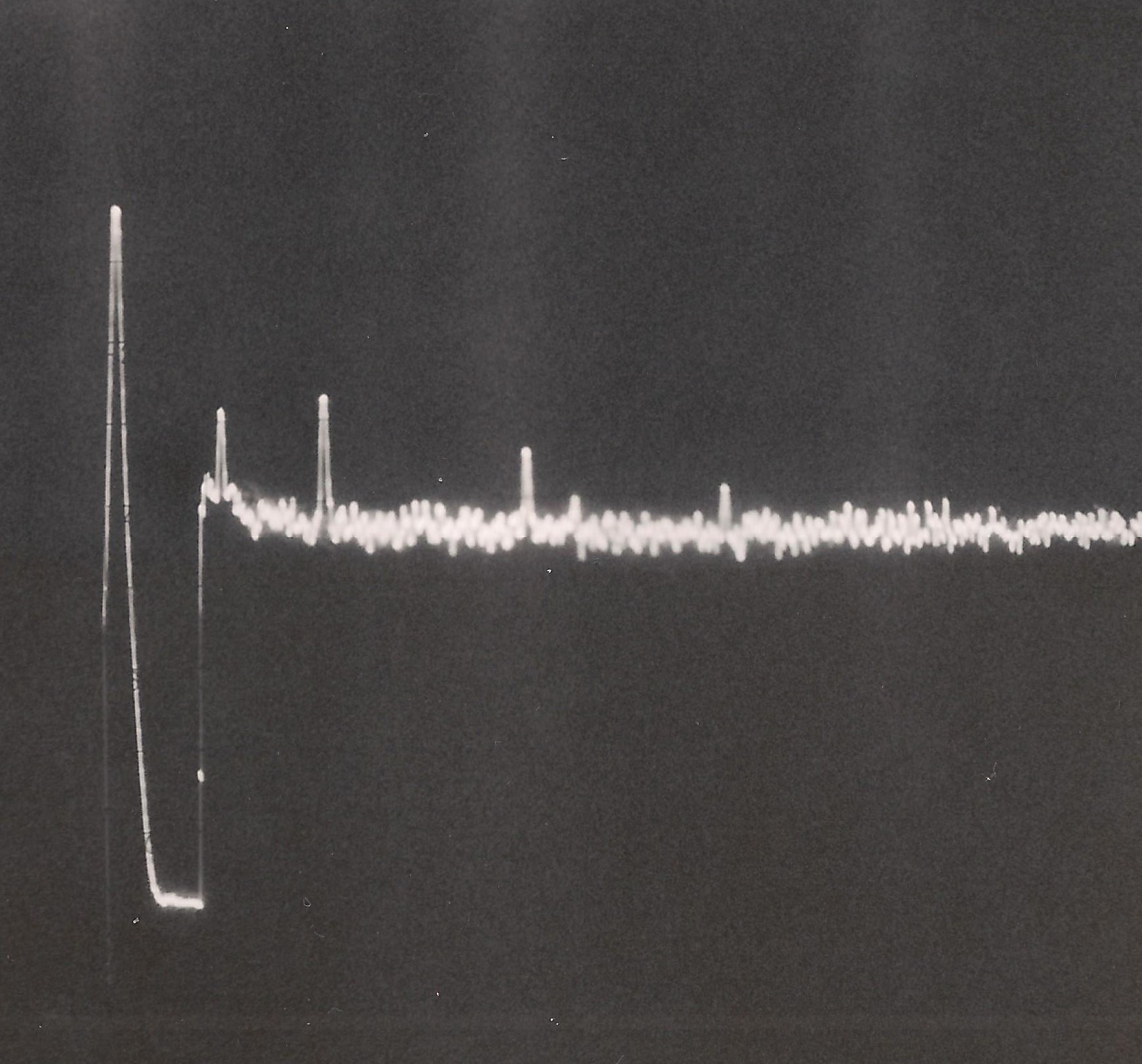

While you are working on designs for stablizing the amplitude on the new SVO, I tried another opamp for the oscillator; if compounding for higher openloop and greater feedback can be done to reduce thd, then a higher open loop gain single opamp would improve thd as well. That coupled with lower noise has worked on what are already ultra-low THD generators. The last one was the AD797.
This time I tried the LT1037 opamp for is extreamly high gains (+130dB) and rejection of CMode and is almost as quiet as AD797. The results are as I expected, even lower THD+N and the 2H and 3H are now at -138 and 136db respectfully. Noise floor is even lower, which is interesting. Now approaching what I guessed was -160dB for the AD725D... this opamp combo is at -155dB. THD+N = .00006% at 7v p-p/1KHz/100KHz BW. The newest A-P is between .00003 and .00005%.
[This is from the KH-4402B. Only a slight touch-up of the AVC pot was needed.]
Darn near my goal of -140dB THD+N 🙂
Thx-RNMarsh

HOWEVER --- at 10KHz the THD+N is a little higher than with the AD797. So I feel that the need for a compound opamp is what is needed to get down to the -140 range up to at least 10KHz.
