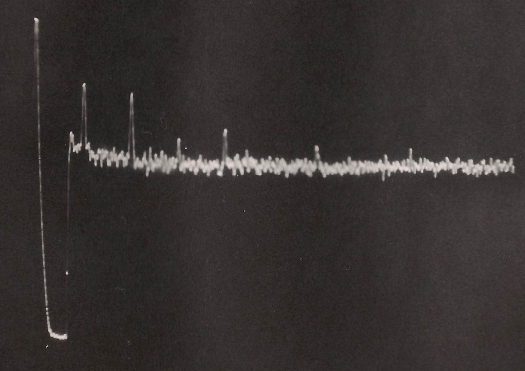

Well I recieved the AD797 today and went direct to the KH4402B and yanked the LT1468 and put the AD in its place as the oscillator. yes, i added the 50pf.
Here is the result in a nut shell --> The noise dropped about 6dB and the THD+N dropped 3-4 dB's from 1KHz to 10Khz. Not a huge change but I'll take it. The oscillator THD+N is .00009- .0001% at 1KHz and .00015% at 10Khz from the direct out from the oscillator port (7v rms). Adjust the 10-turn AVC trim pot (R145) for lowest THD at 10Khz.
The lowered noise floor is now showing me junk I had not seen before (like ps harmonics so i beefed up the filtering on the ps) and allows me to see the individual harmonics better.

AD797 osc for KH4402B -
here is what the opamp change produced -->
The noise is lower as compared to previous plots I've shown and the higher harmonics are uncovered. The ref level peak on the left is -110dB. The 2H and 3H are about a little more than 20dB below reference. The higher harmonics are more than -140dB. The noise floor shown is at -145dB. [1KHz 7v p-p; 400Hz and 100KHz filter In]

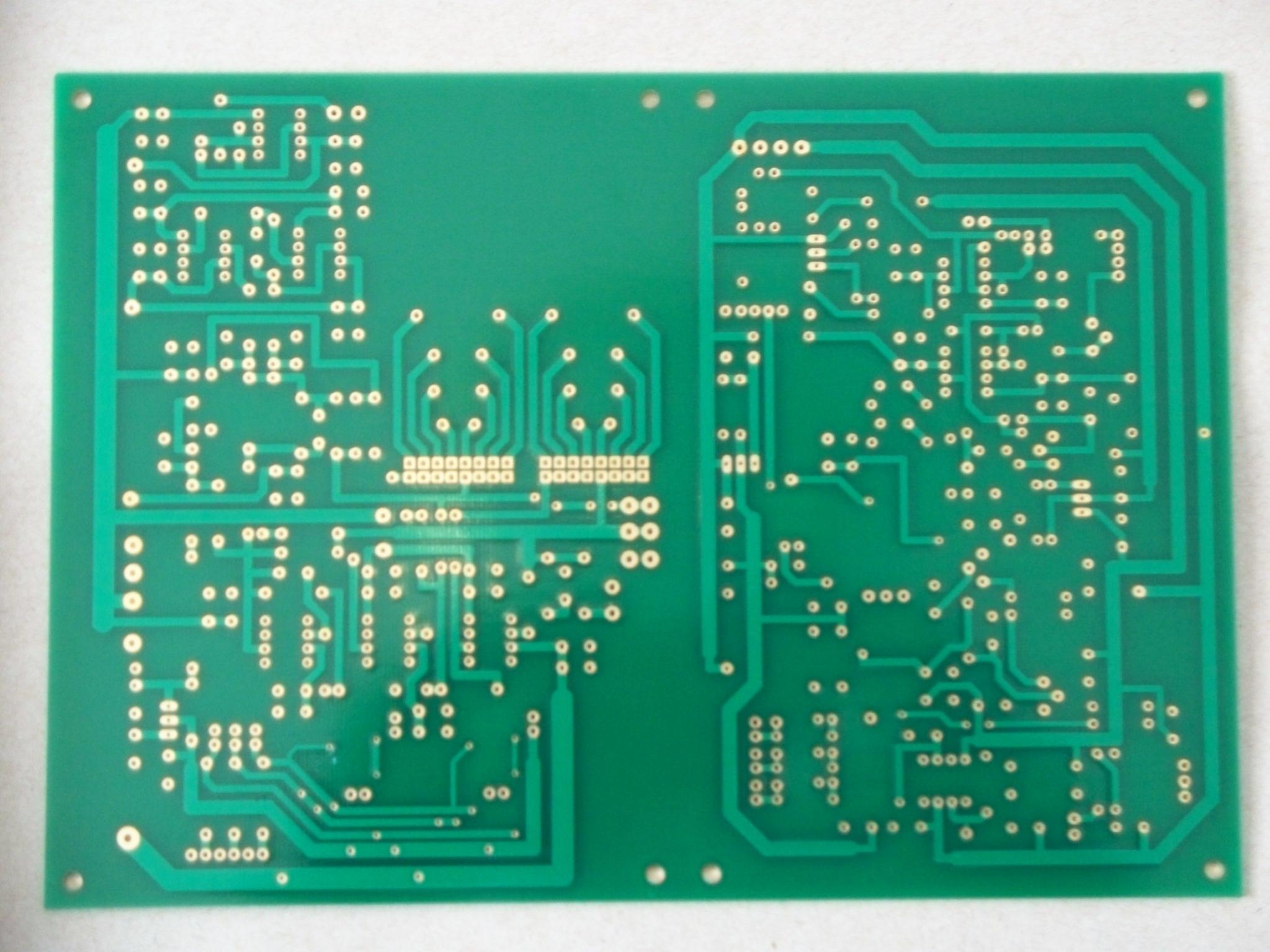

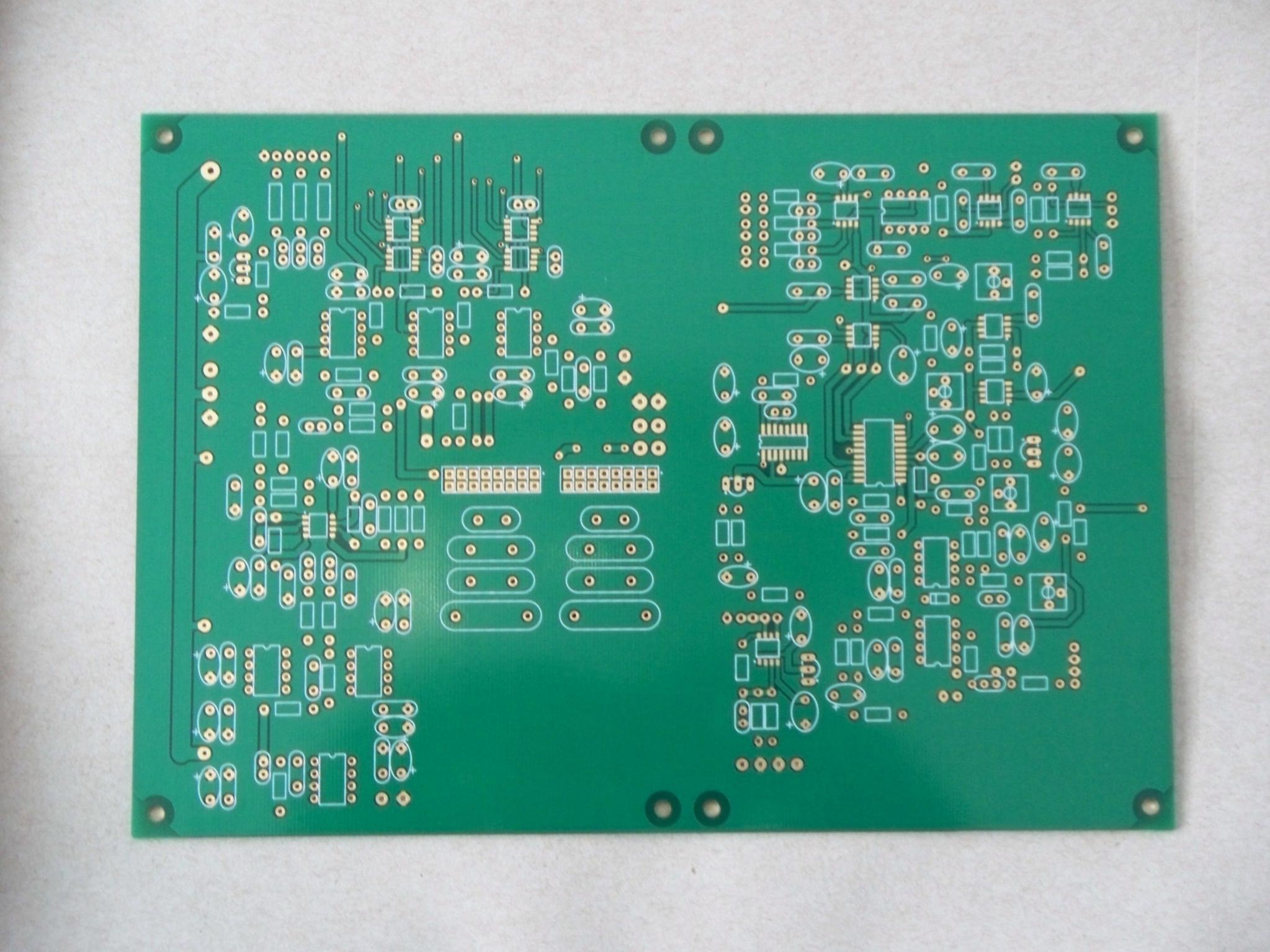

SVO boards
My long awaited PCBs have arrived from China.
These are development boards for my SVO design.
I panelized them to save on setup charges.

Thanks for posting the picture of the PCB. I can appreciate the effort involved in the design. I am interested in how the frequency range switching is achieved. I can see what looks like pads for the connections in the middle of the PCB so would like to see pictures of the assembled board.My long awaited PCBs have arrived from China.
Now I have a back log of projects to catch up on since all the boards I ordered have arrived at once from various parts of the world.
