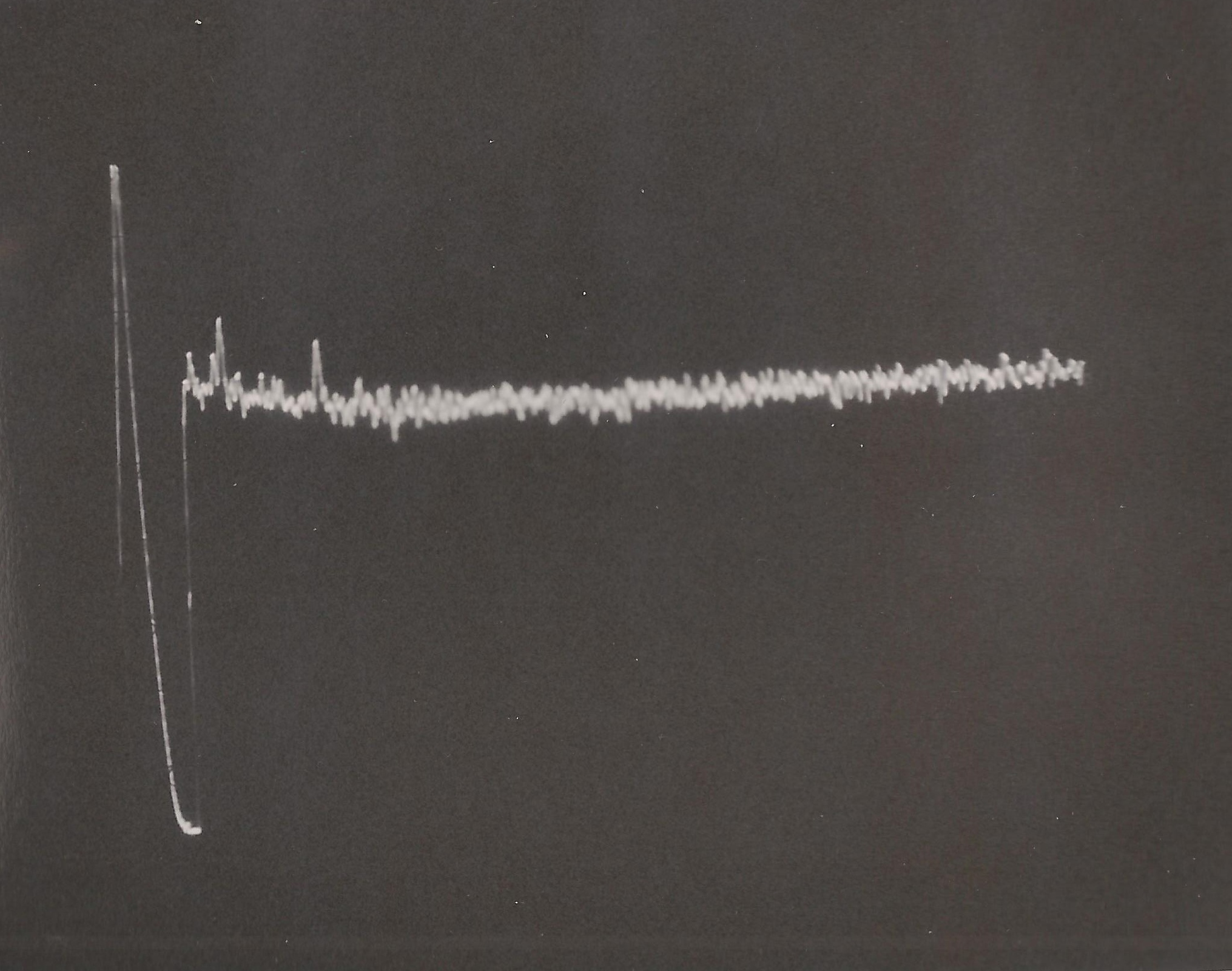

The 2h is -122 and 3h is -124dB at 1v/1KHz into 600 Ohms. KH4402B noise floor is -130dB. 100KHz BW. [Ref 1KHz amplitude is -110/10dB/div]

Seems I cant add numbers today.... Full Scale of -110db =1 v output from monitor port and another -22-24dB would be -132 and -134dB. It's noise floor is about -140 -145dB. Very close to my lower limit of testing. Got to work on that 🙂

I think it is safe to say now that the Harmonic levels shown by Demian of the harmonics of his ShibaSoku generator is actually that of the ADC system.
The 2H and 3h are running at .00003% or less (noise) from the AD725D analyzer display reading. Right down there with Viktor's levels.... you can use his generator to gauge the ADC system accuracy.
