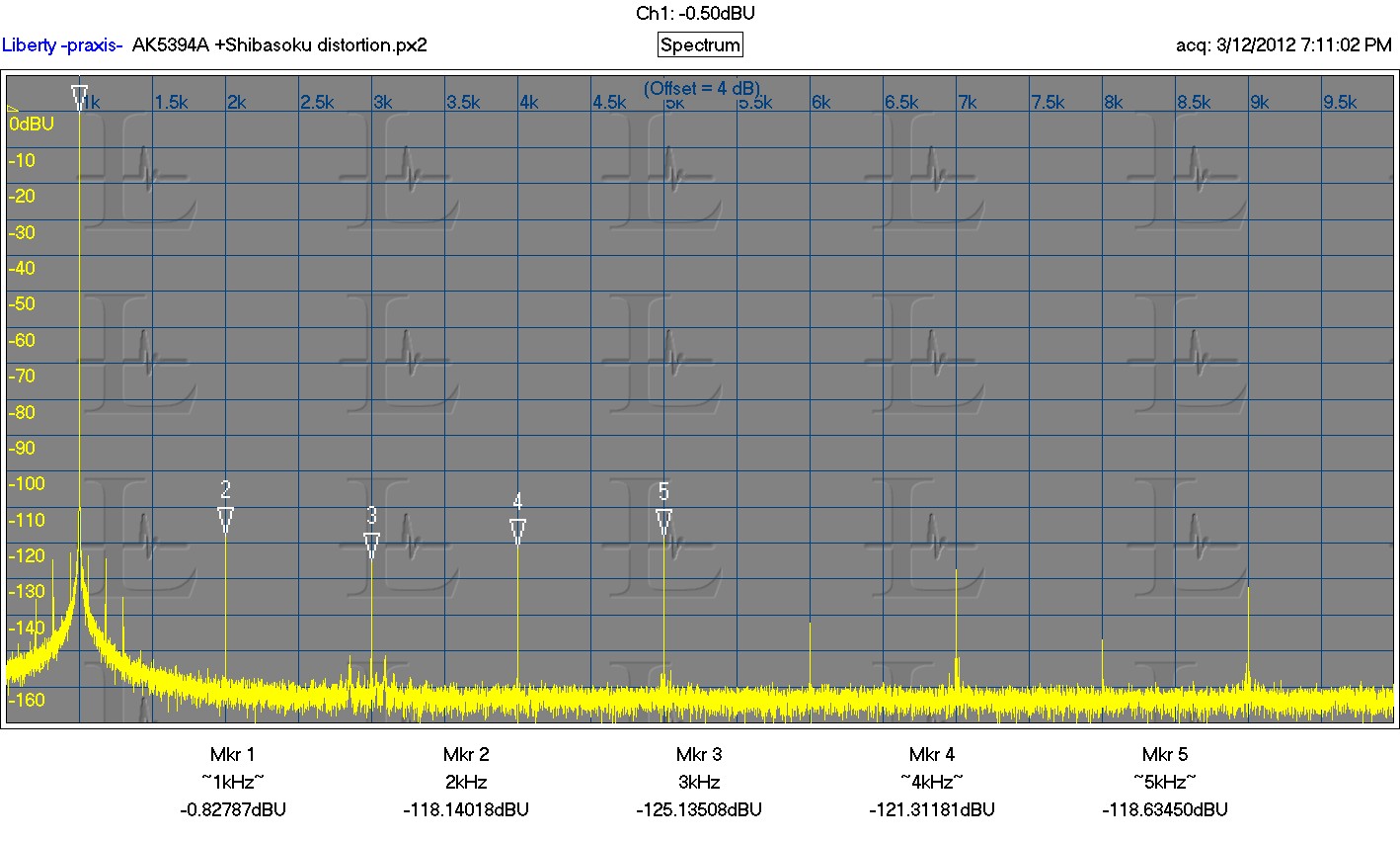

Hi Bob,
I think the spec is with a 600 ohm load and at a higher voltage than what Rick is using.
From what I gathered it is 5Vrms @ 600 ohm, 0.0005% THD.
Here is a measurement of the AG16 (My other, older version has the same performance, just no GPIB interface). The limit is the AK5394a in this case.
The spec is THD+noise. A quick trip to an online calculator shows the resistive noise floor of 300 Ohms (600 source and 600 termination) to be -128.367 dBV or .4 uV in a 30 KHz band. It becomes the limit for a broadband measurement.
I think this is characteristic Japanese instrument understatement.

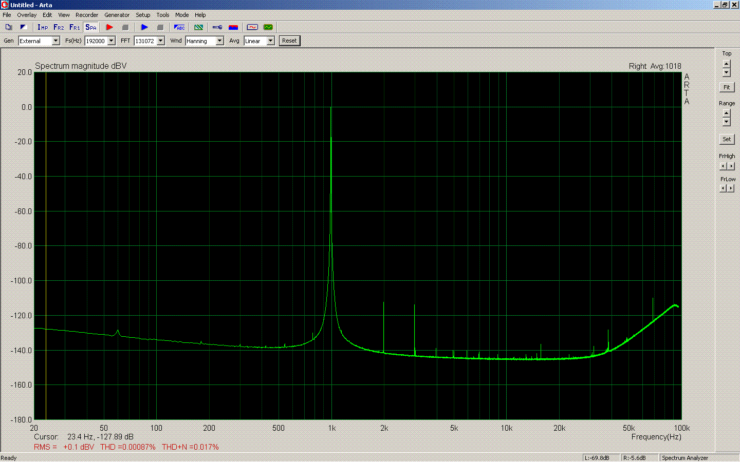

I think the EMU0202 uses a Crystal DAC and ADC. I have one and an 0404. The 0404 is better (it uses the AK5394a) but the implementation doesn't meet the same performance that the demo board does. Getting it all working was a chore as well, the drivers did not work as expected and it seems to be discontinued.
