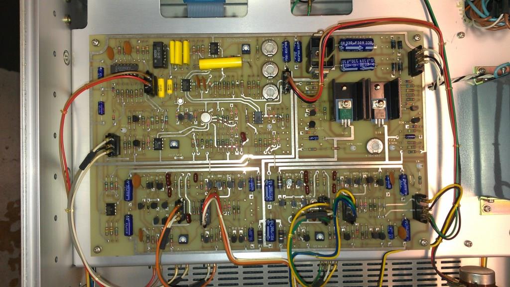

I pulled my other Shibasoku oscillator, 590AR, from storage and took a photo of its insides. This is the top view. The bottom has the frequency and level networks. Both this the AG15 and AG16 are remote controllable. This older one uses a parallel interface, the newer ones GPIB, otherwise they are identical.
There are several opamps, all TL07X types. There is also an LM710CH (The can) and an MC1495. I suspect the AGC uses the small metal can device 2SK15 (??). The tree trimmers are +1 dB, 0 dB and -1 dB for some function. My guess would be a steering for the AGC so the active part doesn't need much range to stabilize it. The supplies are +/-30V.

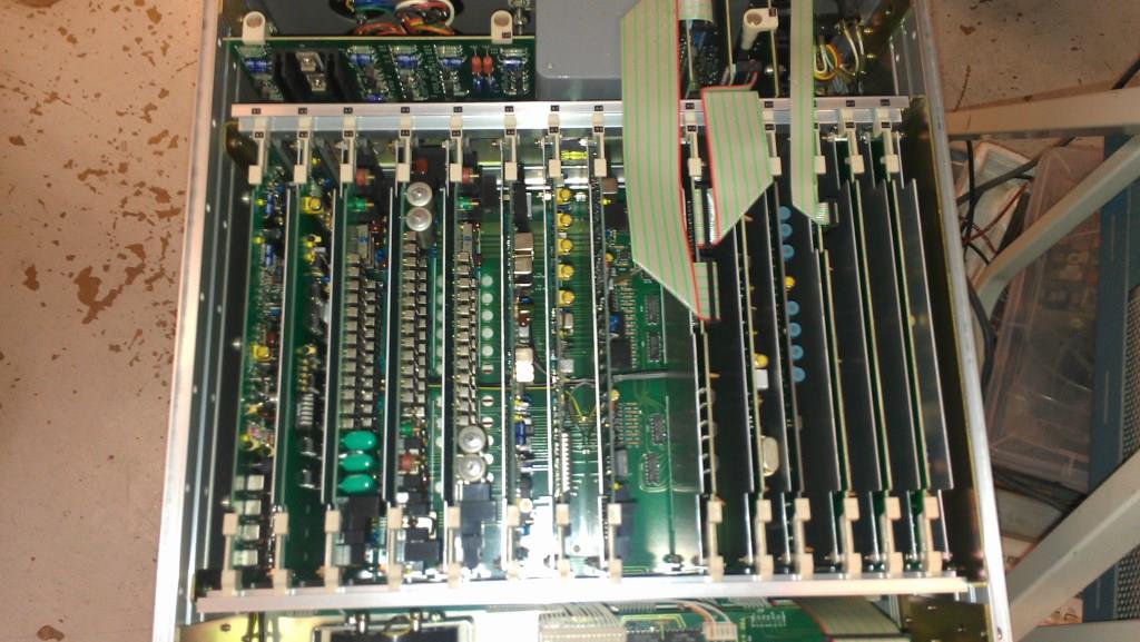

Shibasoku 725 insides

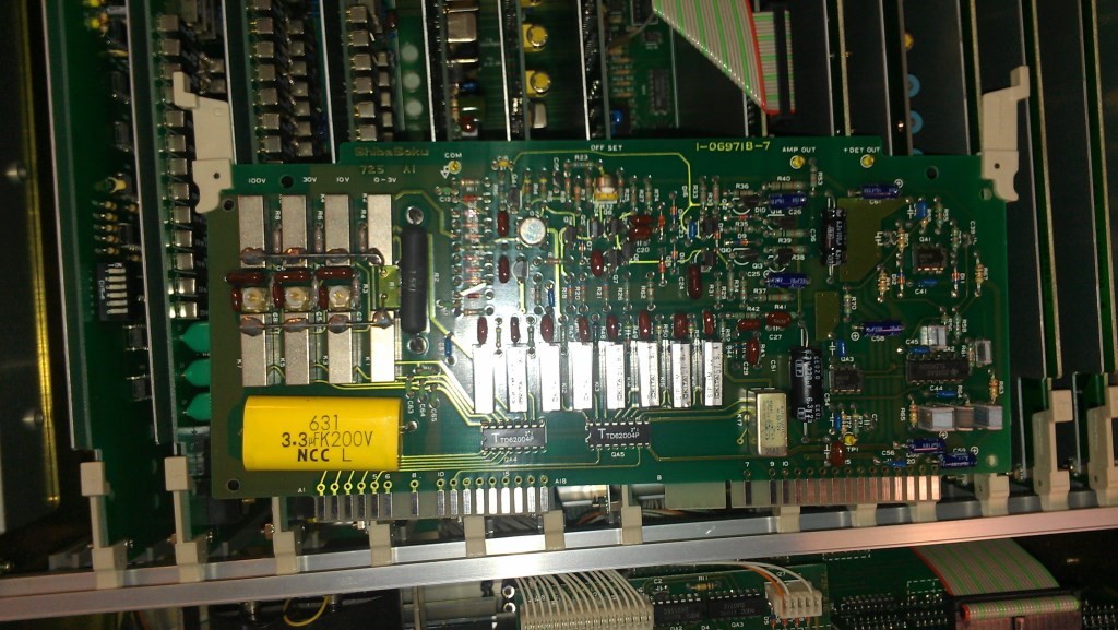

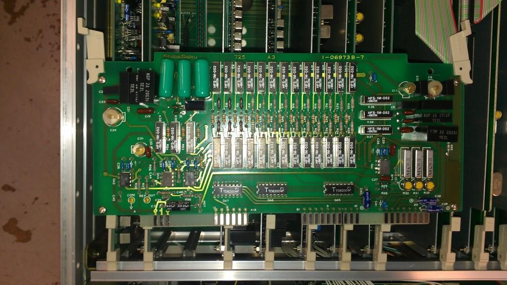

And here is why you won't want to duplicate this thing.
There are a jillion PCB's and each have a bazillion relays. When Richard gets the manual calibration should be simple since the key nodes and adjustments are clearly marked in good English.
The detector board is actually the input board. The device in the middle is a dual Jfet I think. The relays handle the input attenuation.
Design was an enormous undertaking but its still in the lineup 30 years later.

Considering all the board artwork was done by hand too.
It appears the oscillator(s) are all descrete transistors design.

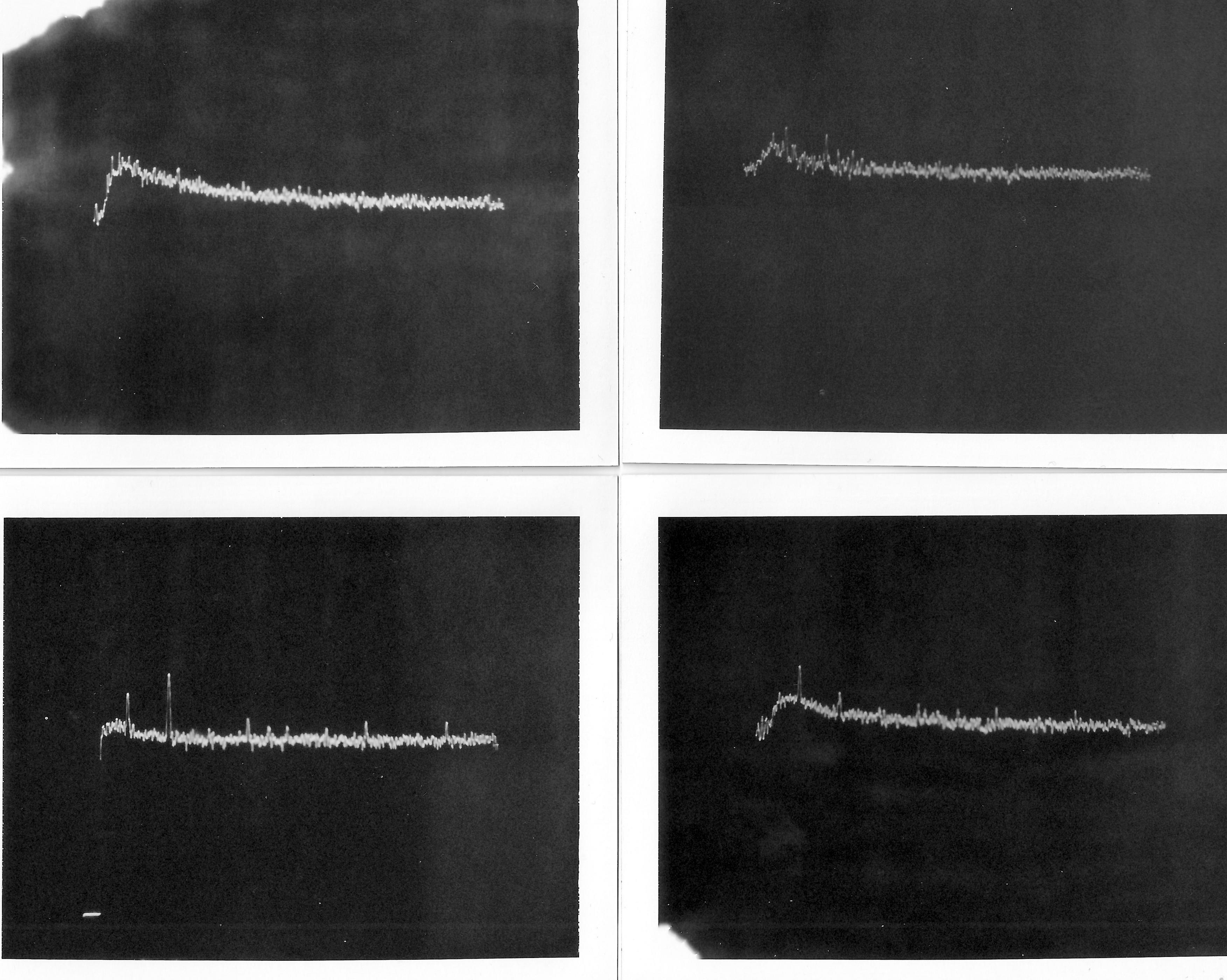

Attached are some harmonic pictures of 4 ultra-low distortion oscillators. The noise from the oscillators is between 140-150dB (no averaging used -- eg FFT). The ShibaSoku 725 notch shows itself at -155-160dB. All Harmonics are below -130, worst case harmonics. Typically -140 or more. The AG16 looks like it has higher harmonics but its just the noise floor is 10dB lowe than the others... and fairly flat (not rising at lower freq end).
Top left is Viktor's 1Khz, Top right KH 4402B, Bottom left is HP 339A, and bottom right is AG16. All excellent. However the HP339A cannot keep its lowest thd at other freqs as well as the others without individual fine tuning.... Thx-RNMarsh
