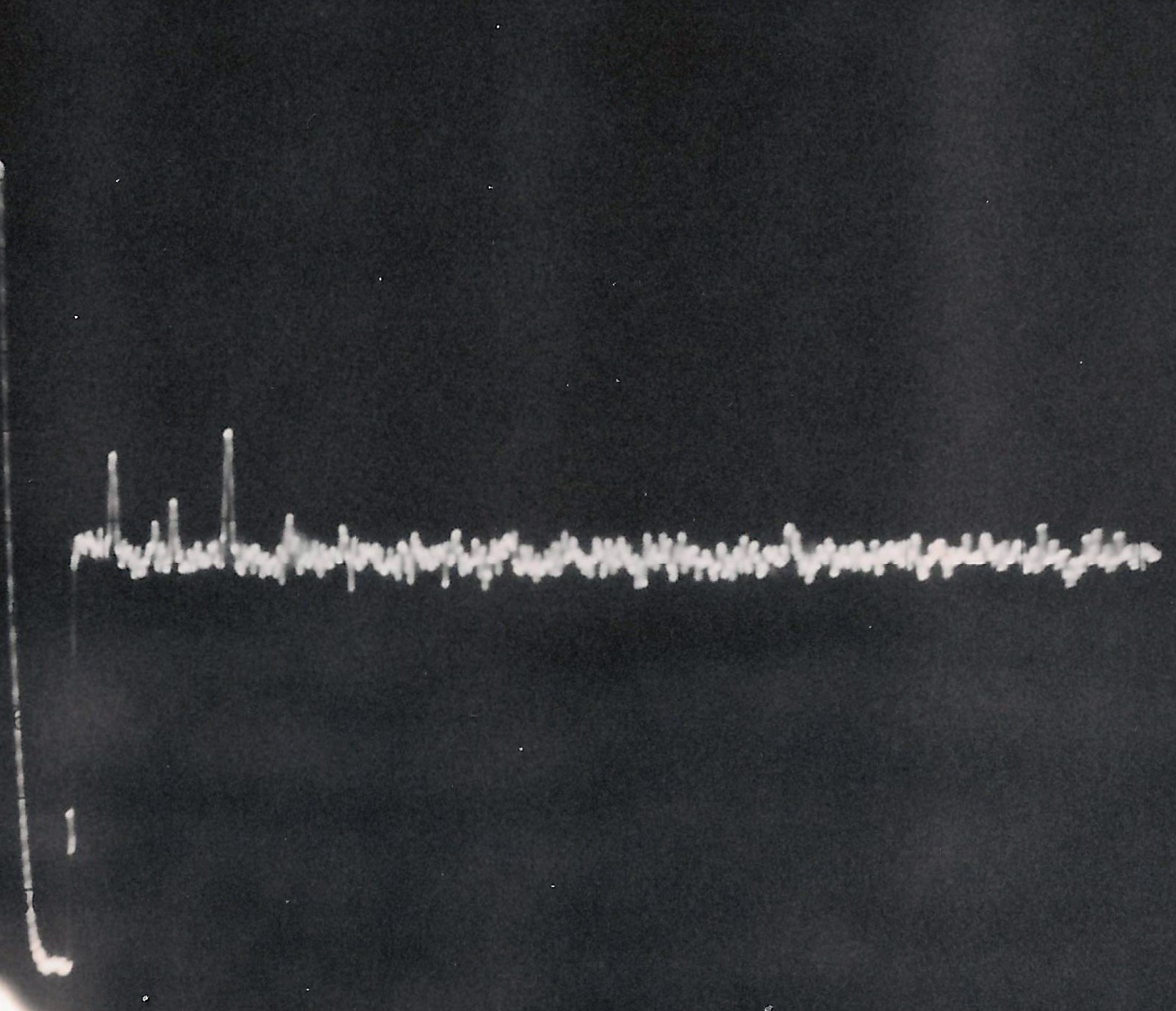

The drift on the newer ShibaSohu is much lower than the old one as I dont see such levels of change as Demians old model (he owns both but I have his newer one). The ShibaSoku (new) looks like it has some digital artifacts in it... a clue to its generation, perhaps, and why it is so stable. Note: Also, the KH4402B drifts a little and heat seems to be the issue inside which affects the bipolar output devices characterists ....
See attached of 1KHz/1v spectrum --> [The thd is about the same as the modified KH4402B at 1/10 the cost]
Thx-RNMarsh

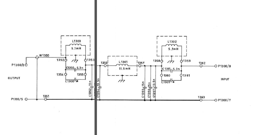

You suggested to me last year an elliptically tuned filter can theoretically completely null the 2nd H or maybe it was the 3rd H. Exotic filter tuning might be a better approach than distortion cancellation.
However an active filter has distortion from the active elements and noise. A passive filter can do it. The one in my CLT-1 does a fine job. The inductors are the size of softballs made from some ferrite cup cores. Attached is the low pass filter that removes the remaining harmonics to get the 3rd harmonic below -160dB. It is capable of passing 2W undistorted. This is not tuneable however.
I know that removing the computer causes the distortion to drop. I have not dug into why, it most likely is some EMI affecting the analyzer or maybe the oscillator. it seems related to connecting the QA400 USB connection. It may even be the DC-DC converter in the interface board. Thats a chore for later.
At this level its very tedious to find. I'll explore further when I have time. My point is that these systems are very delicately balanced to get the performance.
"My point is that these systems are very delicately balanced to get the performance."
Indeed.
A lowPass with a sharp cutoff and null at 2H and 3H ?
None of these -- other than all passive filtering (which we can sim to see the filter response) --- offer anything but brute force approach. Thats why we need a more clever approach -- A cancellation circuit or the DDS is good as it is very stable with XtL osc. As with dithering to remove harmonics/artifacts.
More along these lines and less of the same as has been done or we'll get the same results as has been done. A new way -- not for low distortion -- for No harmonics above noise. It isnt going to happen by the means already tried.
-RNM
I think the idea is to tune the SVO filter to an elliptic response. Not an add-on filter.
