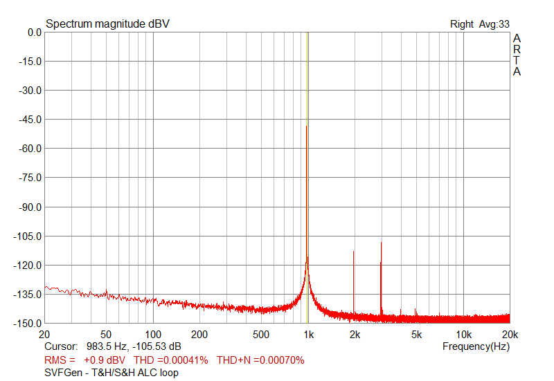

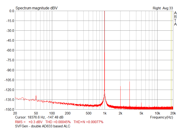

Just to clarify my previous post - I've attached couple of spectra from two of my low THD generator prototypes: the first one is based on a SVF ring of NE5534s, a T&H/S&H peak detector and a low cost analog multiplier (AD633) as level controlling element; the second one is a SVF ring too, but with venerable LM318s in place of NE5534s, a 4-phase peak detector and a couple of paralleled AD633 as level controller. Both generators are equipped with integrating ALC loop, and employs 5-10% red WIMA pp boxes (FKP) as timing capacitors. As you can see, both generator outperform the simple APF generator shown in the first post; they have lower THD, lower THD+N, and far better sideband performances. LM318 are definitely not known as ultra low thd opamps, still they are capable of remarkable performances - THD figures are probably entirely due to the EMU0204 used to capture the spectra: both generators are in 0.0001% (-120dBc) range or better - my notch says something near 0.00003% @1kHz, 20Vpp out.
The simple APF generator is very far from these figures, so building it with cost-no object parts doesn't make too much sense, IMHO.

I'm confused. Is the one I want to build an SVF type or something else? I don't even understand the abbreviation "APF" (all pass filter?).
if you want low THD, it's tough to go wrong with a SVF (State Variable Filter) based oscillator.
there are comments elsewhere on the board regarding cordell's oscillator from his distortion analyzer from years ago. it's still a good one.

I thought that I would revive this thread because I now have a PCB up and running using the Texas Instruments / National Semiconductor LME49990 in a phase shift based circuit.
The sample and hold amplitude circuit works OK after I had some fun with the control loop. I didn't find it easy to get the loop to behave over the Oscillator frequency range of 10 Hz to 100 kHz.
The gain control works OK with the multiplier output attenuated by 100 which minimizes the noise contribution.
I am now at the distortion measurement stage. Performance is OK at low frequency 0.002 % at 100 Hz, 250 Hz and 1 kHz. But distortion rises rapidly when the frequency is increased above that, 0.003 % at 2.5 kHz. 0.01 % at 10 kHz and 0.04 % at 25 kHz.
It appears that the main problem is the Distortion Analyzer but it isn't easy to modify it the way I 'designed' and constructed it with capacitors soldered directly between the back of the rotary switches and the PCB relying on the case to hold them apart.
