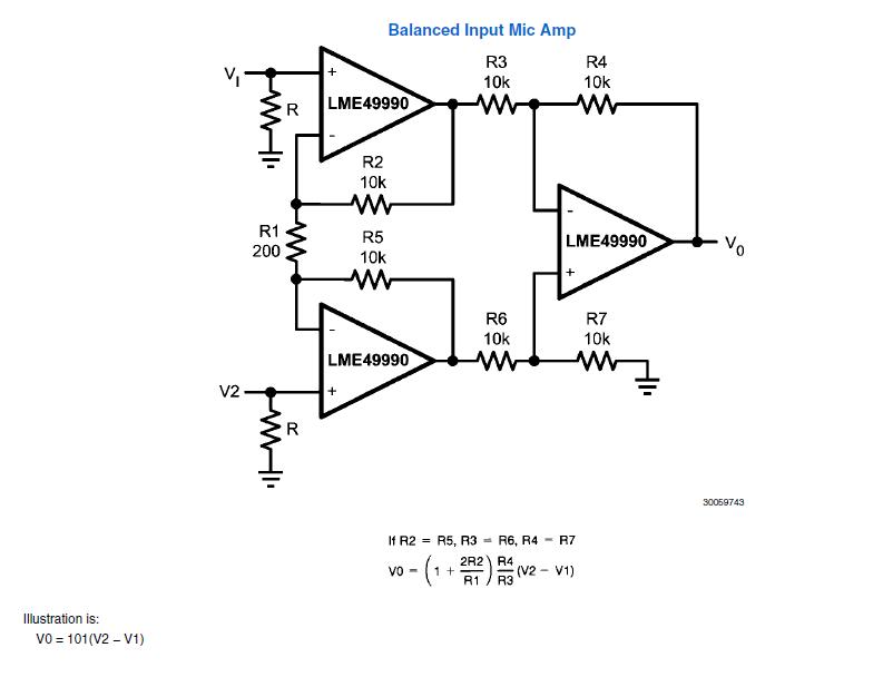

I have an idea for making a distortion analyzer. It's not an entirely new idea though. I'm still reading about different techniques for measuring distortion. My idea, which came to me out of the blue, is to use a differential amplifier with really high CMRR and extremely low distortion as a difference amplifier. The oscillator output goes to one input and the output from the device under test goes to the other input after going through an attenuator. The DUT has to be non-inverting for this to work, and the phase error has to be nill as well. Basically, if you feed a common mode signal to a differential amplifier, what's left at the output is the junk that's the difference.
The problem that I see with the typical notch filter type of distortion analyzer is that amplifiers under test don't just amplify and distort the fundamental frequency from the oscillator, they also amplifier and distort every harmonic that the oscillator produces, as well as the noise and IM products. So, the output of the DUT becomes a mess of harmonics, noise and IM products that you can't separate out with a notch filter.
Anyway, I'm still working with this idea and it's clear to me that in order for my device to work I need a very low distortion oscillator and a differential amp with crazy high CMRR and vanishingly low distortion. The LME49990 seems to fit the bill so far. CMRR is 137 dB and distortion is 0.00001%.

Not just the distortion but the noise as well. Generally the noise becomes the limiting factor with the notch method. But if you whan to analyze an oscillator one has to use a notch filter. The null method depends on having a DUT in the loop.

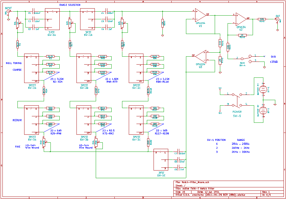

Yeah, I didn't think about how I was going to measure the distortion of the oscillator. I can't think of another way to do it right now without a notch filter.
Here's a more sophisticated one from this blog:
Active Twin-T filter
Here's his thread about this:
http://www.diyaudio.com/forums/equi...-twin-t-notch-filter-distortion-analysis.html
and here is the lazy man's design tool for twin T notch filters:
http://sim.okawa-denshi.jp/en/TwinTCRkeisan.htm
I think for testing this oscillator, we only need a few frequencies for the notch filter, not a continuous range. Something like 20, 200, 2K, and 20KHz would be fine.

Here's a twin T filter with adjustable Q. Input on the left, output to the right.
If you haven't looked already. Check out Dick Moore's design of this filter.
Dick was good enough to lend me his TT will he's away from home.
he did an excellent job on it.
There a few things I would expand on it and I will comment on this later. But for i have to go to work.

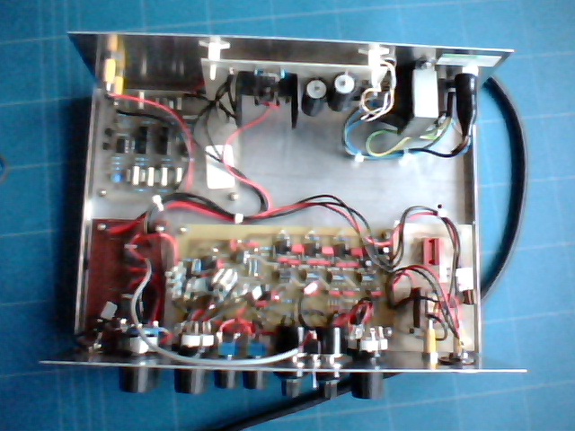

Hello,
To measure distortion I used a circuit based on Ian Hickman's design from Electronics World magazine, issue August 1999. It uses a notch filter similar to the Robert Cordell THD Analyzer described in the Audio magazine, 1981. I designed a PCB just to learn the CAD program VUTRAX and didn't do that good a job. I used various parts that I had lying around and added an input attenuator built from scrap and also an RMS to DC board made using a dalo pen about 30 years ago. The frequency ranges are limited to three, 100 Hz to 250 Hz, 1k to 2.5 kHz, 10 k to 25 kHz. It is a little touchy to tune but it was good enough to measure 0.004 % distortion and noise at 1 kHz on the Oscillator test circuit that I made.
I have attached a picture of the Distortion Measuring unit.
