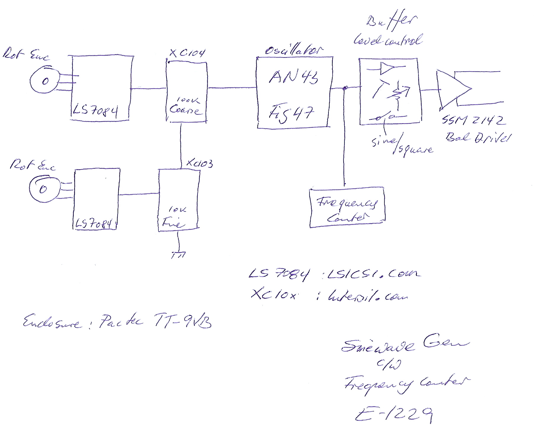

I am in the process of doing the board, along my lines (digital pot and seperate frequency display board). Obviosly that digipot can be replaced with an off-board dual-gang pot or switch. My concerns are the errors in the app note, not corrected by Linear in an addendum (fig 47/48 switched, pin-out of LT1010). A test circuit needs to be built to verify the design. Volunteers? E

I started this project for my own use a while back and it is designed with my needs/wants
The rotary encoder/digital pots can easily be replaced with one/two dual pots. The frequency counter is on a seperate pcb and can be omitted
The pcbs are designed to fit into a Pactec TT-9VB hanheld box. I yet have to work on the ps unit, propably a battery/wallwart combo
I am not really interested in a group-buy situation but will make the Gerber files and parts list availble
A sld of the thing is attached. E

Thanks. That's certainly an option. I guess I'm committed to building this one since I bought 3 of the $8+ LED/resistor things. I'll probably make it myself on perf board. I can't make circuit boards at all.
I was thinking of using a commercial digital frequency counter as the readout for this oscillator. They don't cost much I think.
dirk: where did you find the VTL5C10 or CLM410? These are obsoleted by ther mfgs. I found a VLT5C10 at Excelitas and a NSL-32B-101 or H-101 at Silonex. Either would do but I could not find a stocking distie for either. E
