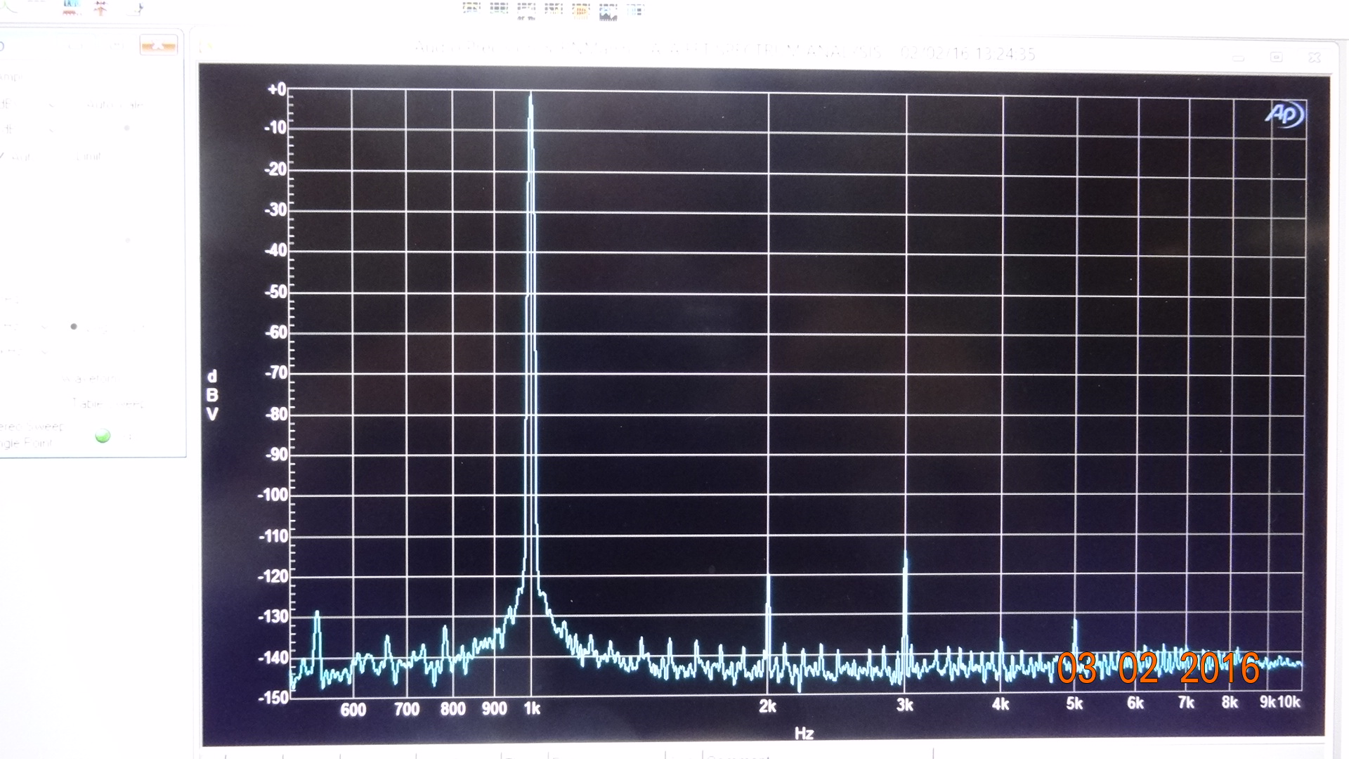

Well, thd level is not impressive, if considered w/o freq. spec.:
Sine Wave Frequency Range
High Resolution Mode 10 Hz to 20 kHz
High Bandwidth Mode 11.719 Hz to 79992.188 kHz
Sine Wave Frequency Resolution
High Resolution Mode 0.1 Hz
Should be a way to auto-zero-null-subtract and not have to manually tune for a minimum.

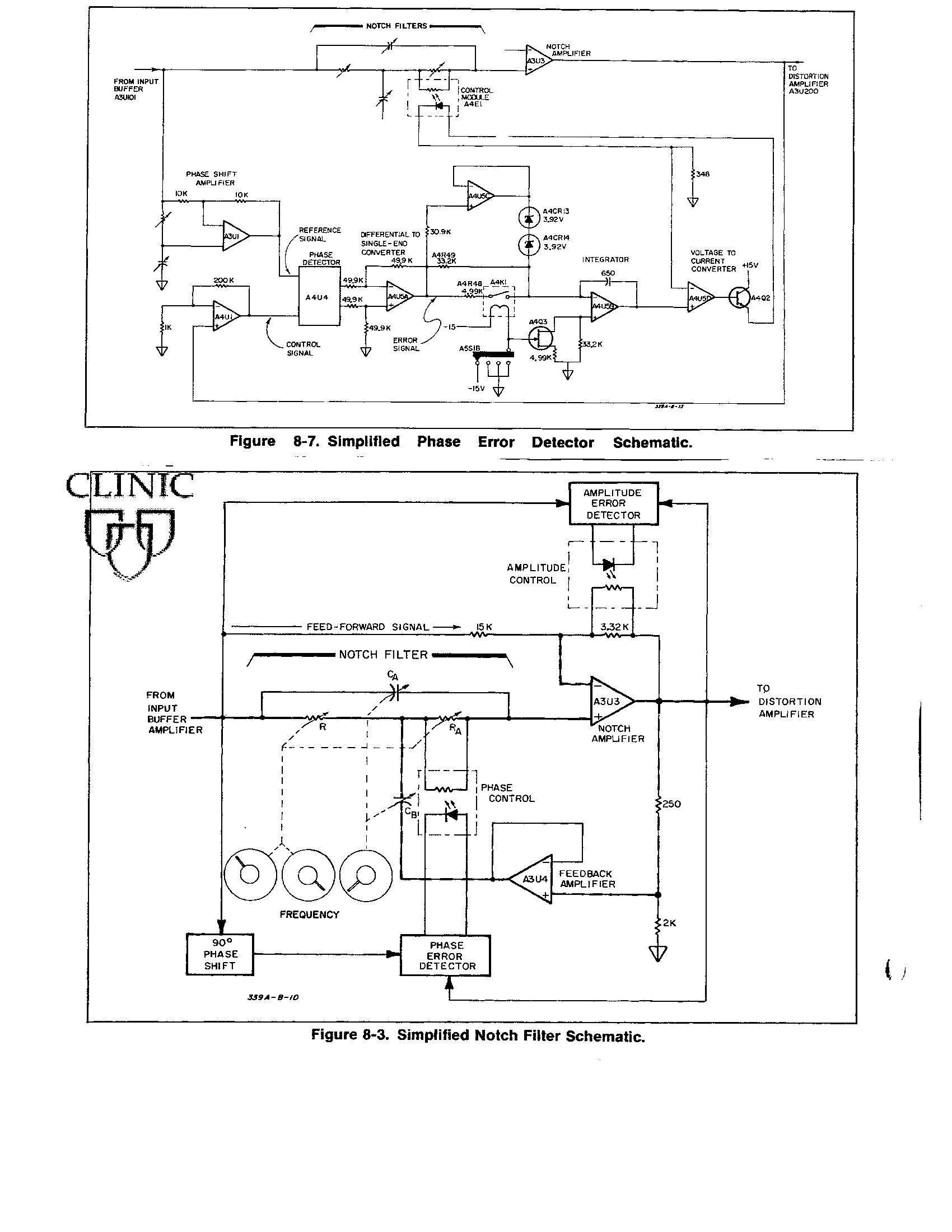

this might also help with generating some ideas....
null detector circuit - Google Search
-Richard
from HP 339A auto-null
View attachment auto-null.pdf
-RNM
Joined 2004
Unfortunately the only relevant reference is the auto-null for the HP. This problem is similar but not the same. The other references are not that helpful.
Because this deals with both phase and amplitude you do need a sine/cosine decoder to even know which parameter to adjust. You could lift the circuit from the HP 339A or even the 333/334. Probably would need some manual range controls. Or a raspberry PI and some software.

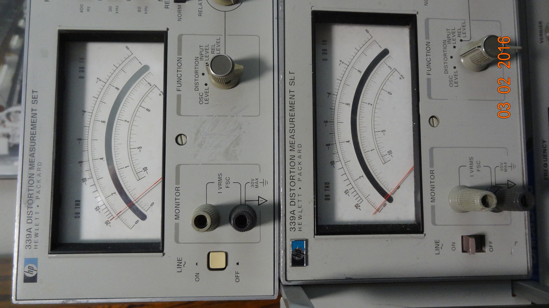

Many of the circuits are just there for spurring new ideas.
The HP339A is an exact app. which could be lifted and mod values to fit the Cordell values. The LDR would be a challenge to find??
The 339A can be copied as well.... with simple changes... the internal osc can be easily improved and the analyzer part as welll without changing circuitry/topology. Or just use the analyzer portion only;
stock and mod;
Not SOTA but easy to do for THD+N meter (-120dbv.... better with a Victor osc)

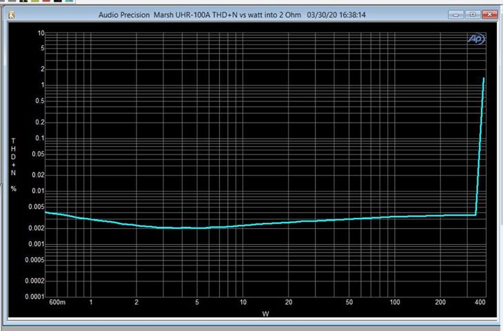

Damir,
I changed the amp to mono.... lowered the rail voltage and increased the idle current..... +/-35vdc @ 5A total for 24 devices.
Tests for max power output level is, for example (THD+N)/ 2 Ohm ---
Had to fix a HF osc..... RC at each FET.....
Over-all improved SOA.
