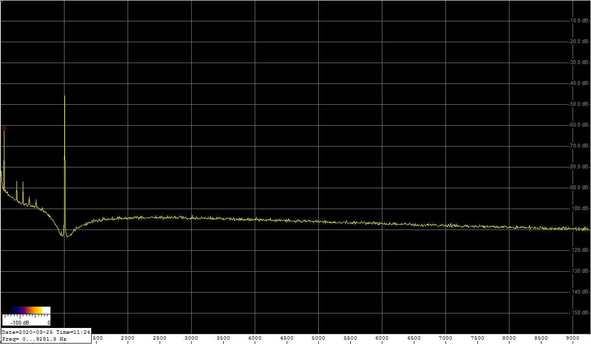

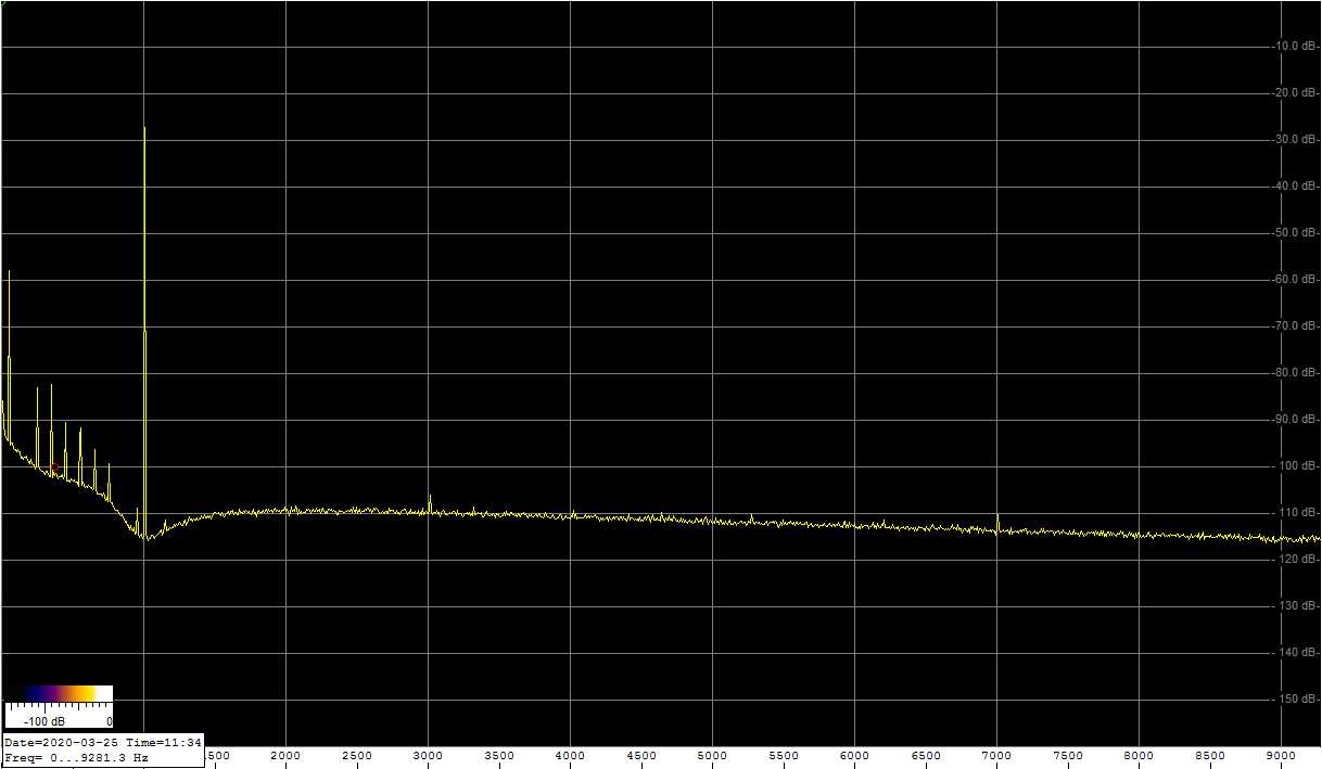

New set of results for the concept "LP filter at the output of an oscillator".
The details of the setup are here:
Low-distortion Audio-range Oscillator
so I'm only presenting the changes.

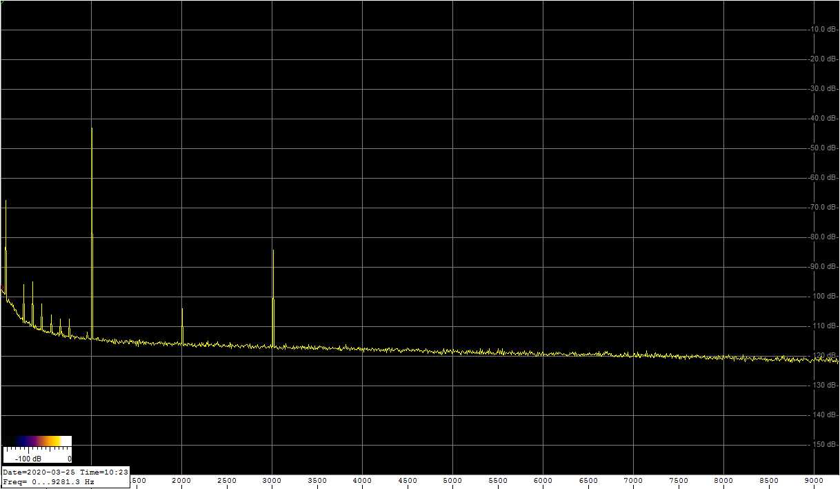

First I tweaked the oscillator to the performance I once had - compared to the starting position from the above link, the 3rd is now almost 30dB lower, in absolute terms at about -132dBc (osc. output level of 2.5Vrms, or -6dBFS for my sound card), the 2nd is lower by 15dB, or -148dBc (first attachment).
The notch depth was about -90dBc in all measurements, and this time I used Samuel's LNA from Lin. Audio Vol. 3.
The 2nd att. shows the spectrum at the output of the LP filter mentioned earlier, using LME49710. The filter added some 8dB to the noise floor, the 2nd oscillator harmonic is now below the noise floor, and the 3rd is attenuated by more than 20dB, as the filter calculation predicted. So the 3rd is now well below -150dBc.
The 3rd att. shows the spectrum with the G&P composite op-amp in the filter. The noise floor is now higher by another 6dB, and the 3rd harmonic is barely visible.

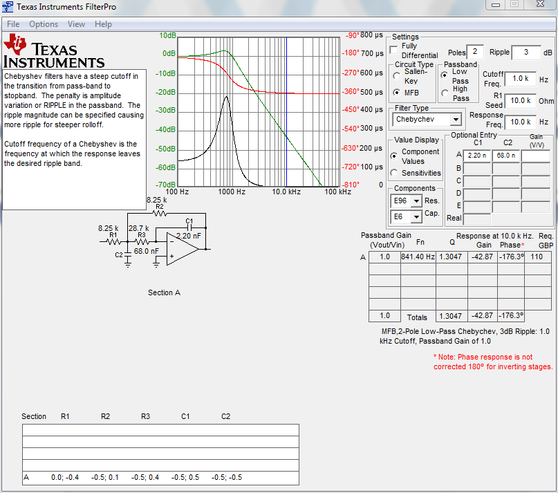

I checked the performance of the filter theoretically and with LtSpice, and found the Bonello's THD penalty of about 13dB. Apparently, both 49710 and the G&P composite op-amp can accommodate this THD increase.
So it seems that a properly tweaked, cheap SVO filter augmented by an LP filter can offer respectable performance.
Braca
https://www.diyaudio.com/forums/equipment-and-tools/205304-low-distortion-audio-range-oscillator-852.html#post6128729
The first spectrum shows the oscillator harmonics in the as-is version, and on the second one (LP filter in) the 2nd is lower by 14dB, and the 3rd by 17dB. Although it seems that the filter potential of 21db attenuation at the 3rd has not been fully realized, it is also the level where the THD of my audio interface comes into play.
It seems to me, there is a mistake in math. 2-nd order LPF couldn't att. thd-2 by 14dB, likely 9dB for Butterworth and ~10dB with more aggressive Chebyshev. Error comes from measurement thd-2 w/o accounting att. of fundamental. In this test what is important, to keep magnitude of primary tone constant when LPF introduced in the circuits, and some gain adjustment has to be done to estimate thd-n reduction by LPF correctly.
Thank you for analyzing and commenting my results.
A Chebyshev MFB filter with 3dB ripple in the passband can attenuate the 2nd by almost 14dB, the 3rd by at least 22dB.
The signal level at the oscillator output changes by less than 10mV when switching from the LP to the notch filter (rechecked in the current setup).
