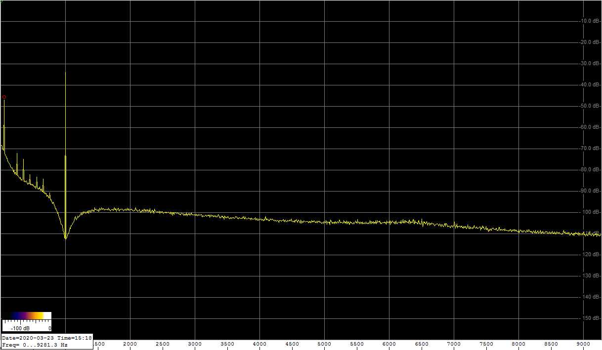

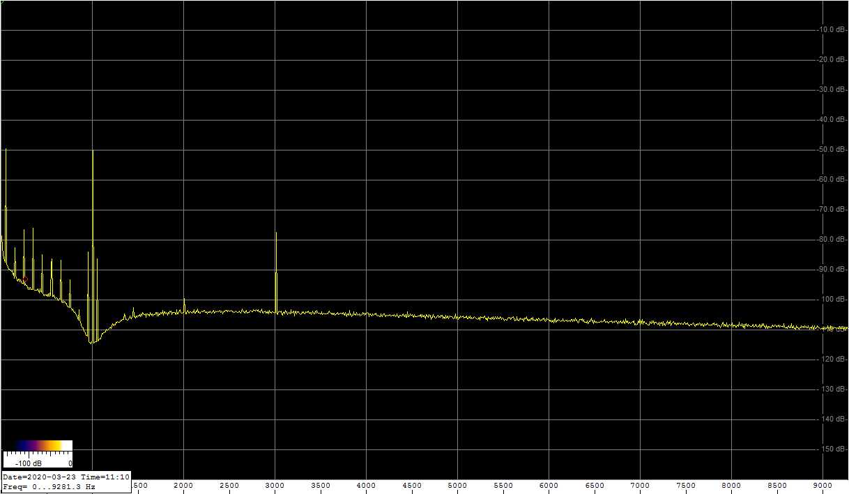

Spectra comparing LME49710 and the G&P composite op-amp in the LP filter: practically the same results in terms of the harmonics, the 49710 has a somewhat lower noise floor. The 7kHz spur in the latter spectrum is an interference I'm sometimes getting with this setup, it wasn't present in the unfiltered spectrum.
It appears that in the case of a low-order filter (2nd order in this case), a premium op-amp would be sufficient.

The notch is standard, -10dB at the 2nd, -6dB at the 3rd.
Since I've only exchanged the op-amps, and before each reading adjusted the notch for the best possible attenuation of the fundamental, the comparison of the op-amps is direct.
Passing the output of the Victor's oscillator through the filter, I only get the noise floor of the entire system. The latter is now higher by some 10dB than in the case of 4970 in the filter, which can be explained by the difference between the output impedances between the Victor's and my SVO (600 vs. 100 Ohm).

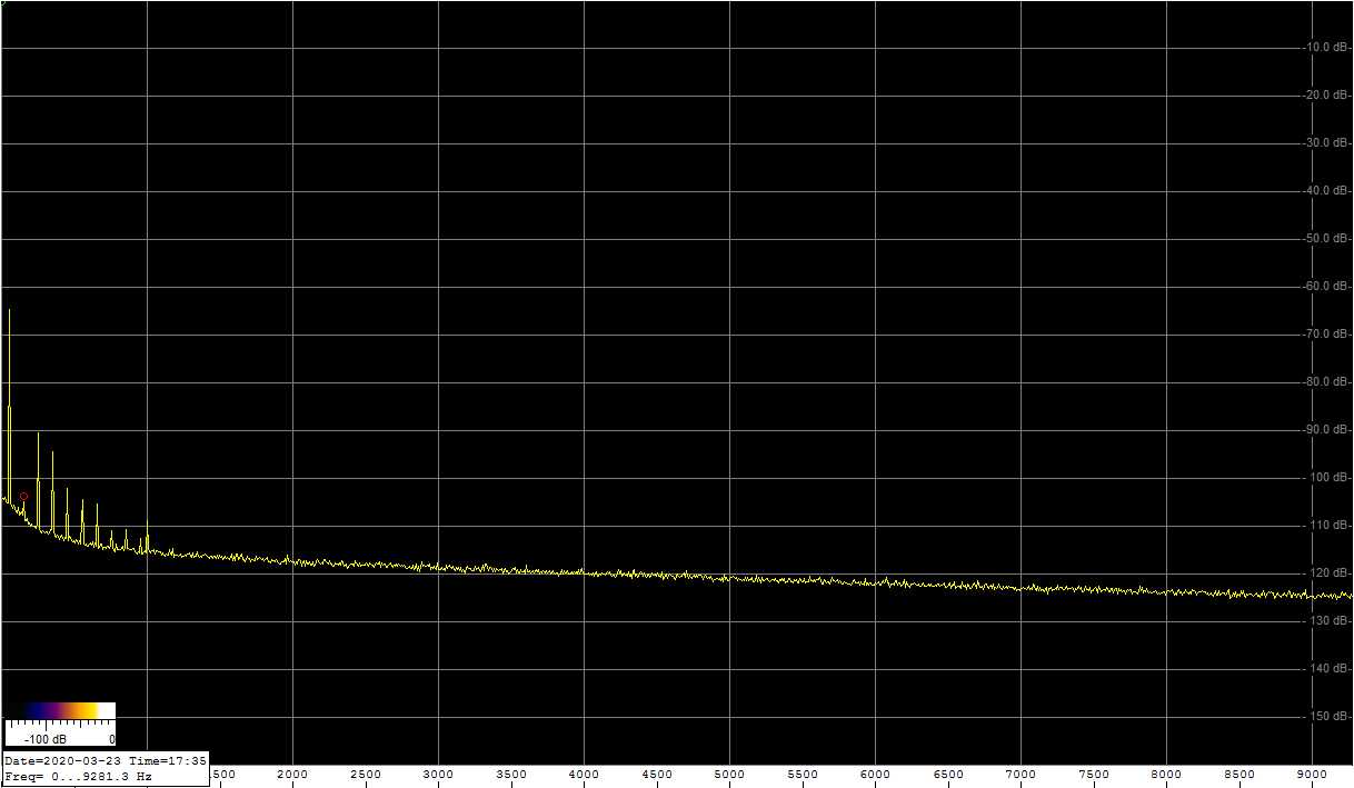

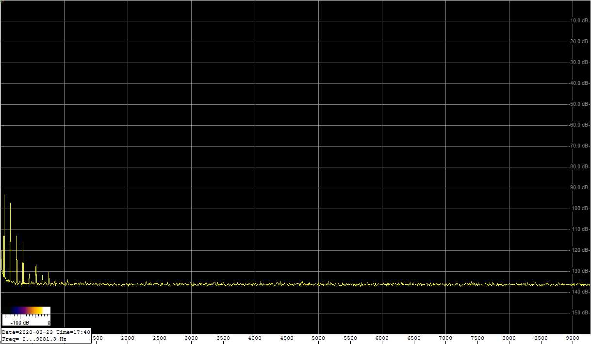

The noise floor of my measurement system is actually lower.
Starting with the LNA only (terminated with a 50 Ohm resistor at the input) attached to the sound card, the noise floor is about -137dB@5kHz (acq. rate 48kHz, Flat top window), s. first plot.
With the notch filter ahead of the LNA, also terminated with a 50 Ohm resistor at the input, the noise floor is -122db@5kHz (second plot). The reason for the 15dB jump is the impedance of the notch filter with its series resistance of 120 kOhm. I'm preparing a new one, which will reduce the noise floor by some 7dB, and thus bring it in line with the Twin-T filters shown in this thread.
Anything above -122dB is a contribution of the DUT's.
