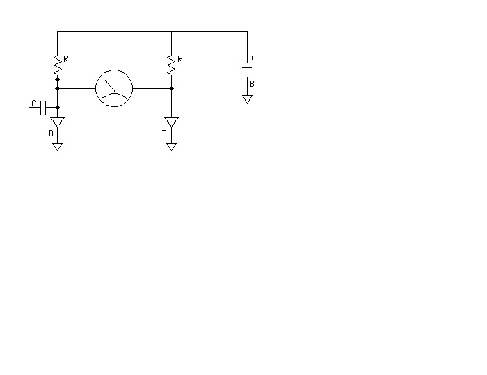

Attached RF meter schematic. Will work with just a sensitive meter, but chances are good you can burn out the meter! So put in protection or a variable shunt resistor.
