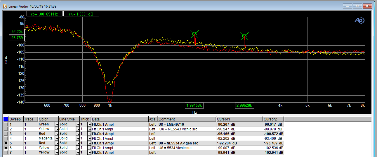

4M points, 16 averages, a few dB better.
Red is AP, Yel is Viktor.
This is nice (except for the long time it takes). Can see now down to about -140dB. But, that Vicnic oscillator is even better, still shows no distortion.
But I am not giving up, just got started! 😎
I should mention that both the tracking notch and the Viktor are fed from a Powerbank through a SilentSwicher ;-)

Jan, what about gain settings - are they auto everywhere?
You mean in the AP? Yes. The input to the notch is 1V in both cases, the fundamental out of the notch is about 6.5mV and the AP does its autoranging, then goes through the digital analyzer FFT.

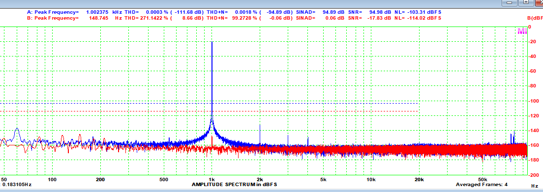

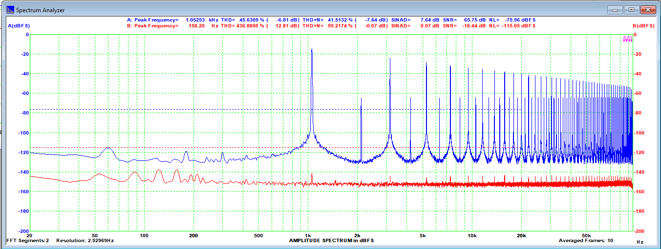

I did what I thought would be a quick check of the crosstalk on my L22. Windows had other plans but with a reinstallation of the Lynx drivers its "working". In any case this is what I get with a -8 dBFS (per Virtins) on channel A and channel B shorted. Is this similar to what you are seeing? I don't see any harmonic crosstalk.
Source HK4400 (modded) 600 Ohm output.
Hi Demian,
The figures I got were a bit confusing. The harmonic cross-talk not only depended on which sound card was used as reference, but also depended on the sound card that was used for generating the sine wave. Anyhow, I got much higher cross-talk figures, which varied between -125 and -166dB. May I suggest to discuss this matter in more detail (and on the other thread) when I've finished the upgrade of DiAna and investigated this cross-talk issue in more depth?
Cheers, E.
Cheers, E.

Made some progress today with proto#2 of my auto-tracking active notch.
The attached shows the result from a rainy Sunday.
The yellow trace is the output of the 1kHz notch, input is Viktor's 1kHz oscillator. The notch dept is about 44dB, and there is no distortion visible. The noise floor at 2kHz is ~-138dB and at 3kHz ~-144dB.
The red trace is with the AP generator as input. Here we clearly see the residual of the AP generator, at ~-136dB and 3rd at ~-138dB.
If I do a loopback I get these same numbers for the AP. So the concept seems to work and I can already show that Victor's oscillator is better than the AP.
I am not sure what I am seeing re: noise floor. The measurement with the AP generator has a lower noise floor, so the relatively high noise floor of the yellow Viktor curve seems to indicate that the Viktor measurement is limited by its noise.
Viktor always shows lower noise which might be due to the fact that he uses a much smaller bin width than the AP.
Viktor, Demian, others, do you have any comments/hints on this?
Jan
If I interpret it correctly, then Viktor is more interested in low distortion than low noise. You can not have both. The resistors in his oscillator are relatively large.

I might hazard a guess that Victor's oscillator has more phase noise than the AP, perhaps due to noise injected by the oscillator agc. If one runs the agc control JFET with very low signal across it, it will generate less distortion.
However, the penalty is that the agc circuit may inject more noise into the oscillator loop if the agc is to still have adequate control range (authority) for control of oscillator amplitude. This can manifest itself as the notch depth at the fundamental frequency not being as deep, as there are noise sidebands about the fundamental.
Just speculation ...
