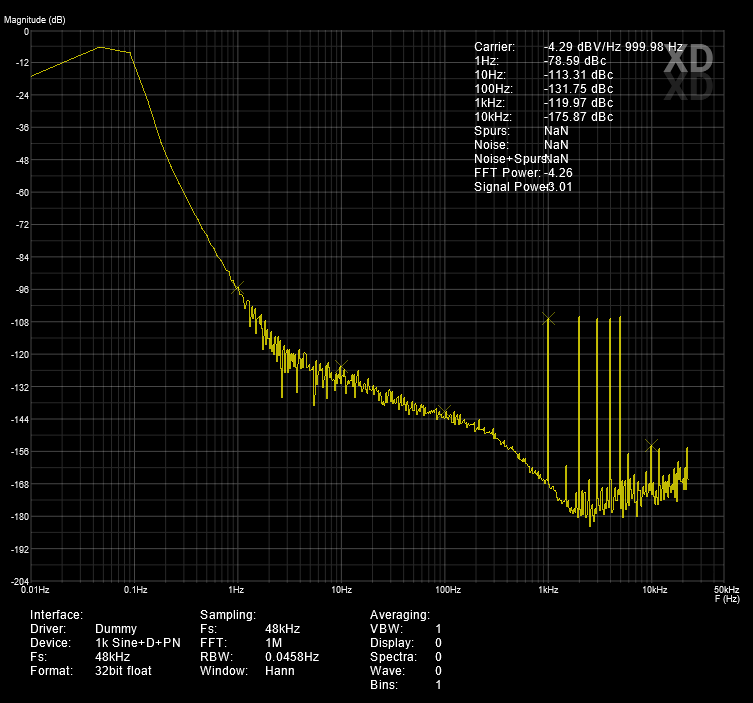

Now i want to implement ADC with sample rate lock on measured carrier signal. Problem solved!
It should be easy... i guess.
First of all, it wasn't THAT easy...
Second, it actually works 🙂

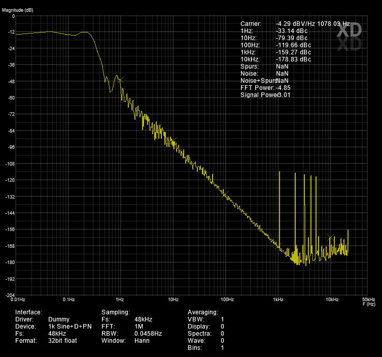

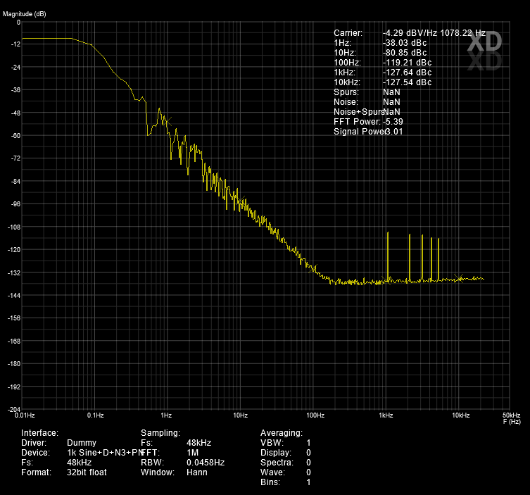

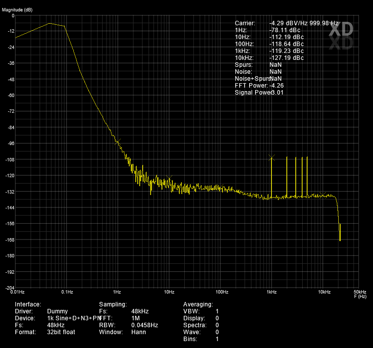

Phase locking of analyzer sampling to measured carrier, reduces phase noise, eliminates wander and scalloping (if locked to bin-centre frequency).
Signals are synthetic, sine wave + phase noise + distortion. the "999.99Hz" are "PLL locked", "1078Hz" aren't.
The grand scheme of things:
ASRC: x32 upsampling by zero-stuffing, convolution by Sinc-windowed-by-Kaiser-9, and then interpolating between samples by quadratic interpolation.
Then i feed the ASRC with frequency difference data (zero-crossing detector with a bit of interpolation Vs target 1kHz frequency) and then... Magic! 🙂
I still need to fix interpolation at zero-detector (running linear and unhappy), as well as figure out the control of PLL corner frequencies.

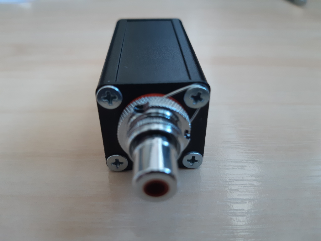

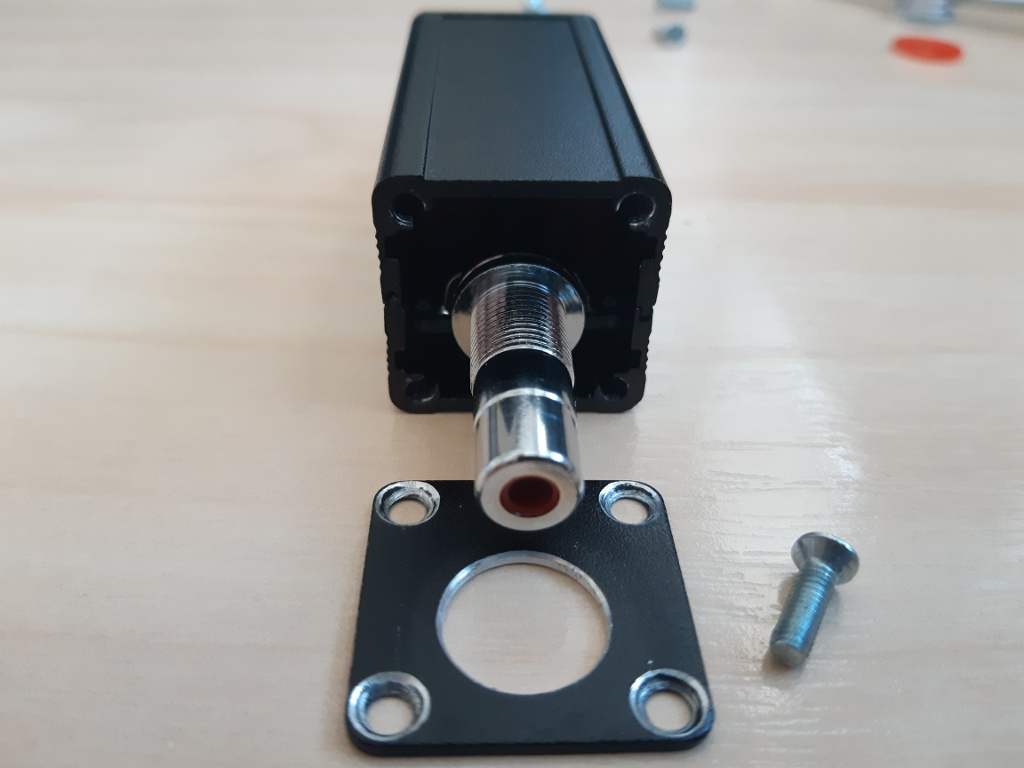

Great! I just ordered a bunch of boards at Seeed. Delivery 2-3 weeks.
Anyone want one? $2 + shipping (letter) at cost.
If LKA is OK with that, of course. LKA, if you want some, let me know, my gift back to you.
Jan
Gone. Three people have signed up. I have will have 2 boards available for each of you, sorry not 4. I will PM you when I get them.

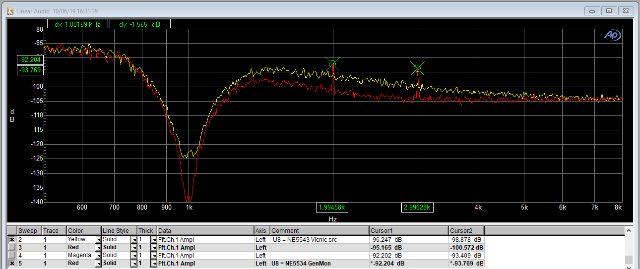

Made some progress today with proto#2 of my auto-tracking active notch.
The attached shows the result from a rainy Sunday.
The yellow trace is the output of the 1kHz notch, input is Viktor's 1kHz oscillator. The notch dept is about 44dB, and there is no distortion visible. The noise floor at 2kHz is ~-138dB and at 3kHz ~-144dB.
The red trace is with the AP generator as input. Here we clearly see the residual of the AP generator, at ~-136dB and 3rd at ~-138dB.
If I do a loopback I get these same numbers for the AP. So the concept seems to work and I can already show that Victor's oscillator is better than the AP.
I am not sure what I am seeing re: noise floor. The measurement with the AP generator has a lower noise floor, so the relatively high noise floor of the yellow Viktor curve seems to indicate that the Viktor measurement is limited by its noise.
Viktor always shows lower noise which might be due to the fact that he uses a much smaller bin width than the AP.
Viktor, Demian, others, do you have any comments/hints on this?

That looks like what I see with both active notches and the Shibasoku. The noise in Victor's oscillator can be defined by the impedances in the circuit, including the output resistor. I have noticed the KH4400 with its 50 Ohm output has a distinctly lower noise floor as well. Also near resonance the resistance changes and that accounts for some of the noise increase both in the oscillator and especially in the notch. When looking that low I increase the FFT resolution just to get lower. Usually 7 averages of a 5 million point FFT. It can take 1/2 hour to capture but you can see very deep. I don't think the AP supports that.
With the notch and DiANA's latest upgrade you should be able to cross-check your measurements with a more conventional sound card.
When the harmonics get that low (-140 dB+) you cannot be certain who is contributing. Both the interactions of the phases and amplitudes and the nonlinearities of the parts themselves can be an issue. You might try my trick of a low pass filter on the output of the oscillator to see if the change in harmonic level tracks or shifts. This would be an indication of cancellation or real harmonics. Pavel is using that in his distortion cancellation method.
Harmonics this low are in the time-nut and volt-nut realm. Way below anything with real world impact for us (unless you are building your own LIGO?) but an interesting pursuit anyway.
