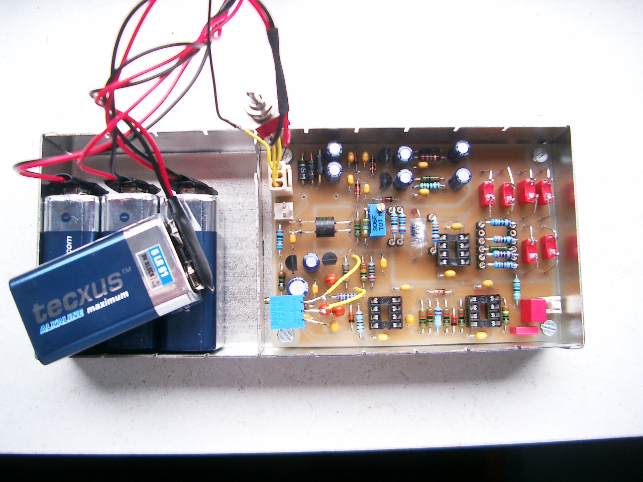

News from the lab
A new problem: The last battery does not fit into the case. I need a bigger case!

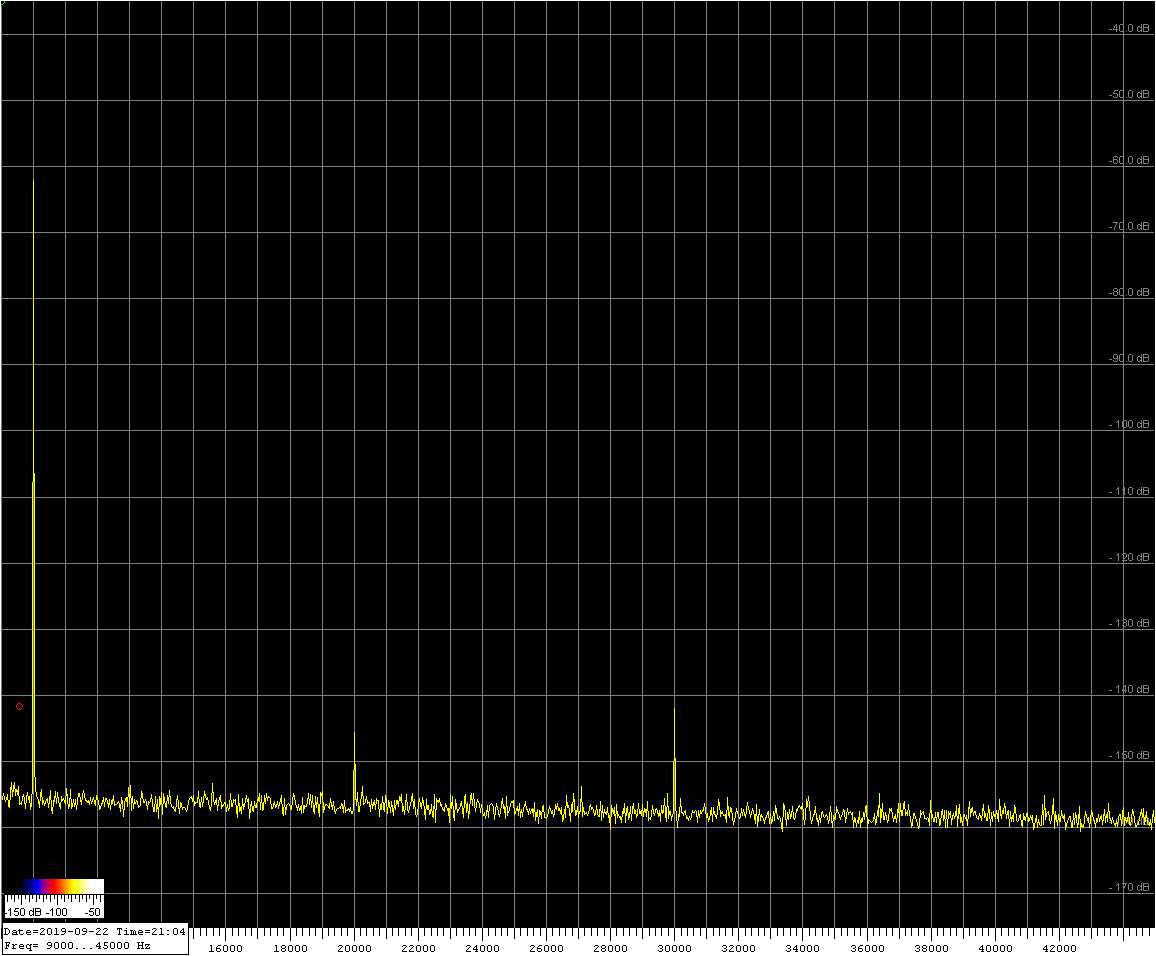

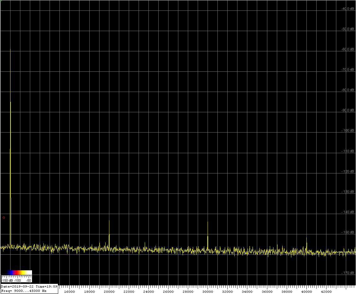

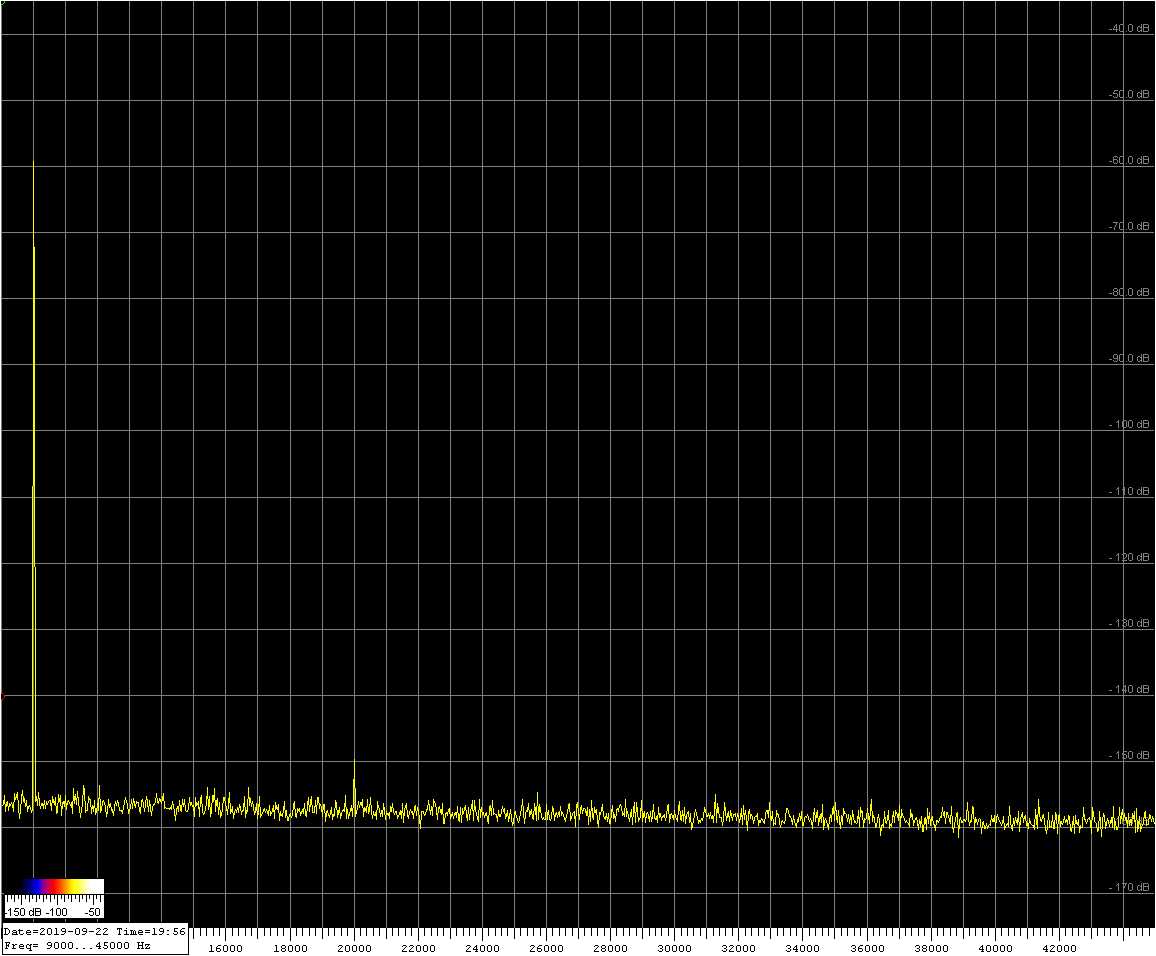

The 10kHz oscillator distortions tests at maximum output (2,7V RMS). Different opamps in the Wien bridge.
Measurements via the passive twin T. Needs to add +4dB at the second harmonic.
1) LME49720
2) OPA1656
3) LME49720 + 1,1kohm load at opamp output
4) OPA1656 + same load
