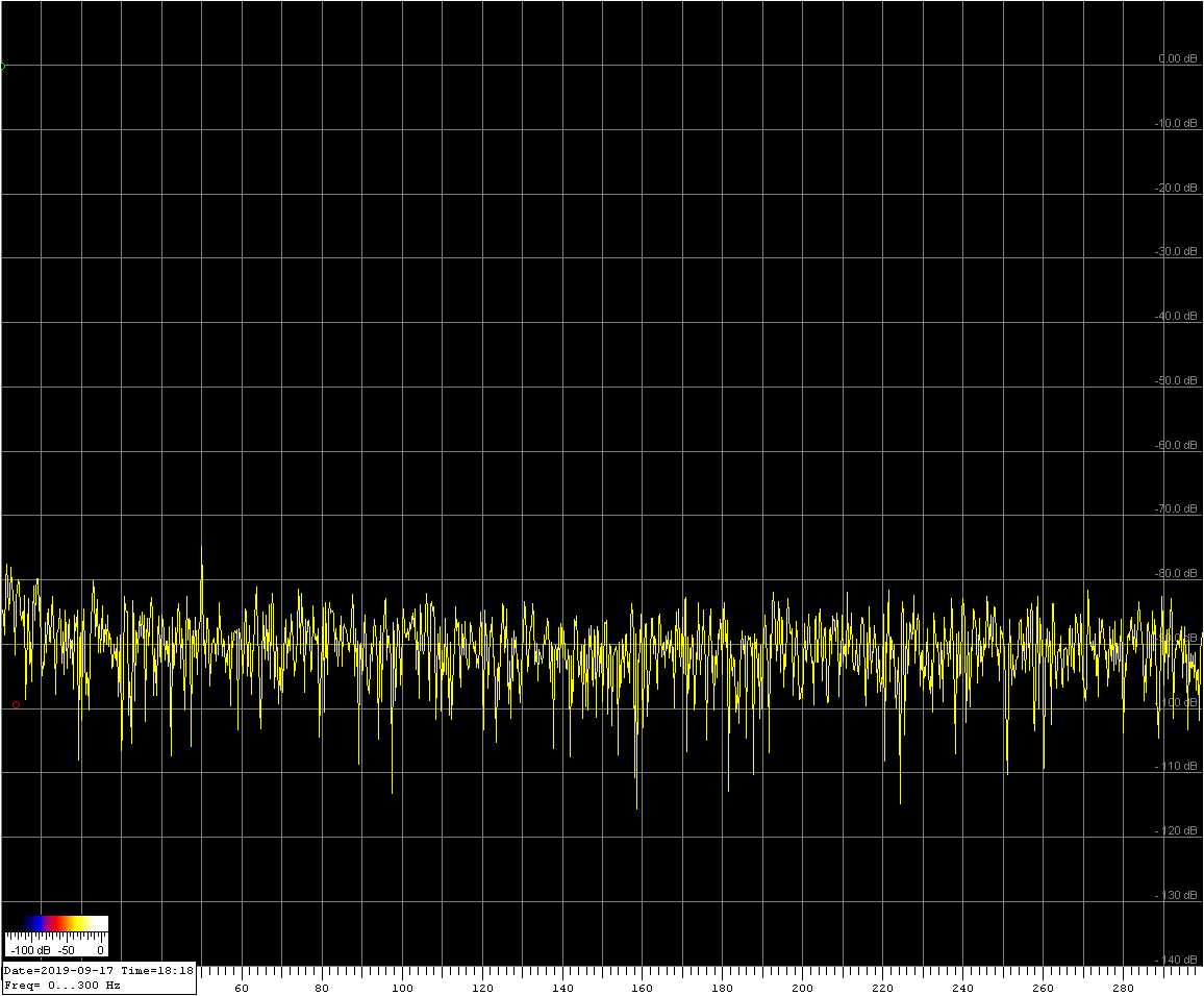

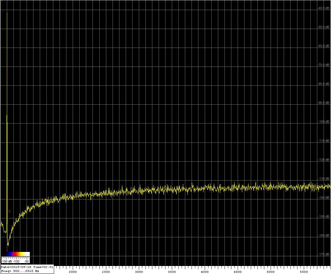

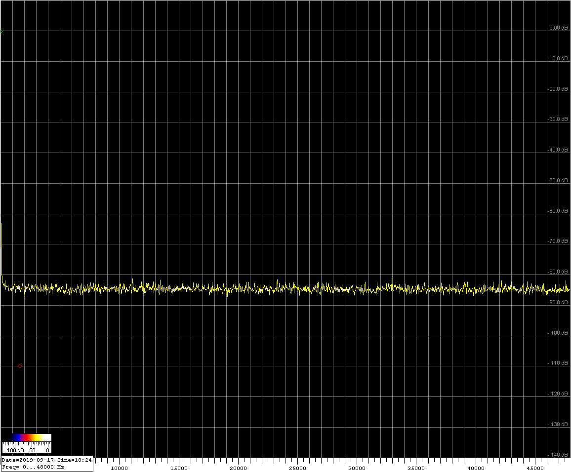

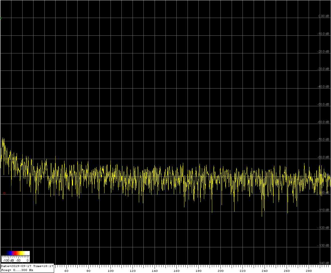

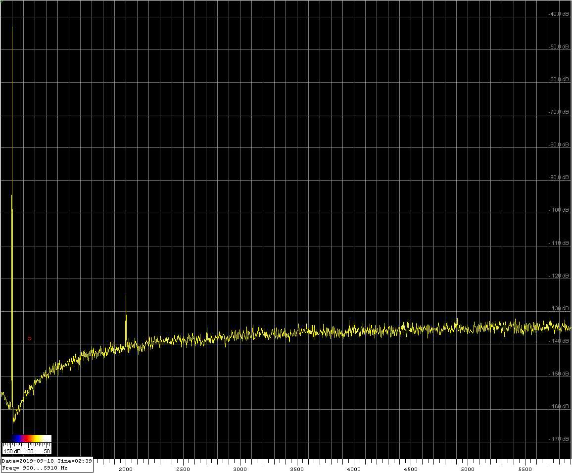

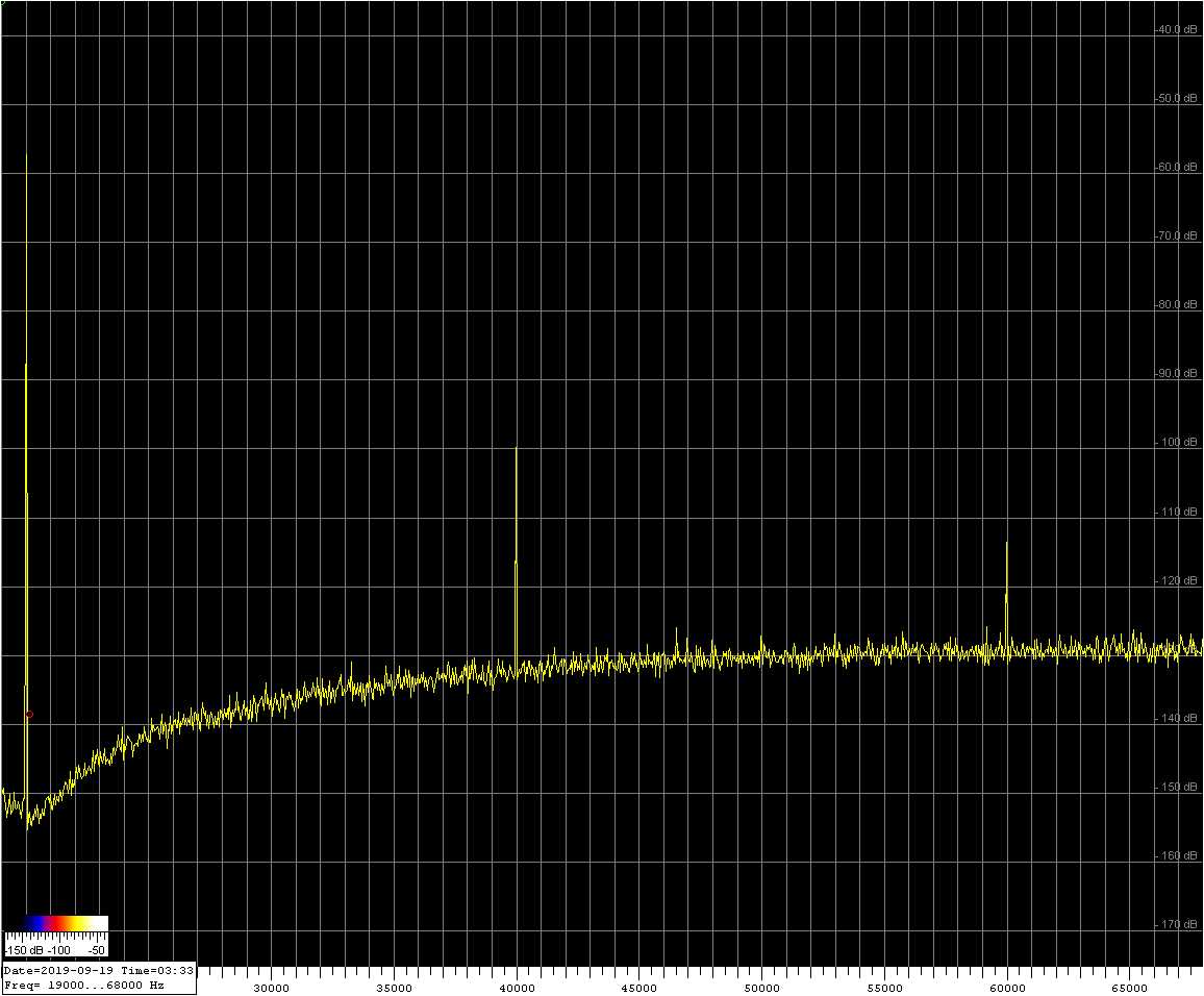

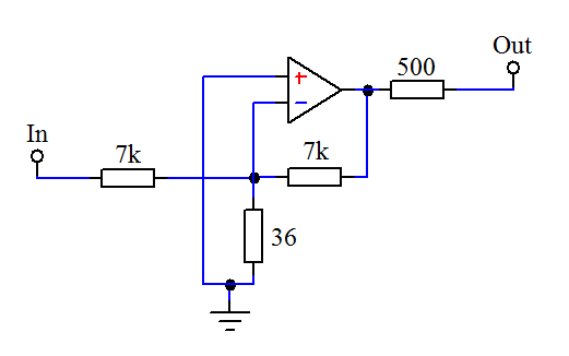

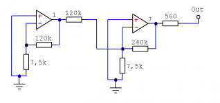

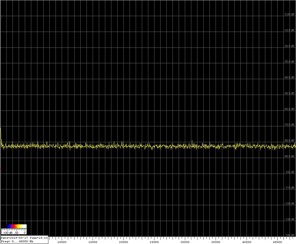

First tests of the OPA1656ID.
Received 3 examples. Very similar. No significant differences in noise and distortions tests. Tests was made in comparison with the LME49720.
Attached pictures:
1) Noise test schematic (as I am using for the LME49720 selecting).
2) LME49720 (selected example with low noise) spectrum in low frequency range.
3) OPA1656 in the same range.
4) LME49720 spectrum in wide frequency range.
5) OPA1656 in the same wide range.
6) Distortions test schematic. 1kHz 2,5V RMS at input/output. Measurements was done via the passive notch.
7) LME49720 spectrum.
8) OPA1656 spectrum.
Congratulations and thanks to Texas Instruments for the very good new opamp!

Victor, thank you doing this nice measurements! What I see from you OPA1656 graphs:
3) as lower 50hz hum peaks 😀, but larger low level freq. pop noise 😱
8) no 2. Harmonic's at all 😀
The final question will rise how the OPA1656 will perform within the oscillator, while different & larger impedance's exists. May also replace the TL072 how this changes too 😀

OPA1656 is CMOS, so the 1/f noise is going to be higher. It is very impressive overall.The final question will rise how the OPA1656 will perform within the oscillator, while different & larger impedance's exists.
The 7K Ohms resistance will dominate the noise (10 nV/rtHz) so you won't see the internal noise contribution at 3-4 nV/rtHz.
What I would like to see is the input cap variation induced distortion- Use a higher series resistance to the input e.g. 10K and see how much the distortion increases. In every other respect its pretty exceptional as a general purpose opamp.
Another question. Why is there no 5 kHz oscillator? You could also see the harmonics better at 10kHz and 15kHz (the audible range).
Thanks as always Victor for your diligent work! 1656 certainly looks like a winner, especially when the network impedances need to be a little higher. Rather than a need to squeeze the last drop out of e_n with bjt inputs.
Will this new opamp drive low impedances as easily as the 5534? Doug Self famously uses these low resistances everywhere to keep noise down; can this opamp be a drop-in replacement in his circuits?
