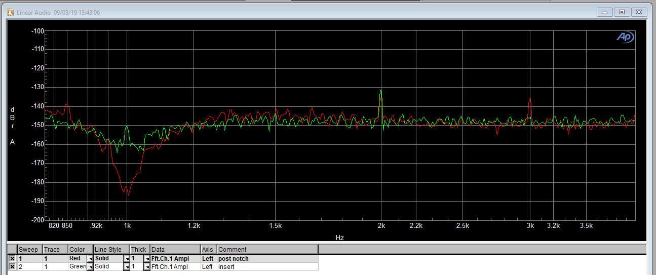

Made some more tests with the tracking filter today.
My operating assumption was that ultimately the self-distortion of the 2722 generator and analyzer are limiting its performance. And, when I would attenuate the fundamental by 40dB, the AP will 'think' that the distortion is 40dB higher than what it really is, and that distortion will then be visible above the AP internal distortion. Then I subtract 40dB from the shown value and Bob's my uncle. So far so good.
But that will not work if the filter circuitry also generates distortion at a similar level as the AP. Then, taking out the fundamental will just make me see better the internal distortion of the notch.
The attached shows two curves, input (insert, green) and output (post notch, red) of the notch filter. Very little difference, but you can see that the notch works as shown by deeper cancellation of the 1kHz.
Both curves with auto-ranging disabled, both with same AP gain setting. My conclusion is that I am really measuring the distortion of the opamps and passive parts in the tracking notch filter. I have done this measurement with and without the tracking (shorted linear optocoupler) with no differences, so at this point the tracking mechanism does not cause any distortion.
Now that the tracking has proven itself I should go and work on making the notch filter itself very low distortion.

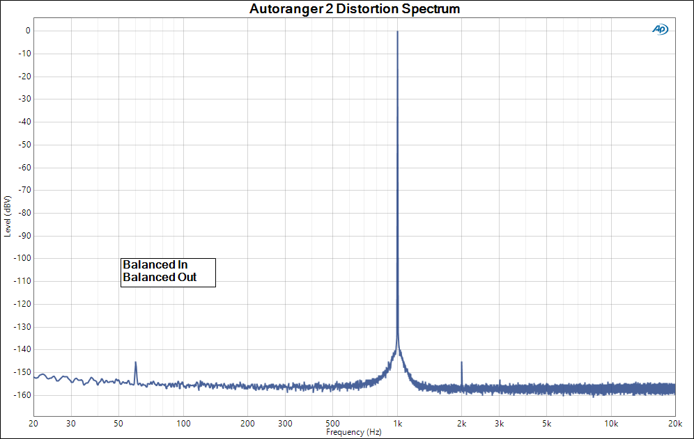

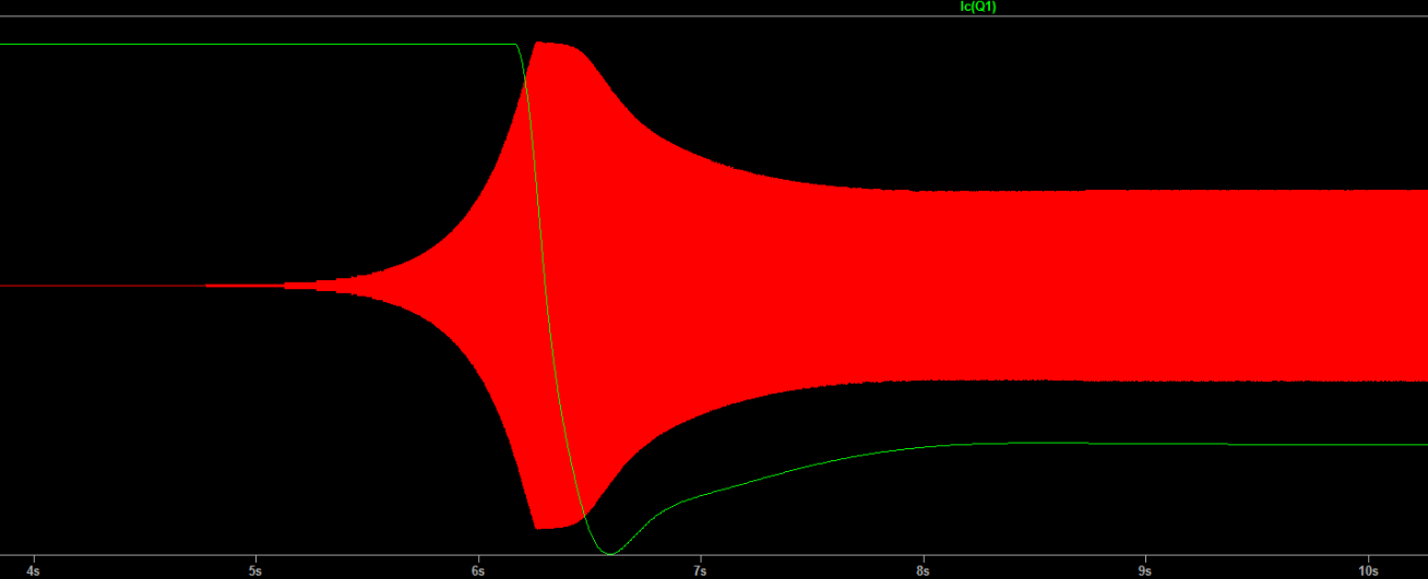

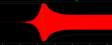

Yesterday I made some modifications to Victor's oscillator. The AGC is now much calmer and more solid. The circuit has now developed more in the direction of Linear Technology' ;-)

The red curve is from post notch. Right? Where does the harmonic at 3 kHz come from? From the notch filter itself?
Does Victor agree?
I wish I knew. I do know that the AP analyzer has such a 3rd residual, so I'm thinking it is that.
I am revising the notch circuitry to thy to get less residual and less noise. All circuitry is now inverting to avoid any CM distortion, and signals to the (non-linear) frequency and phase discriminators are now buffered.

Faster settling time usually means more distortion. This is because the agc control circuit is a high-order nonlinear feedback system. The filtering needed to suppress the agc level detect rectification ripple introduces poles and phase lag, leading to instability in the agc loop. Some HP oscillators used to have a switch on the back where you could choose lowest distortion or fastest settling time for low frequencies.
Bob
