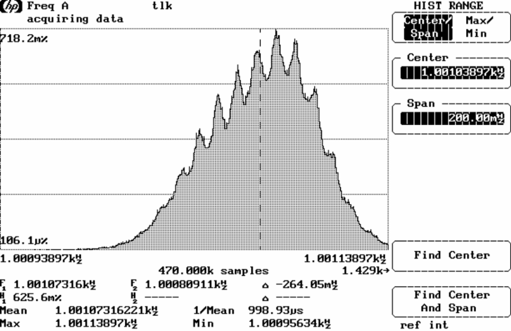

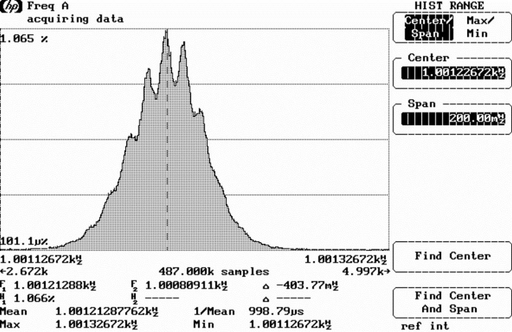

Just for fun, have made Victor,s 1kHz oscillator shielded with Cu-foil and measured again.
Drift is still present, but the whole histogram become more symmetrically.
Sure, change is quite small and probably not relevant for audio use, but is definite measurable,
and interesting to compare with unshielded measurement.

Any idea how much of this was thermal in nature? By thermal, I mean small changes caused by air movement. It might not be electrical shielding making the difference, but rather control of the air currents across the components. Or, it really could be electrical shielding. Or, both. Or, keeping the leprechauns out.

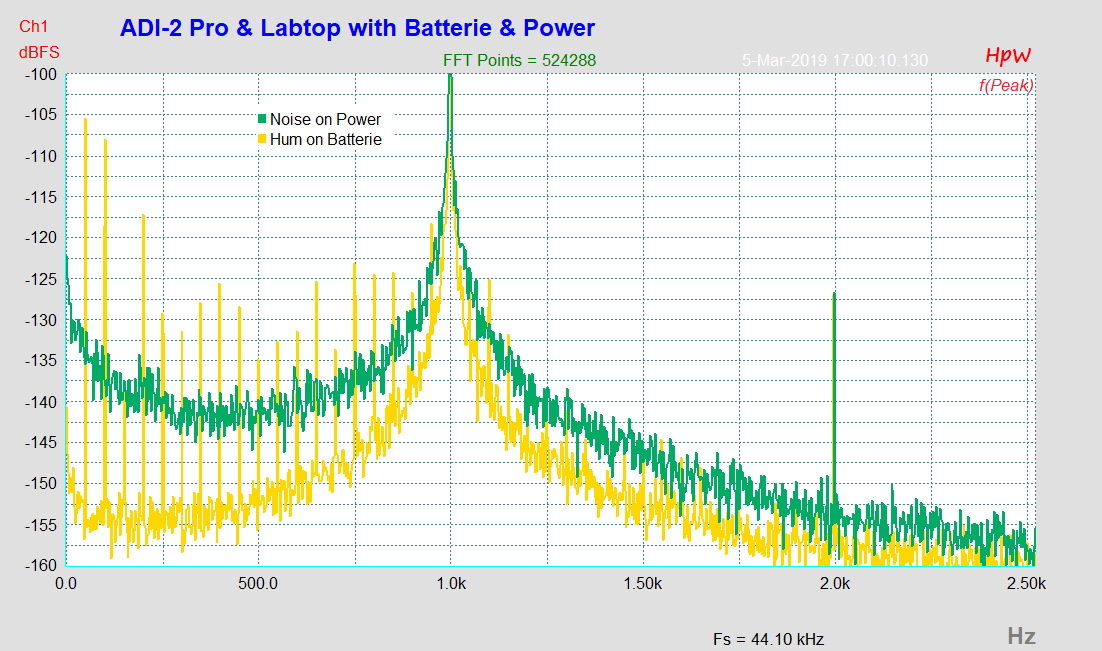

This is my take at measuring Victor's oscillator.
The measurement chain is Victor's (1Vrms out) -> massive-parallel buffer (8 X LM4562, 50 ohm output impedance) -> notch filter -> 60dB LNA -> audio interface.
The spectrum in the attachment shows the 2nd harmonic only at a level of -98dB w.r.t. 5Vrms (audio interface range). Correcting for the notch filter attenuation of 12dB@2kHz, and the LNA gain of 60dB, the 2nd is at -146dB w.r.t. 5Vrms, i.e. at -136dB w.r.t. 1Vrms.
Assuming now that the 3rd harmonic is just below the noise, i.e. at -103dB, and performing the calculation with the 3rd attenuation of 8dB in the filter, it would amount to -145dB w.r.t. 1Vrms.
Sorry about the mains interference, but it does not influence the above results.

Indicates HUM pickup do not shielding...😀

Hum is some larger, than I think it could be ok (for battery powered device). You can try cable with better shield. I use diy-cables made from fine quality RG58, RG59 (or analogs) and have lower hum.Look at my pictures... 😀

I haven't done any further investigation, but change is clearly visible and repeatable, no doubt about that.
Just es i said before, the whole change is on extremely low scale and probably of no real meaning for audio purpose.

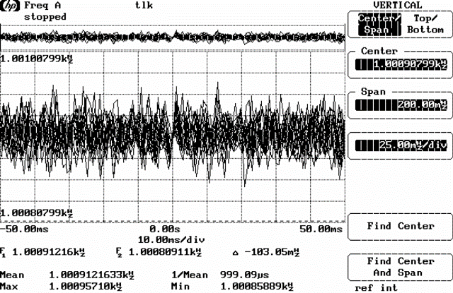

I am more concerned for oscillator stability and accuracy - every time when is it switched on, about 20min. is needed till mean frequency is achieved, but this frequency is always different - a few Hz more or less than 1kHz.
The question is: if that few Hz have impact et all on THD measurements or not?
All that what i have said, by any mean does not imply that oscillator have some strange behavior or error.
I have only look at it from "high frequency" perspective, once more-is that important for audio- i simply don't know?
The oscillator was already in metal box together with 4x9V battery, i have made only extra tight shielding of circuit board itself.Hmm, looks like hum modulation, but side freq. are not hum freq. related..

Yes. The oscillator frequency drifts for app +0.3% within this time. Heat from the LME49720 and the onboard shunt regulators warms up the polypropylene caps. These caps can be replaced with the polystyrene caps. Then the drift will be app. two times lower. Also the distortions may drop in this case, but this can be seemed only in lower than -150dB region.... about 20min. is needed till mean frequency is achieved
