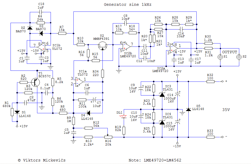

Hi, Jan....the inverted output on the 5kHz is a bit higher in amplitude than the normal single ended input. On the 1kHz they are both the same amplitude. Do you have an explanation for that?
Jan
How big is the difference?
Probably the 10 pF cap in the inverter feedback produce the small phase shift at 5kHz, but the AGC increase the inverter signal for to get the properly level at Wien bridge output, where the AGC get the input signal. Also maybe the Wien bridge capacitors have a small difference (typically they are matched for app. 0,2%).
Hi Vic, I didn't measure it exactly but would guestimate about 10% higher level from the inverter than from the regular output.
Doesn't that imply that it actually is the output inverter that has gain < 1?
I have the schematic for the 1kHz oscillator; is the 5kHz the same (except of course the frequency determining parts)?
In itself I don't think the difference will be an issue but I was just curious.

I just measured my 20kHz example. I can't see any difference by the oscilloscope. The schematic is the same. Probably something went wrong in your case. The 10% difference is more too big. Please check the signal direct at the LME49720/LM4562 pins. If the frequency is right (typically the precision is better than +/-0.5%), then the difference from the main output (pin 1) and the inverter output (pin 7) must be negligible.
Would you please post the latest schematic?
I will check later or tomorrow. Today is a bad day at the lab - everything I touch seems to break instantly ...

Vic, sorry, false alarm. I just measured again both phases of both oscillators and they are within 5mV of each other at 1V nominal output.
I must have been doing something stupid.

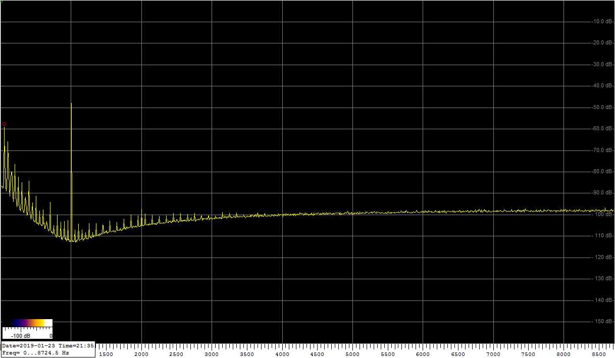

This is my take at measuring Victor's oscillator.
The measurement chain is Victor's (1Vrms out) -> massive-parallel buffer (8 X LM4562, 50 ohm output impedance) -> notch filter -> 60dB LNA -> audio interface.
The spectrum in the attachment shows the 2nd harmonic only at a level of -98dB w.r.t. 5Vrms (audio interface range). Correcting for the notch filter attenuation of 12dB@2kHz, and the LNA gain of 60dB, the 2nd is at -146dB w.r.t. 5Vrms, i.e. at -136dB w.r.t. 1Vrms.
Assuming now that the 3rd harmonic is just below the noise, i.e. at -103dB, and performing the calculation with the 3rd attenuation of 8dB in the filter, it would amount to -145dB w.r.t. 1Vrms.
Sorry about the mains interference, but it does not influence the above results.
