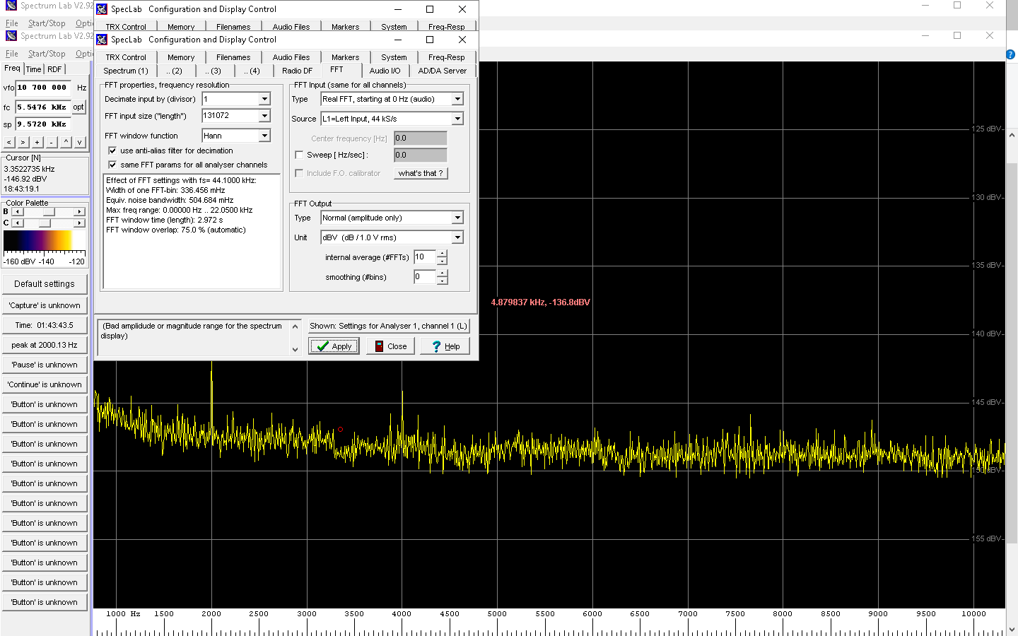

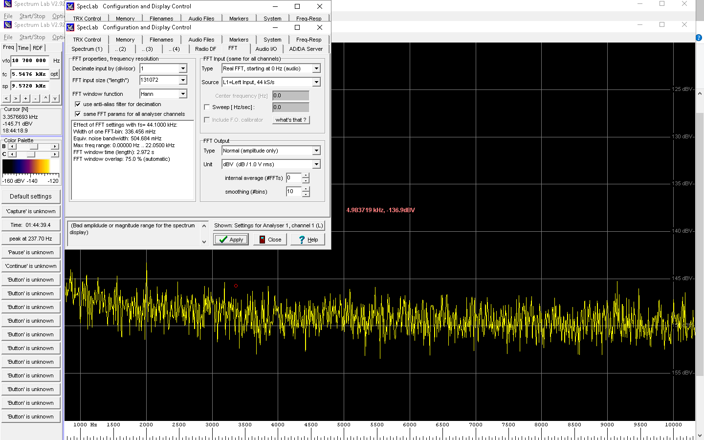

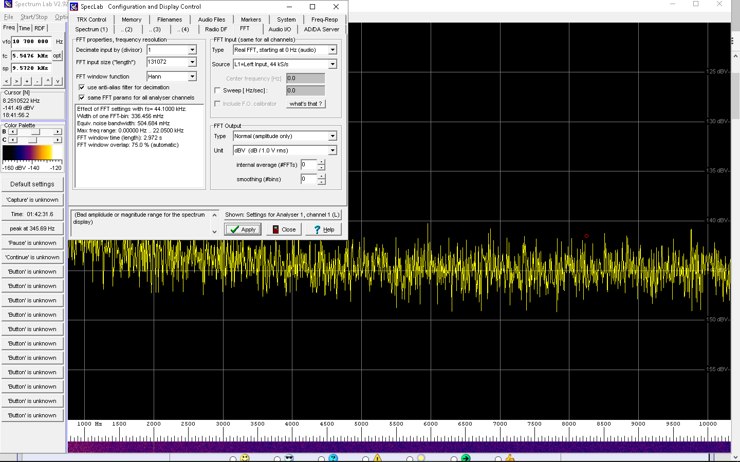

I got Spectrum Lab going again. If you play with it after a while you'll remember where everything is. I did find that the author screwed up all of the averaging. The averaging changes the scale. Don't use it.
Please can you explain, in which conditions the averaging changes the scale? I saw only lowering of the input signal level when the input frequency drifted during the oscillator warm up time if the long averaging was used.
What I was looking at was 'smoothing (#bins) and averaging (#FFTs).
Both cause the noise floor to drop 5dB to 6dB and the smoothing (#bins) cause both the signal and noise floor to drop. The smoothing (#bins) seem to do more depending on the amount.
This shouldn't happen.
See below.
See below.
I never used smoothing.
Yes, averaging visually drops the noise floor if also the big FFT input size was used, but I did not see the signal drop in this case. In my opinion, the noise floor is not properly displayed if NO averaging is used and the FFT input size is big. Please see my post: http://www.diyaudio.com/forums/equi...n-audio-range-oscillator-621.html#post5009280
