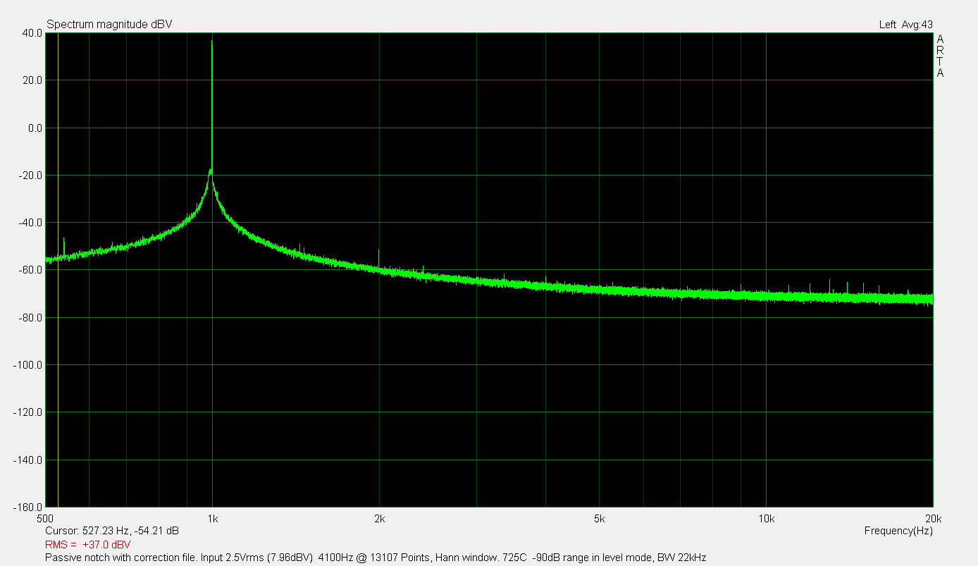

I repeated the passive notch measurment of my SVo on the Shibasoku 725C.
The 725C doesn't have the range of the 725D. 0dBV is - 90dBV in the following pic.
I made up a notch filter correction file using the built in FR (Frequency Response) software in ARTA. The file loads as a mic compensation file.
I've included the correction file for inspection.
The 2nd harmonic measure -51.62dBV - 90dBV = -141.62dBV
The input is 1kHz @ 7.96dBV.
Therefore -141.62dBV -7.96dBV = -149.58dBV 2nd Harmonic.
We are down from -90dBV at 0dB. Remember to add 10dB to the noise for a correct noise floor.
