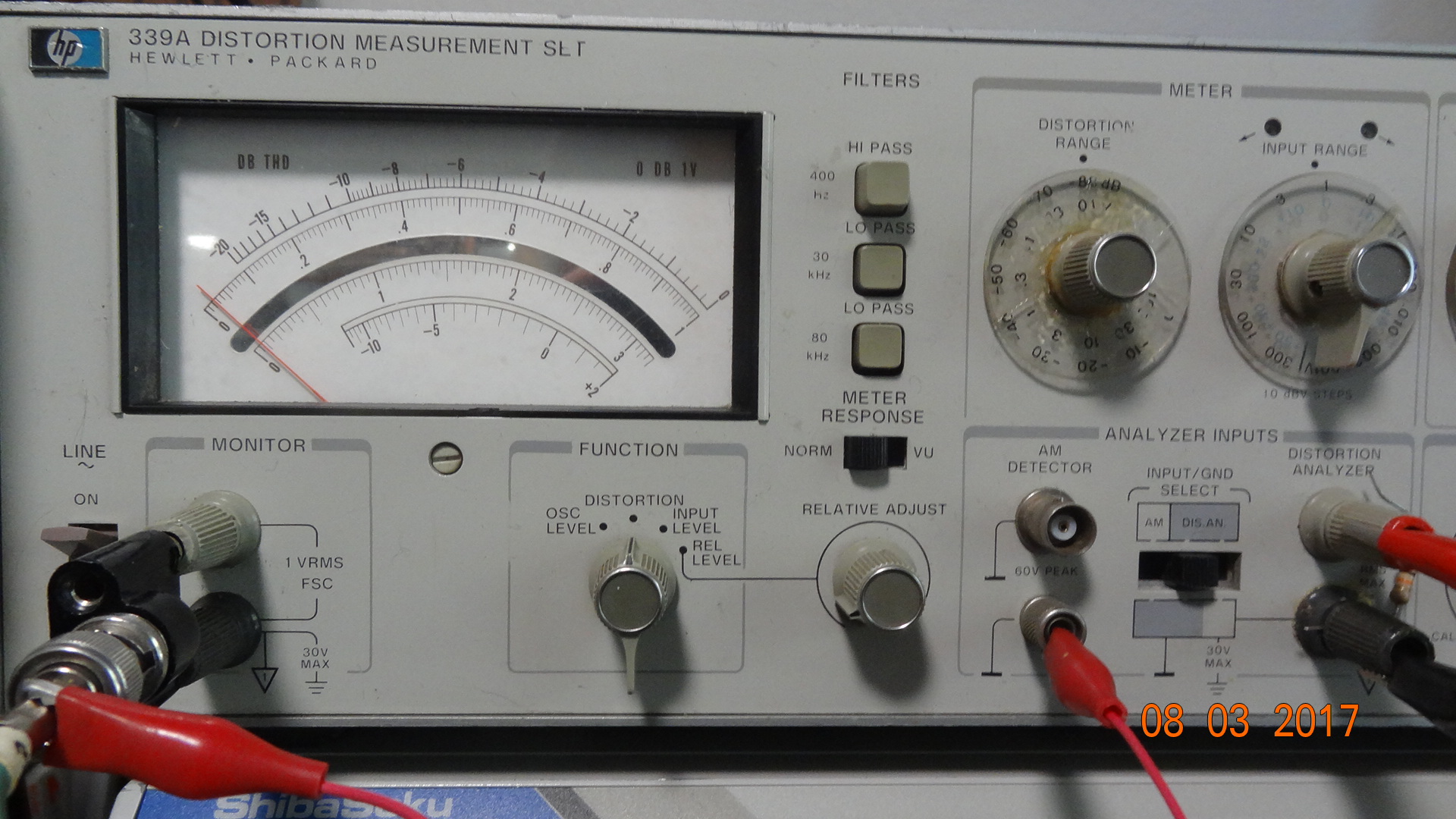

here is a really really older osc design...... used in a HP-339A. I just changed opamps and a few parts. 2H = -140dBv
[I also changed and tweeked the analyzer section..... mil grade, ceramic et al for greater low level linearity. Could easily add a X10 gain for the meter.]

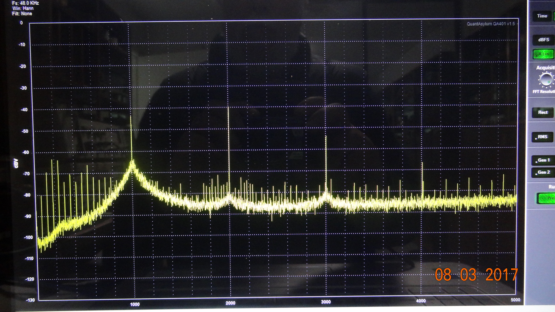

Well no, you still show a ridiculously low noise floor. Can someone find out what the QA401 device is doing, synchronous averaging, etc.
EDIT downloaded it, manual shows nothing in fact usual fairly low featured audio specific stuff. Software won't read in .wavs, etc. so I can't run a test.

Nice lab there BTW 2nV of 60Hz hum.

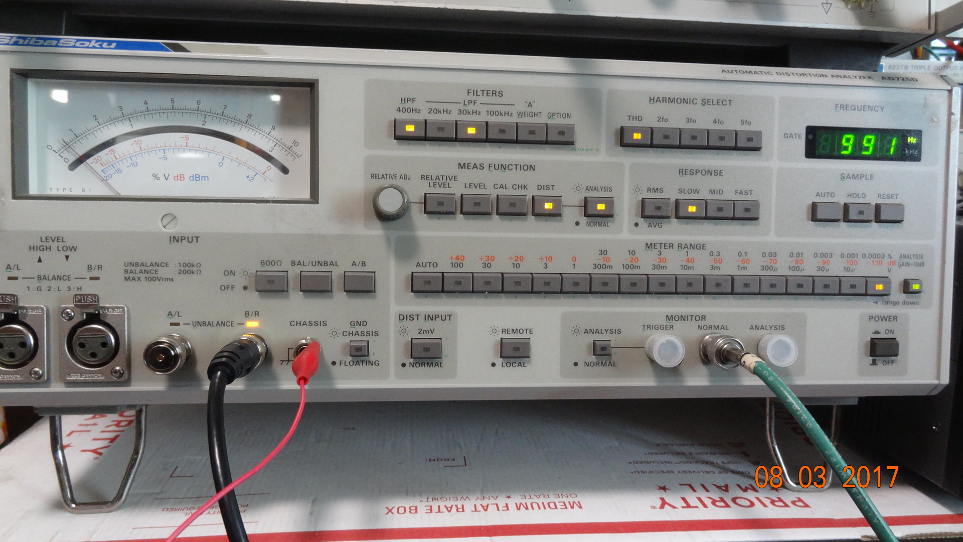

Yes, I worked out a very clean test system... Here is a straight-ahead measurement... no QA401 FFT/noise suppression..... just read off the meter.
It is on -110 dBv FS. Or -130db at the -20db mark to the left.... as you can see, the THD of all harmonics and junk freq shows THD to be below the -130db mark... around maybe -135dB
And then factor in the +6db because input is not 1 volt but 2 volts. Right there we are at -140 or better.

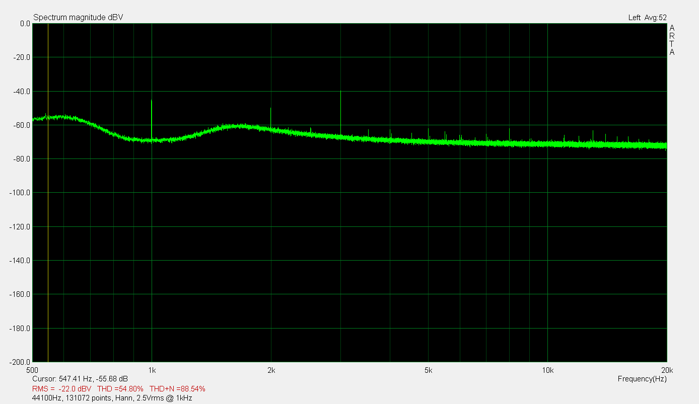

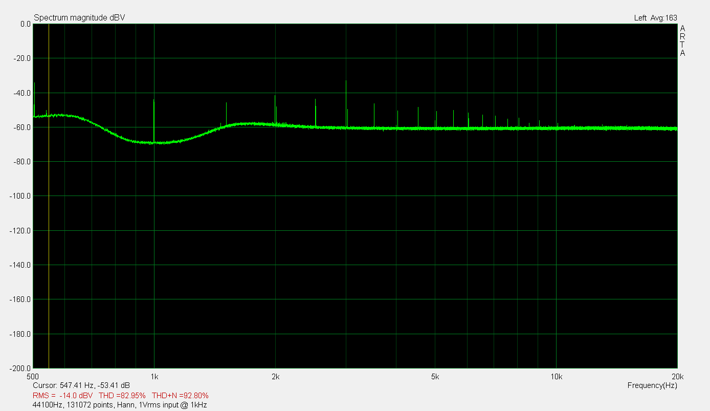

Scot and Richard,
Here is the scoop on the Shibasoku 725D.
Pic #1 is a 1Vrms input to the 725D. The second harmonic agrees with the passive twin T
measurement -141.7dBV 2nd harmonic. At 1Vrms input the input is at unity with the 1Vrms FS of the monitor output.
Pic #2 the input has been increased to 2.5Vrms. This level put the 725D into the next higher input range 3Vrms (+10dB). Notice the harmonics drop about 10dB and so does the noise. This is not correct. In the + 10dB input range the monitor port scale is 10dB less or there about. We no longer have unity scaling. This is the discrepancy.
The Shibasoku 725D measures ratio of fundamental to noise and distortion and displays this accurately on the meter. The scaling is such that the meter reading is correct. The monitor output is not intended for accurate measurement. If we are going to use it this way then we need to compensate for the difference from unity.
The FFT settings are stated at the bottom of the ARTA plots.
yes. This all correct from my view also. The 3v and above ranges are attenuators to get back to 1 volt. Below one volt range there is gain... again to keep things at one volt.
When I did my idle/calibration tone mix, i had the output just below 1 volt so I was on 1 volt range.
Otherwise, I compensate by adding 6db at the qA401 -via its software - so it reflects the higher voltage being tested.
I am getting about the same as you on my gen. Maybe 2-3dB better with my trim at 2.2v output.
Some error in difference is with the monitor Zo of 1K, and input Z of 10k or less from the QA401, a dB can be lost. I have changed the Zo from the monitor to 10 Ohms. less noise also.
So, with that in mind, we are only about 1 dB apart in the two generators.

Thank you David, an auto scaling artifact as I supposed a few days ago the monitor output is not corrected since it's not intended as a primary output, all now is well. Good detective work.
