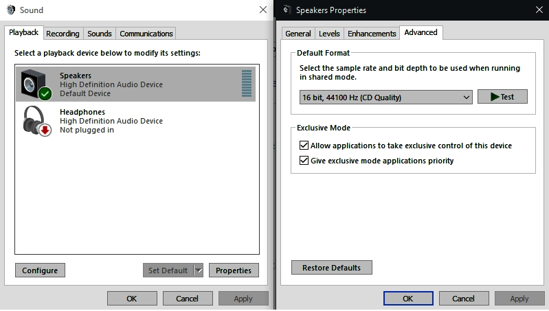

Audio applications that access Windows sound services in shared mode get automatically resampled on the fly. That means almost all applications. The default sample rate Windows uses can be set in the sound device advanced properties settings, from the Windows control panel. Usually, Windows defaults to 16/44, so need to be careful if that matters.
ASIO bypasses Windows sound service, so it doesn't have that problem.

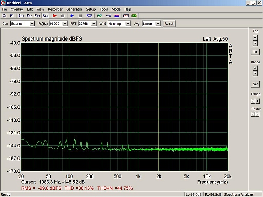

Do you get strange LF peaks - which is what I sometimes get. Switching Fs back and forth, either via Arta or windows control panel, usually gets rid of it but its seems haphazard.
Otherwise, +1 for the Xonar DX. Been using one for years. Blew one up (don't ask!) so bought another.

No, I haven't seen the 192 rate problem, probably because I saw the usual noise shaping hump and decided it wasn't going to show me much in the way of low level harmonics above 50K. I'll try it anyway when I've got some time in a week or so.
DSP stuff: do you have the 'Xonar DX Audio Center' in the sys tray ?
Make sure its set to 2 channels, 2 speakers, DSP mode to HiFi and all the other 'features' disabled. But you've probably been though all that.
If you get the LF junk it looks like this:
