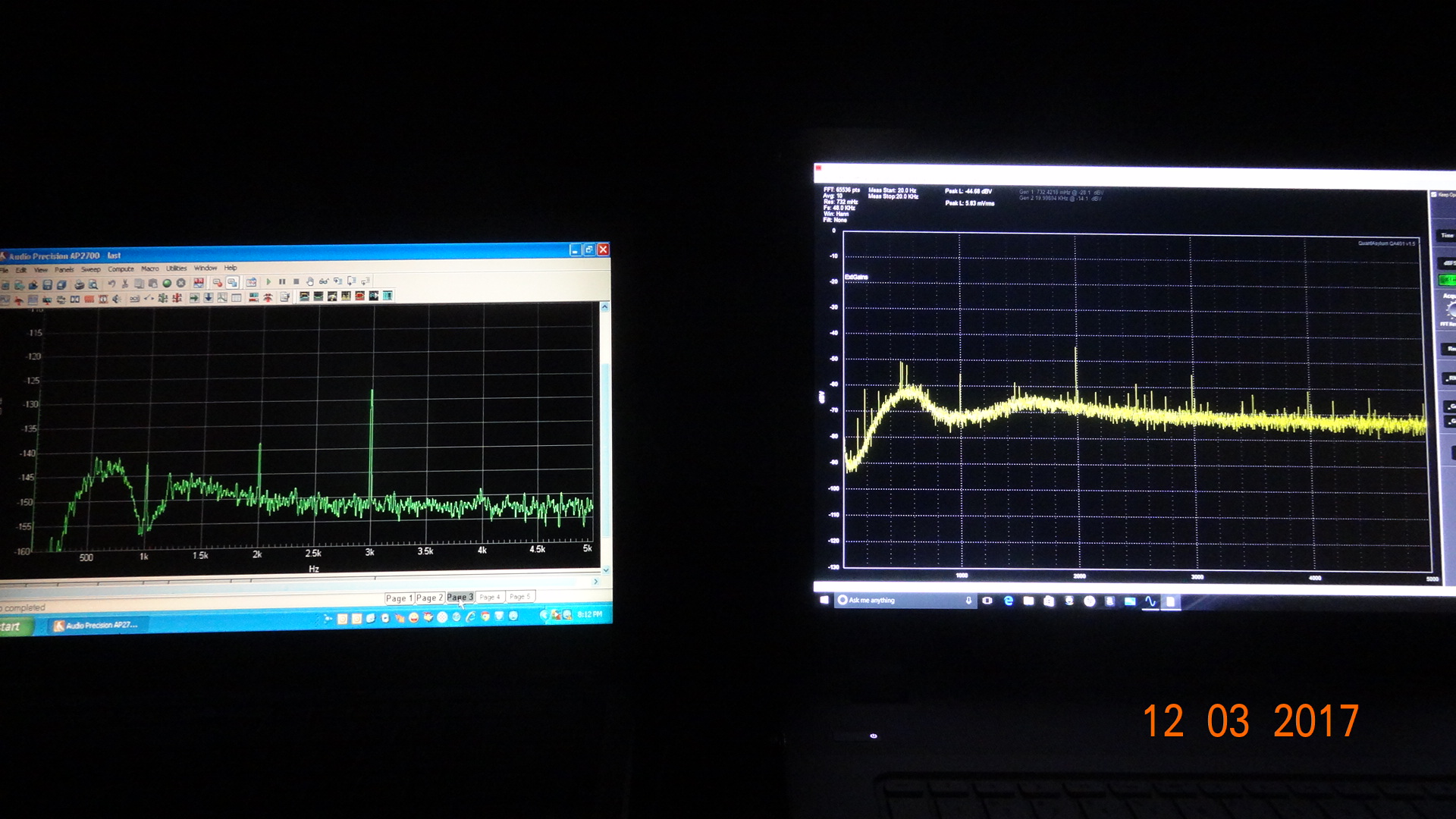

meanwhile, Here is the trouble I described in words before about the 2H and 3H measurement at low (<-130dbv) are not the same or even close with well known brands......
Here is AP 2722 and ShibaSoku 725D both measuring the same signal - T'ed to an AP and other to 725D-Qa401. never mind the scale differences..... look at the 2H and 3H are opposite in level to each instrument.
So after you get thru the T&M instrumentation -- hardware and software.... do they all show same data for 2H and 3H at ultra low distortion levels !?
THx-RNMarsh

Hi Richard,
The AP looks like its filters have sharper slopes or more "bins".
As far as comparisons go at those low levels, I doubt they could show the same levels. Even differences in input impedance, and I'm talking minor capacitance / inductance differences would show up. How does one differentiate between the instrument and the reality of the signal? Together they make up a system that's operating at the edges of performance limits.
I guess that's another way of saying that experimental error here is large compared to the results you're getting.
-Chris

One gen tee-ed off to input of AP and input to ShibaSoku. Same coax type and lengths.
It doesn't matter what the input Z's are-- change at will. DUT distortion isn't affected by subtle changes in L, R or C at analyzer input.
This resulting pattern of low 2H and high 3H on AP persists. test with Panasonic and you get opposite... like the 725D shows.
So.... on the Sound Card type measurments, one may get low level distortion data but it must be accurate data.
THx-RNMarsh

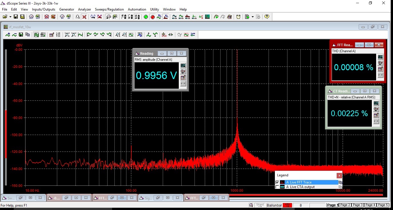

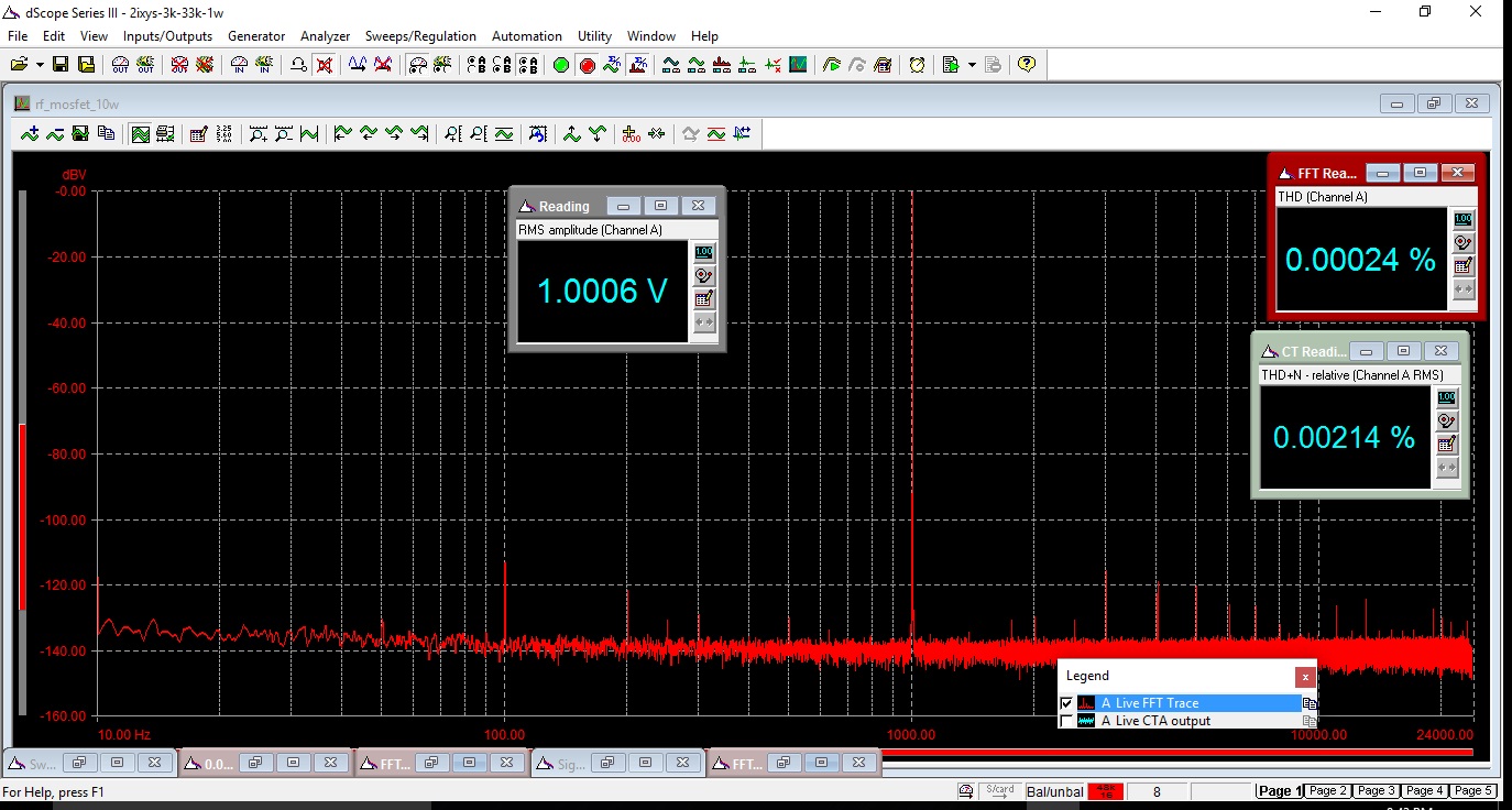

viktor low thd osc (balanced)
some time ago viktor kindly made me a balanced version of his oscillator - here is the fft...

Hi Richard,
Interesting application note. I can't say as I'm very surprised with the points made. I have called them to gain access to their other application notes. That app. note read more like a "White paper".
I usually test a pair of instruments the same way so that they do see the same input signal. However, at those low levels for noise, I'd say that the measurement uncertainties need to be identified. Except for the intended signal, all the rest (harmonics) are so close to the noise floor that tiny errors would be a large percentage compared to the signals being compared. By definition, you are at the limits of that equipment's capability and your signals are in the grass. That being said, the AP measurement suite is showing a trend that the other instruments are not. What would be really interesting to know is if another AP of the same model would show the same results. Do you think that the folks at AP would run these tests on that oscillator and send you the results? They might even agree to check it on their most cutting edge equipment that they are developing. For a manufacturer, that has some value. This would then give you confidence that your equipment is showing you the truth.
Another plan. Contact Keysight to demo their new U8903B and see what that shows. It is exactly what Keysight wants, a direct comparison using a challenging signal source. I'm pretty sure they have purchased an AP product and tested it against their own products already.
-Chris
