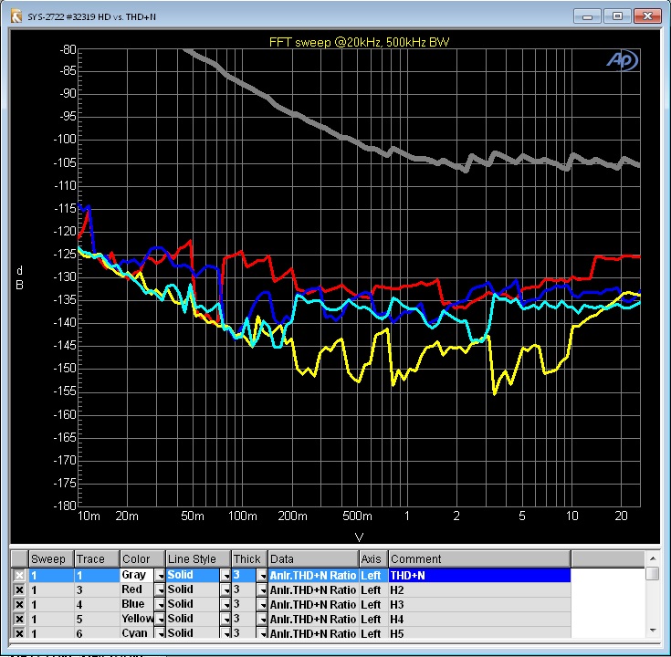

I verified the concept of using a voltage drop across the BNC cable as a form of insert calibration. I'll need to go through some more precise steps to turn it into something reproducible. It does enable verification of everything from attenuation of harmonics to really low harmonic levels. What I need to do is check several coaxes to determine which is most predictable for this.
A too deep notch can also produce additional errors with rather crude (18 Bit, Successive approximation ??) A/D converters as the one used in the SYS-2722, which seem to have a rather bad fade to noise linearity and thus need a certain fundamental magnitude in order to achieve the best dynamic range.
This effect you can see in the appended plot of my SYS-2722, which shows the H2...H5 fundamental residuals for 20kHz at different levels. Especially at very low levels below 80mV (where the instrument stops switching attenuators in the analyzer and thus runs more and more into linearity problems due to dropping level into the A/D converter ...).
In order to see this effect, the noise floor had to be lowered by roughly 55dB below the THD+N at the used 500kHz BW.
The sweep of 100 heavily averaged synced FFTs ran a few hours, but gives some new insight.
Even Mr. Hofer seemed to be a little surprised, when he first saw my plots, which seem to be quite revealing ...
Its probably like electron microscopes, which open up a very very weird world ...
This instrument should nevertheless perform very well in comparison to other off the shelf instruments of recent production, since it is one of the very few instruments, which are hand tweaked for low THD20k by Bruce Hofer's golden hands, for which I thank him twice a week ... :innocent:

:up:Jon Lord --- I was wondering in the past few days after looking at the A-P working.... don't we trade off the high level input non-linearity for low level non-linearity of the ADC? The 18 bit -- is that the sample and hold? The data you show indicates a 10dB average variation at those low levels. Good to know.
That is so Very 😎 test data -- quite creative to look into this with a fresh new view or angle -- two thumbs up for you at KLN. Tell us more, please. Especially about the affects of the notch?

A too deep notch can also produce additional errors with rather crude (18 bit, successive approximation?) A/D converters as the one used in the SYS-2722, which seem to have a rather bad fade to noise linearity and thus need a certain fundamental magnitude in order to achieve the best dynamic range.
I presume you're referring to the "high BW" ADC of the SYS-2722?
