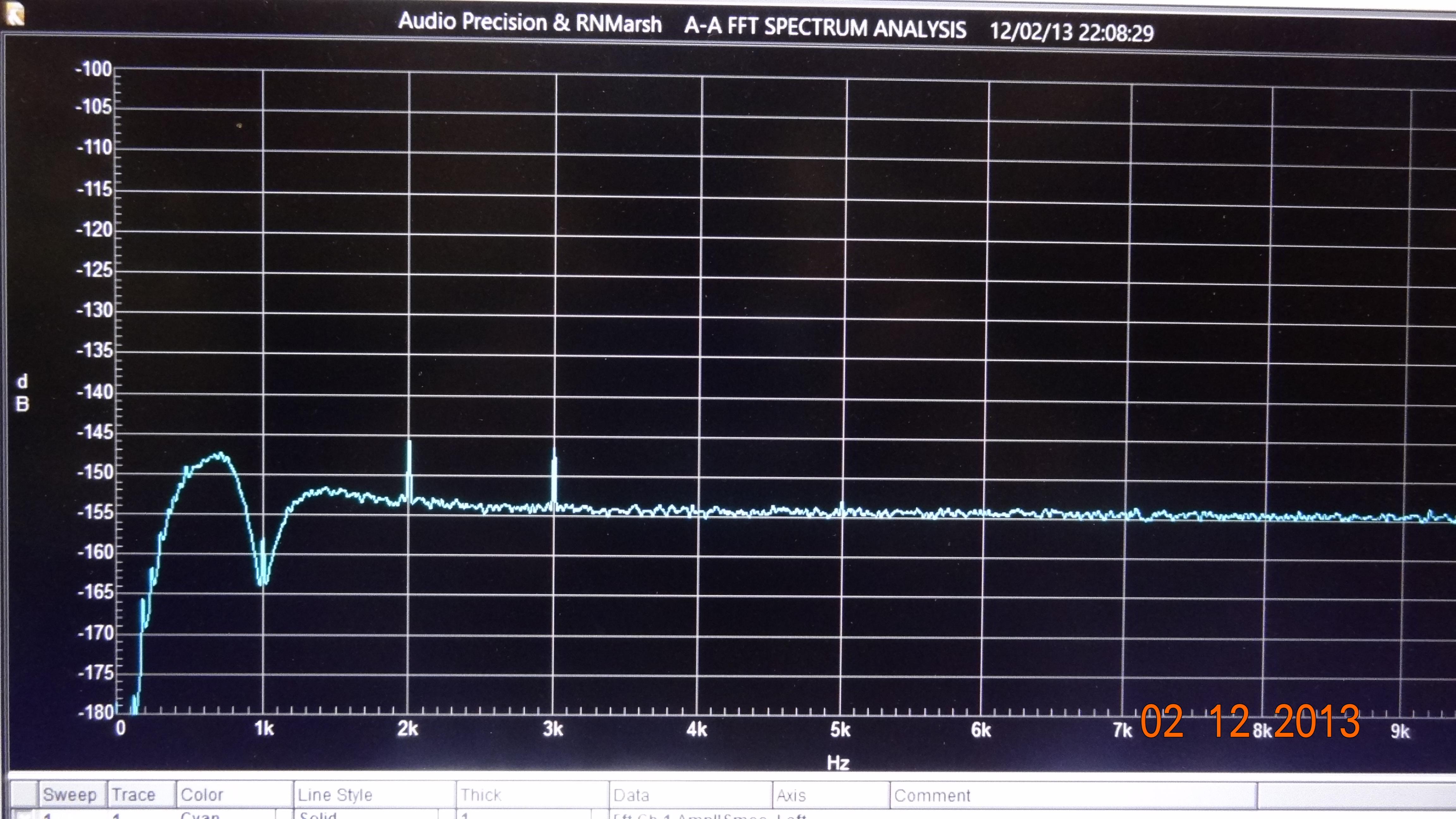

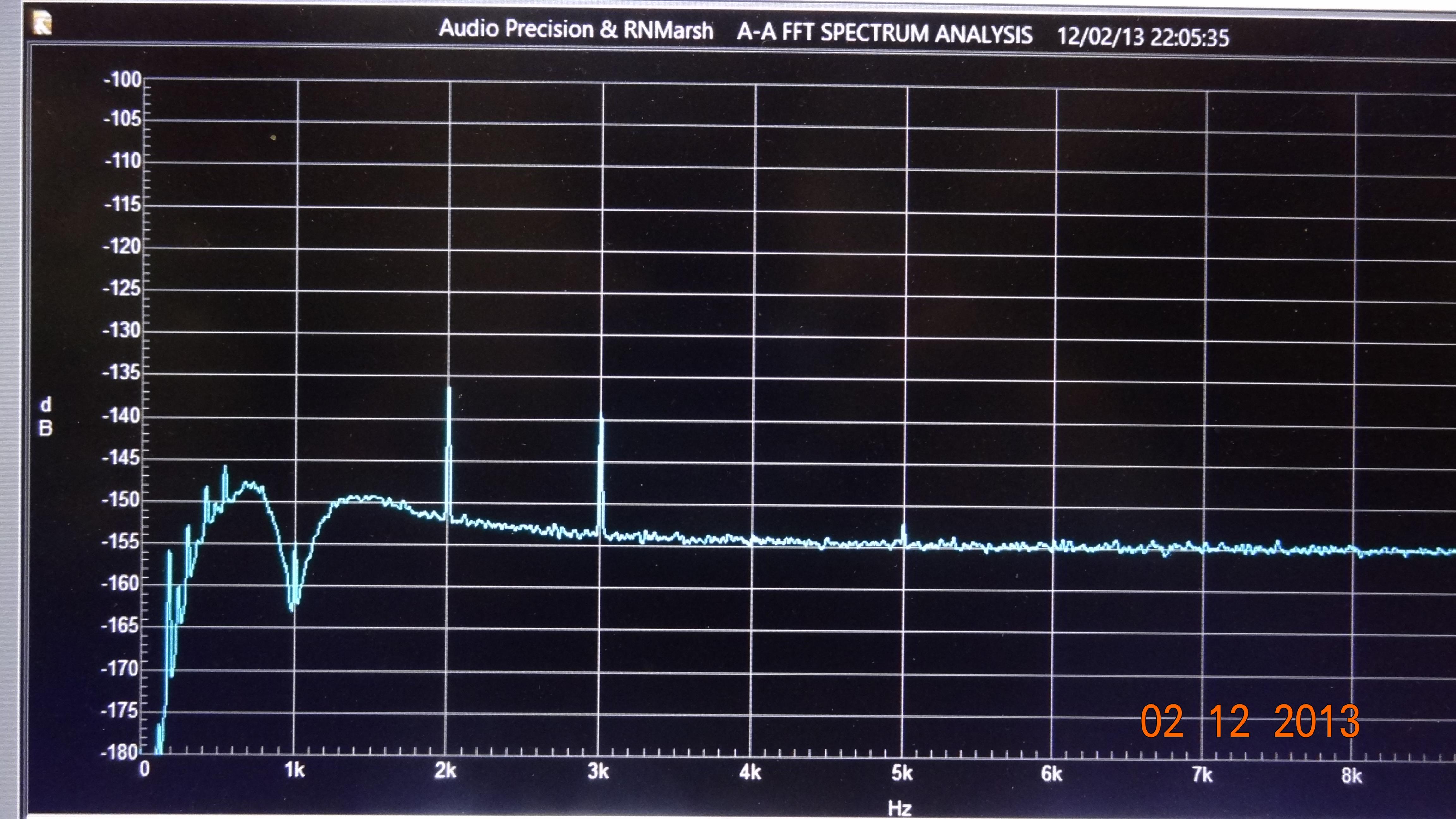

The A-P now is working well thanks to some much needed user experience to help speed me up to par from Samuel G...... The internal gen/analyzer shows 2H and 3h at -145dB. Using the 339A generator as an external source, the A-P and the ShibaSoku AD725D are within 1dB of each other when measuring 2H or 3h to -130dB at least. I have not checked at lower harmonics levels, yet.
Thanks to the loan of the manuals with schematics of the Panasonic models from Stellavox ..... I have a good idea of what to do to reduce the 2H on my VP-7722A. The osc has a 2H trim adjust 🙂 The Panasonic is accurate compared with the A-P 2722 and the ShibaSoku AD725D down to -120dB. useable to -125dB. But the 2H dominates from its internal signal gen .... If I can tune/trim the 2H down to it's 3H level (-130dB) this will be a quick and easy instrument to use to measure THD and THD+N and Individual Harmonics to 5H (and does IM tests, too).
Thx-RNMarsh
