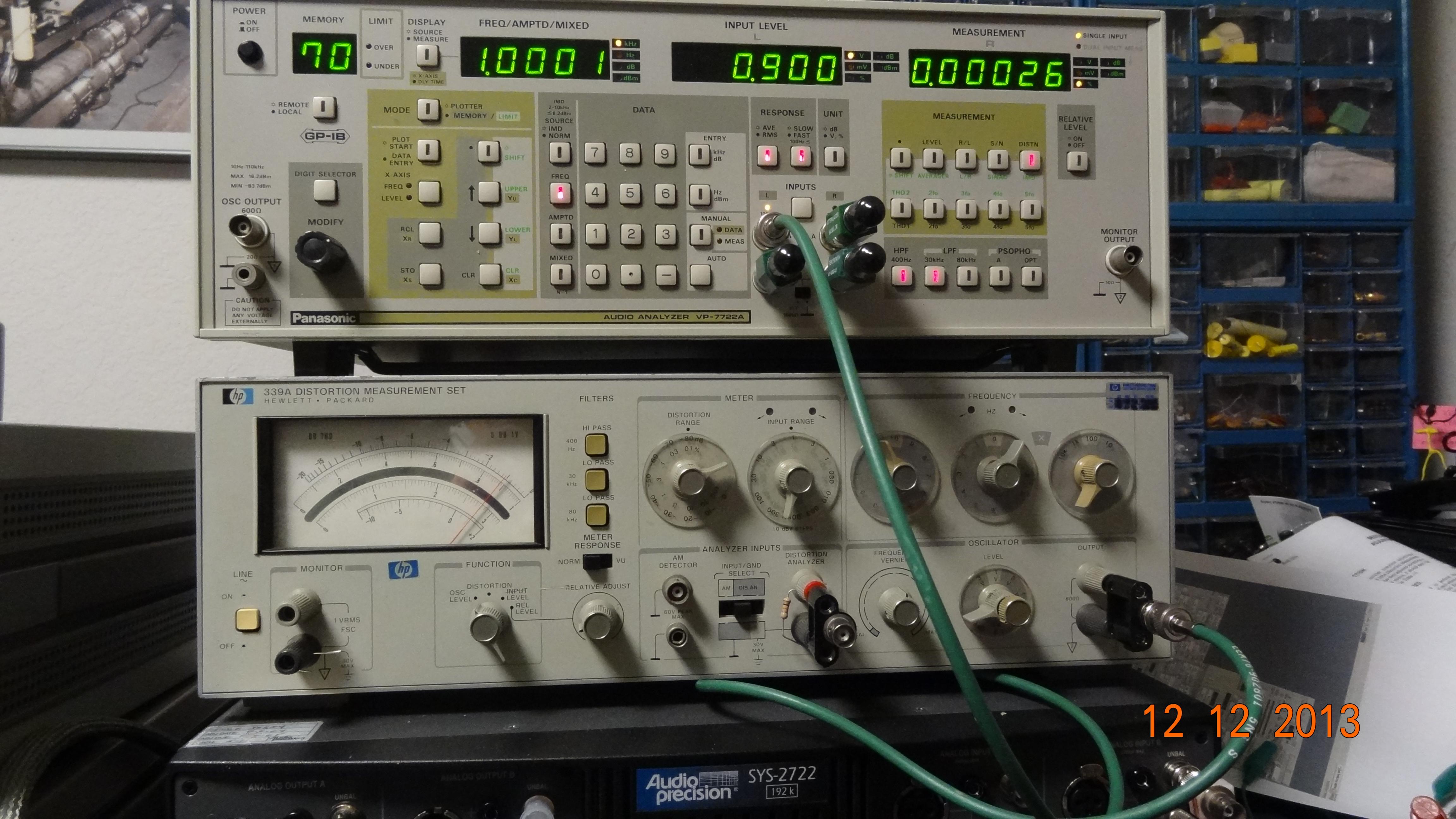

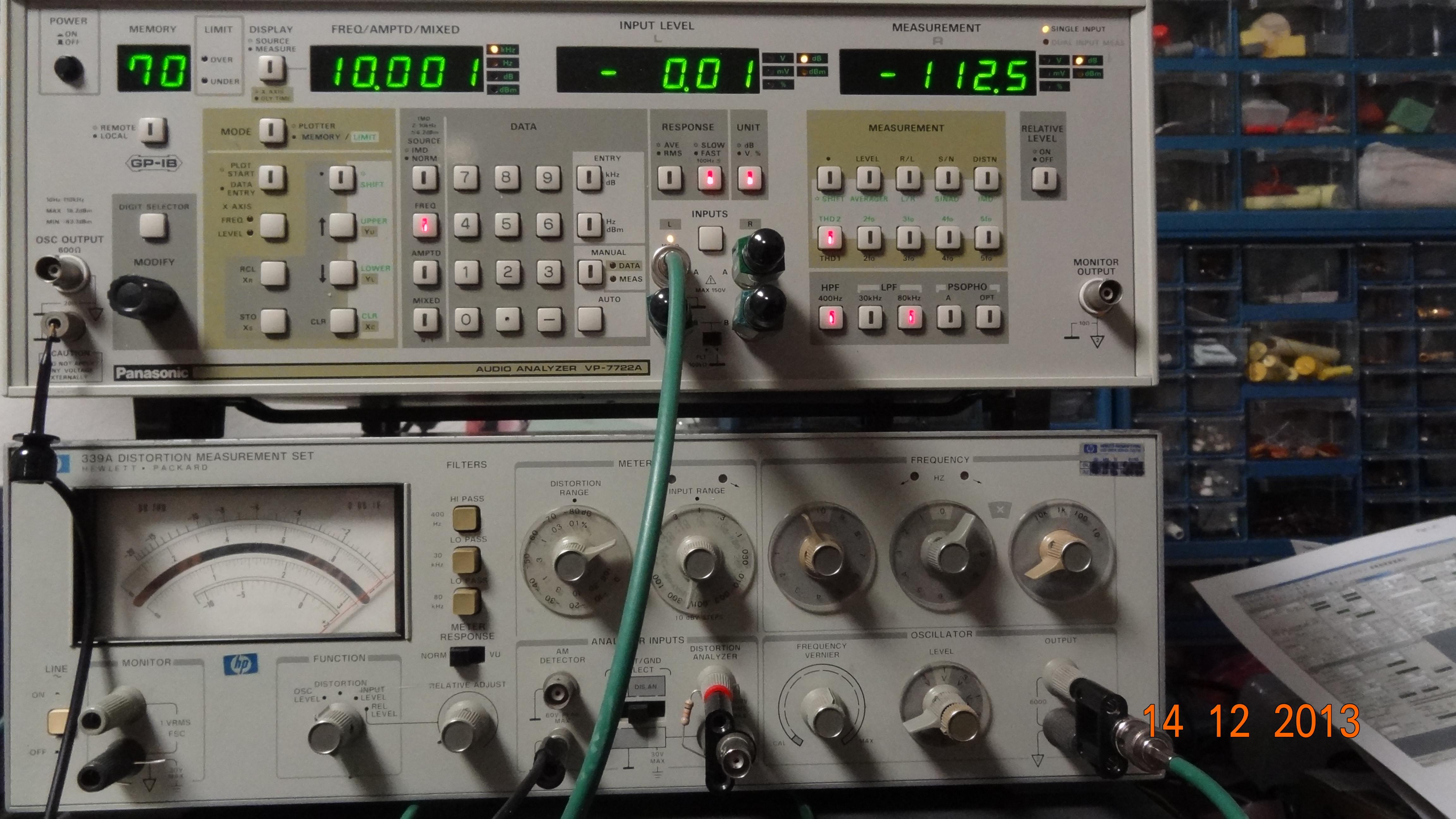

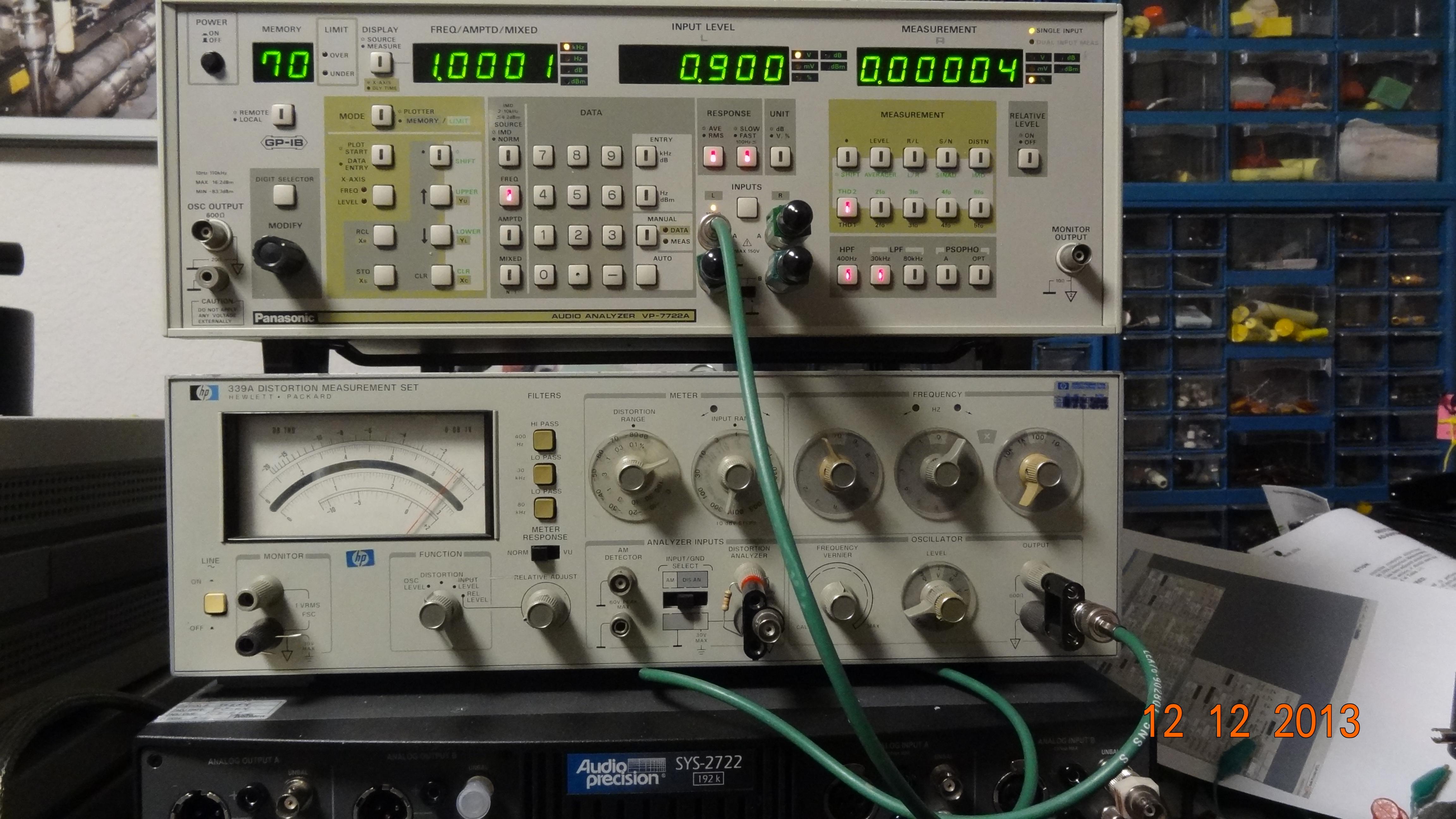

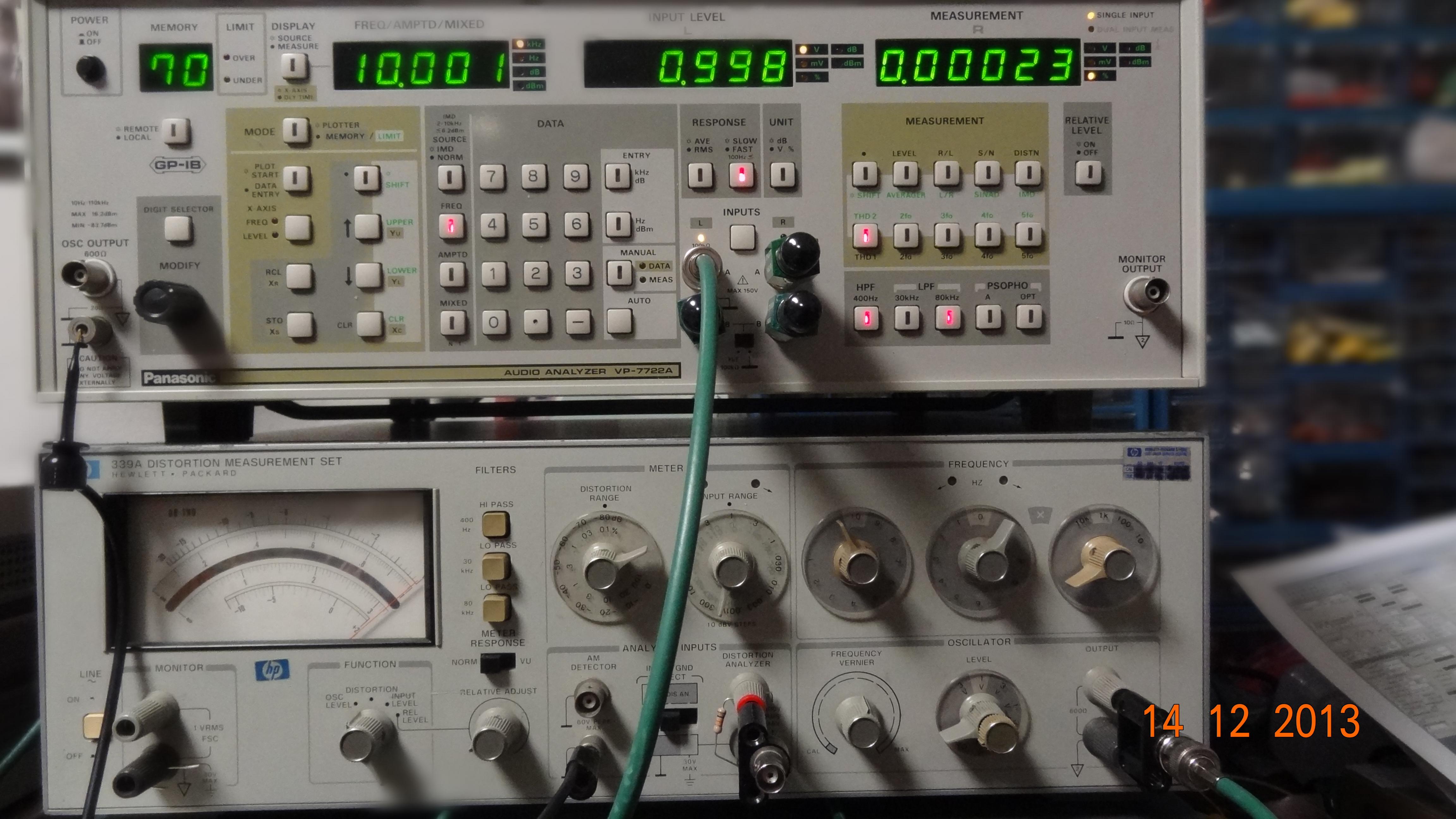

Here's my tuned up HP-339A oscillator; THD+N and THD [1v rms/1KHz]
[click on picture and then zoom in]
Thx-RNMarsh
Disabled Account
Joined 2012
Richard which osc IC does that HP have in it? Also what is H3 at 1K?
LT1468. 3H is lower than 2H in distortion. [To some degree this is variable by tuning values in the circuit.]
Note: All the IC opamps I tried are sensitive to the Z of the circuit values.... the THD distortion changes - with same freq. and increased or decreased Z. This test was at lower Z values of the X100 range and X10 freq = 1KHz. If you change the range to X1K and X1 = 1KHz the distortion is slightly higher.
-THx RNMarsh
