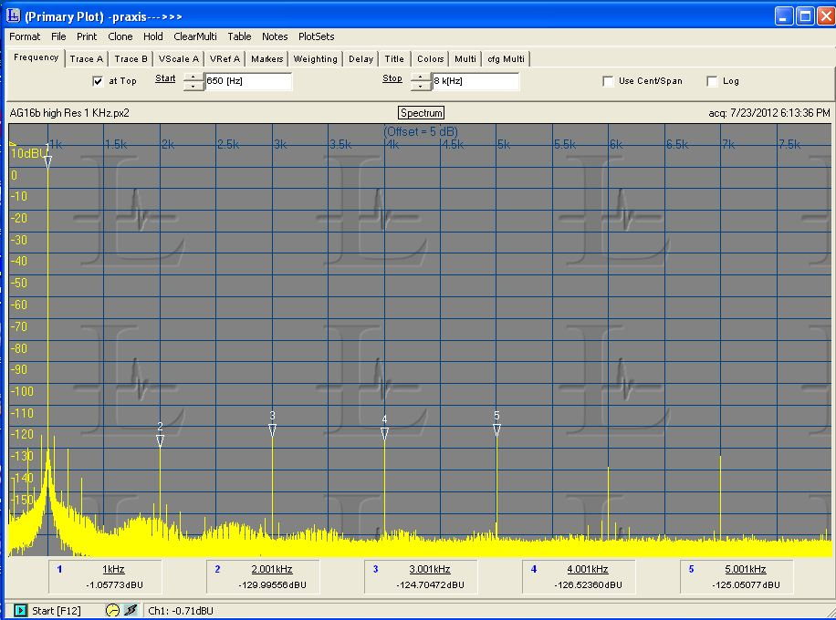

Sam -- the 339A THD (1KHz/.7v) via the 725D. THD (first 5 harmonics) = .000125%
PS -- the A-P THD+N quoted (.0003_%) was via A-P's analog analyzer.
THx - RNMarsh
.000125% of .7 volts would be 8.75 uV The first 5 harmonics would require a bandwidth of at least 5000 hertz. The noise voltage from a 600 ohm resistor at room temperature over a bandwidth of 10,000 hertz would be around 320 nV. So a simple test of using a 600 ohm resistor as the source and seeing what "distortion" is measure would be interesting. Also a check by using a resistive attenuator to lower both the level and the source impedance would be a good double check.
Its a little misleading to compare the "THD" only measurement of the 725D to an AP's THD+N measurement. The 725D samples and effectively measures only the energy at the harmonics in the harmonic analysis mode (see the pictures). It ignores the noise. It would probably read about the same as the AP when measuring the same way. On an AP measuring at such low levels the measurement noise floor is probably limited by the input devices and input attenuator/protection circuits. I believe that the lower limit on a AP2722 is around -115 dB THD+N in whatever the minimum bandwidth is. The 725D's input noise is around 5 nV/rtHz. Measurements in the area below -100 dB are nice but not really useful unless you are preparing marketing material. You need to look at the real harmonic distribution to see what is actually happening. The importance of any of this stuff below -100 dB is a separate and somewhat philosophical discussion.

Here is another view of the data with a 339A source and A-P 2722 and a notch of 60dB via B&K 1607 in 'active' notch filter mode. Even more accurate, of course, but still showing well under -130dB for 2H and 3H. Guess I found the answer to the source of the high 3H. This has got to be near the AP's 24 bit limit. The 725 can go lower with accuracy but can not do IM and mulit-tone et al that the A-P can.
Thx-RNMarsh
The blue data is just a calib level of 1 volt, the yellow data is the measurement;

The test was primarily redone with just averaging applied to drop the noise from the graph. The 2722 system setup is as A-P tech support advised...
