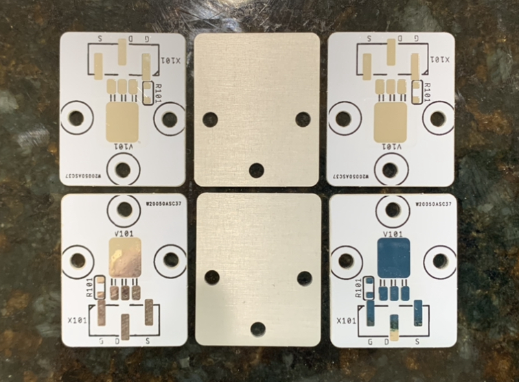

Good news folks, the first batch of verification IMS aluminum LU1014D TO-247 adapter PCBs arrived today. They look great. They would look better in ENIG but I didn’t want to splurge for that on verification build parts. I am waiting for the Samtec 0.20in pitch 3-pin SMT header pins to arrive from Samtec and can start assembling them. I have the matched LU1014D’s from Woofertester already.
Front and back side:

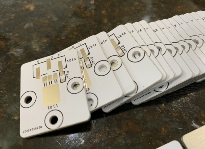

Stack of 25 boards:

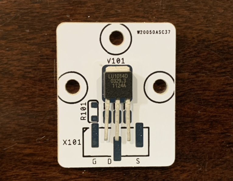

Here is one of the LU1014D’s that Woofertester sent me placed on top to show fit and size of the adapters:
As you can see, it’s going to take a little manual cutting and bending of the legs to get them to lie flush with the pads before surface mount reflow soldering.
Stack of 25 boards:
Stack of 25 boards:
Looking good. Great work.
