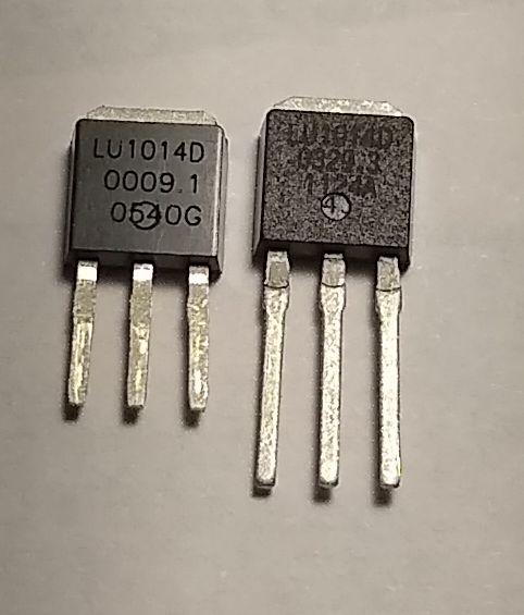

The parts from Mr. Pass have arrived. We will order aluminum adapters and test them with some parts from my stash just in case some parts are destroyed in the process.
I will start characterizing and sorting parts from the Pass stash.
My guess is that some time in June we will open up the group buy. In the meantime, I will post results as I have them. Sorting some stragglers from my stash as well as breaking in a new instrument. Stay tuned.
Factory original device from Pass stash on the left. eBay device on the right.

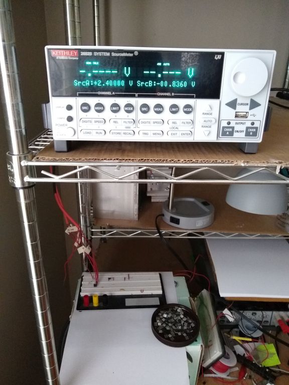

Curve Tracer hardware
Here is the hardware. 4-wire Kelvin on D-S connection. 2-wire connection on the G-S connection. Running a script that I wrote. Found another bug in the script this morning as I was working on the first Pass Stash device. With this bug eliminated, I now get very good repeatability; much better than 1%.
Any Python gurus in the community? I would like to use a thermal receipt printer to print out each device's parameters while I am calling my characterization script.
